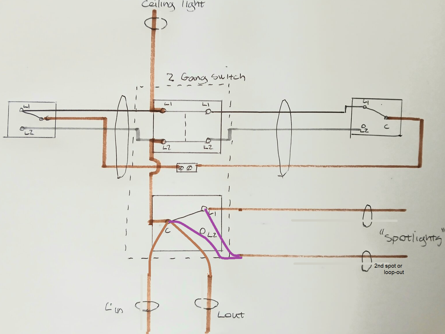

My initial thought was something like this, I've deliberately shown the 3C&E in red to avoid it being taken as colours advice
However that doesn't take into acount the number of neutrals (yes I had seen 5 but my bad editing of 3 was supposed to refer to the browns in the other connector) or the 'turning the kitchen light on and off'.

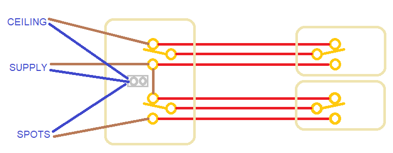

THIS would:
Neutrals and earths not shown

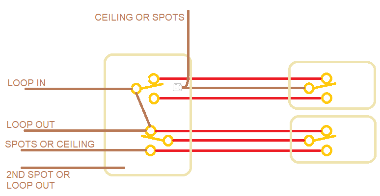

RG's idea works well (please excuse my editing):
The problem is too many variables without some form of testing, we don't even know at this time which wires in the photos are in each 3C&E.
