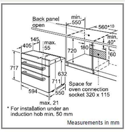

Help re tech diagram for built-under double oven

My GUESS is that the width can be up to 10mm more than 560mm but nothing less than 560mm.
That guess is correct.
Avoiding all of the measurements, the oven will fit into a standard 600mm oven housing, as found in the majority of kitchens.

I don't get the +10 bit -
is this air gap?
No
Basically, how big a gap do I need?
Between 460mm and 470mm, so the appliance can be fitted, anything smaller, it will not get in, anything larger and the fixing screws will not secure to the housing side panels and you will also have a nasty looking gap at the edges of the oven door or if excessively large, the oven will just slide straight back to the wall.
It will be designed for a 600mm wide cabinet (hence being slightly narrower on the front, so it doesn't hit cupboards of drawers next to it), so when you deduct the 2x 18mm side panels of the cabinet, you get 564mm - perfect. Or if you have a super cheapy kitchen the cabinets may only have 15mm panels, so the gap would be 570mm - still acceptable for the oven.
