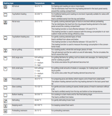

The manual indicates it has two elements and a fan which can be on at the same time.
Therefore I would not have it supplied through a 13A fuse in either a plug or an FCU.
It says it needs a 16A supply (for operation).
That's not the same as saying it needs a 16A MCB - which it does not - that depends on the cable characteristics so it follows that it does not need a 13A fuse either.
So, to be controversial, if it is thought that it could be supplied through a plug or FCU on the ring circuit then it could be connected directly to the ring circuit through a 20A switch - if fault current compliant and notwithstanding Appendix 15 informative advice.
This would negate any overheating worries in a plug or FCU

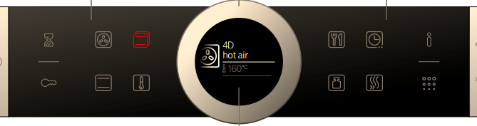

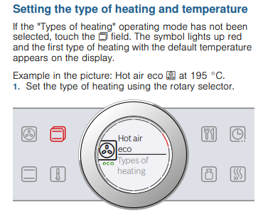

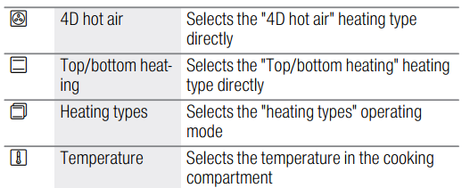

Maybe I'm missing it, but I'm not convinced about that (that they can be on at the same time). Although you quite probably can't read the below, it indicates what I'm looking at - and which of the 'Cooking Types' selectable do you think involves both elements being on? (I think the 'touch controls' you have illustrated are just quick ways of getting to a couple of the cooking modes (without using the menu), but not necessarily at the same time ..
Kind Regards, John
What about the red icon being on?
I think that merely means that one has pressed that icon to select the "Types of heating" mode, which then anables one to select one of the various heating modes by "using the rotary selector" (to chose one of those modes which was in the list I previously posted). I still can't find any of those modes which involves "top/boittom" and "hot air" being on at the same time, can you? ....
Kind Regards, John
Yes, but I'm considering the heat 'emitted from top and bottom' as being a single element (even if it is physically two). I thought you were distinguishing between that/those and the 'other' (second or third) element - the 'ring-shaped element in the back panel' which is used for hot air heating (but, as far as I can make out, never simultaneously with the other element(s)
Kind Regards, John
Ah, I didn't realise there was an element round the fan.
That means there are three elements so, almost certainly, they will not be able to all be on together.
Whether that reduces the 3.6kW, is still not certain.
Ah, I didn't realise there was an element round the fan. That means there are three elements so, almost certainly, they will not be able to all be on together. Whether that reduces the 3.6kW, is still not certain.
Indeed - that's the uncertainty. However, one can but presume that the 3.6kW represents the maximum it can be in any 'mode' - otherwise it wouldn't make much sense?
You're probably right that the 'top and bottom' heating will involve two separate elements (in which case the question will arise as to whether they have common, or separate, thermostatic control) but that it perhaps not inevitable. Very many moons ago I had an oven (the only electric oven I've ever owned - I have a feeling that it was a Moffat) which had a single element which wound around all over the place (top and bottom) - which I learned to my cost when I had to replace it!
