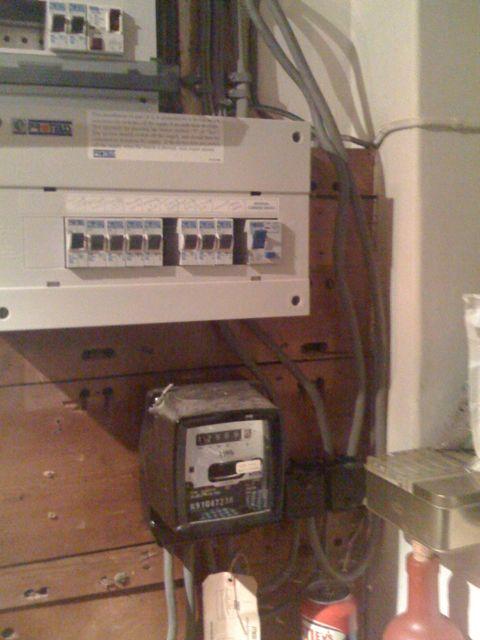

It would be interesting to see a photo of your meter, consumer unit(s), incoming supply and company fuse, and the various cables between them.

i have taken some photos and will try to upload them

I have taken some shots and uploaded them but cant seem to point to the gallery......
you link photos by copy and paste the "DIYnot BBCode" which looks like
[net]105406/3768_89923731.jpg[/net]
and it will show
