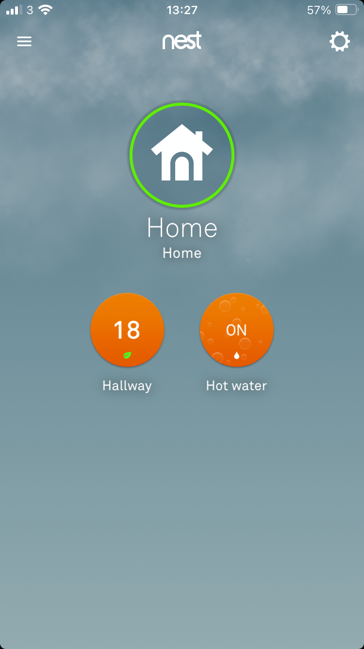

The hot water failed to come on this morning.
Just now, at 0730 I turned the heating off and boosted the hot water from the Nest App and it’s still on 7 minutes later, just the same as yesterday and the day before.
The motor seems to work normally the second time of asking???
Ray

Our Nest schedule never has CH & HW on together.
Last action was CH on then off this morning.
Went into loft with Nest App
CH on for a few minutes - turned off - waited 3 mins for afterrun to stop each time.
HW on for a few minutes - could hear the valve action - turned off
CH on - could hear the valve action - HW on at the same time - valve action heard.
On test it seemed to work exactly as it should. I expect if I leave it the HW will fail to start at 6am tomorrow.
I had thought about setting it for 0530 for 30 mins then 0600 - 0700 to see if it would start at the second attempt?
Ray

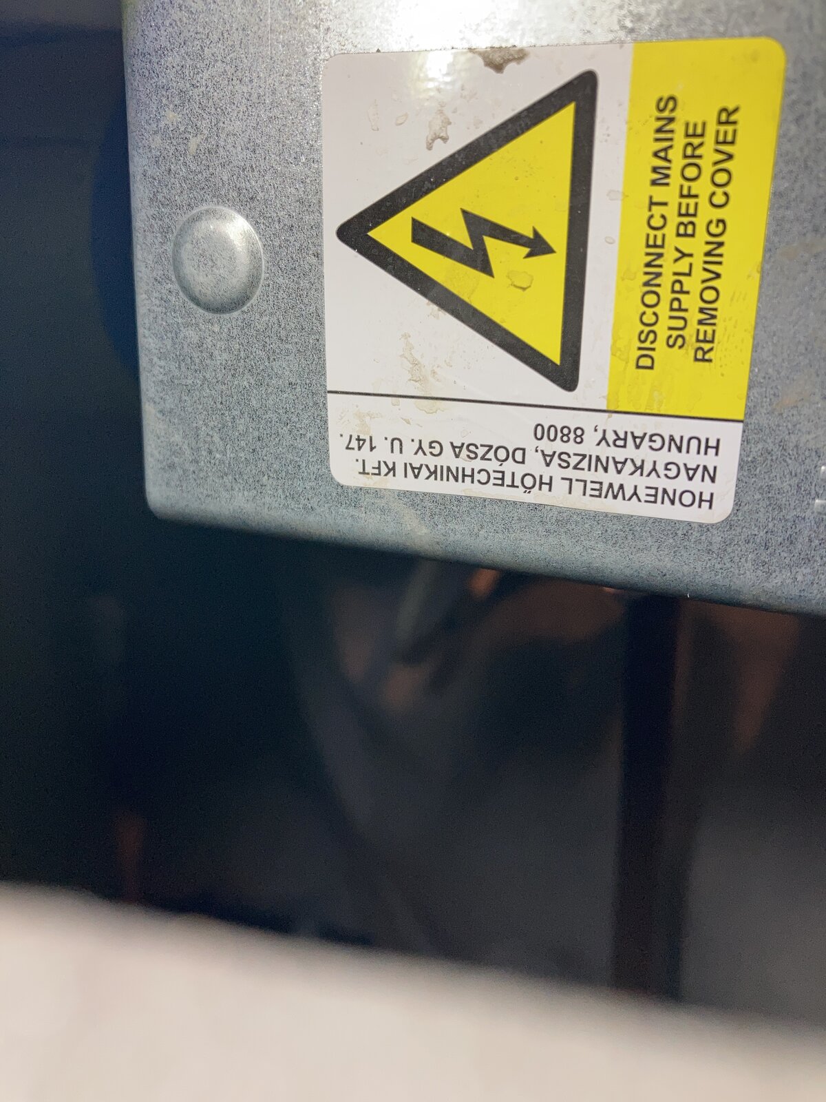

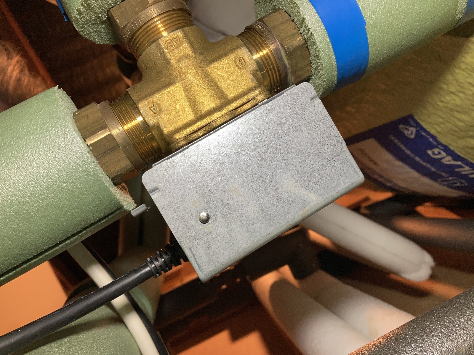

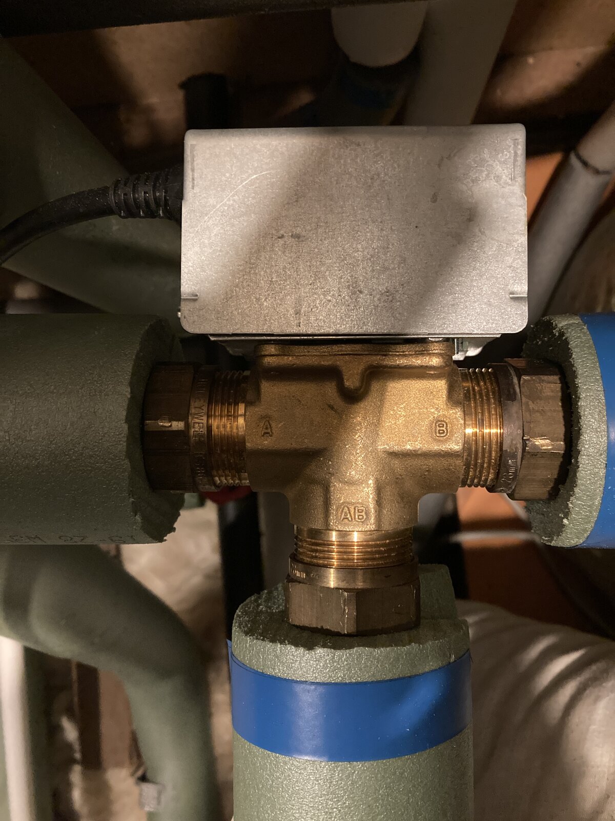

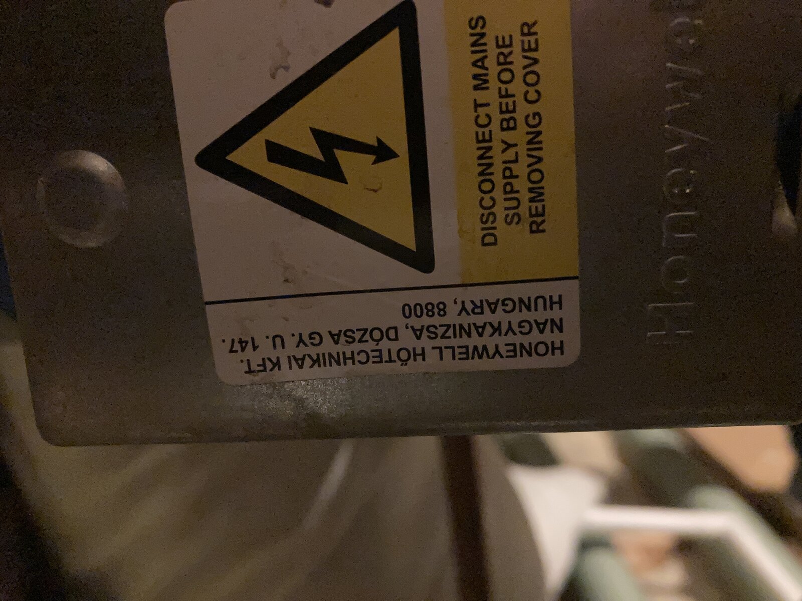

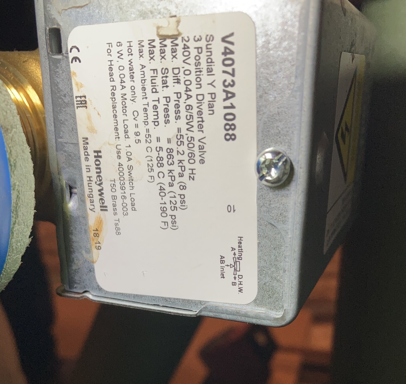

Can you check the Honeywell valve number, you might have a Diverter Valve and not a mid position valve.

Before checking I was convinced it would be a mid position valve if that’s the type allowing CH & HW to be on together, but it says it’s a diverter !!!
Are we being disadvantaged by it ?
It should allow heating and hot water to be on together,or independently of each other in a Y plan system. Judging by the info in your original post ,that's what you have historically had ,and your recent issue is a deviation of that isn't it ?

My question was ,did the system work fine with the valve you have ,until recently ? If it did ,and nothing has been altered to the systems controls or wiring,replace the complete valve.
If you are have the CH programmed on and roomstat calling (CH on) and the programmer then calls for HW then the valve will only change over to HW if the cylinder stat is calling as well, its HW priority, not sure if your cylinder stat is calling for heat in the morning but imagine it is from your description of events.
It says in the attached that port A is the HW port, the HW port on a MPV is B, so just check which ports are which on yours in case someone (unlikely) changed the MPV to a diverter valve in 2019.
