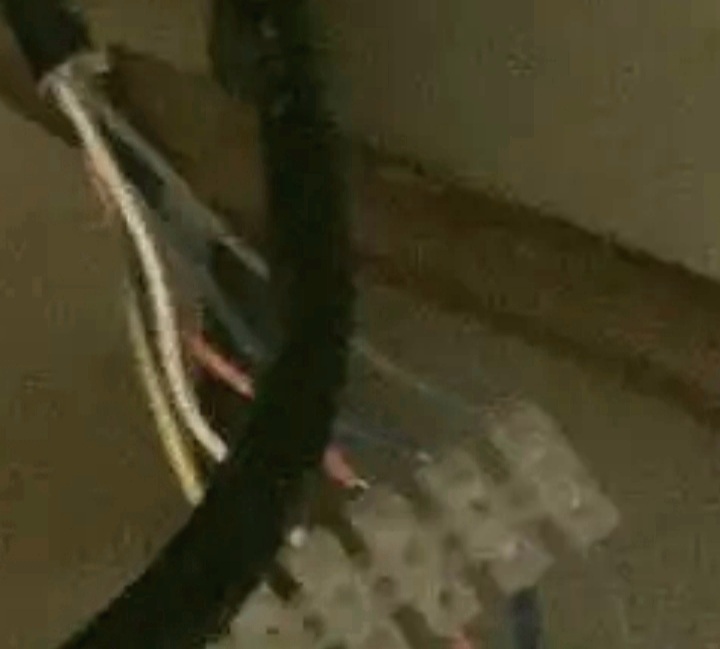

1. the black wire is in a loop, it is just for the motorised valve

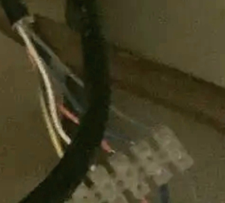

That terminal block needs to be placed into a proper enclosure including strain relief for the cables.
An exposed terminal block, mains voltages, plenty of bare copper showing on the wires, along with the proximity to water and pipework, really isn't a good combination...
