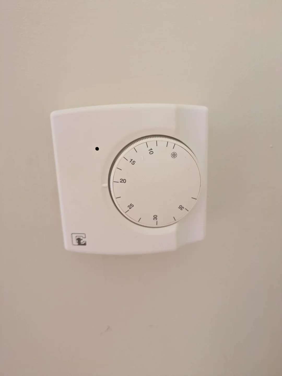

Hi,

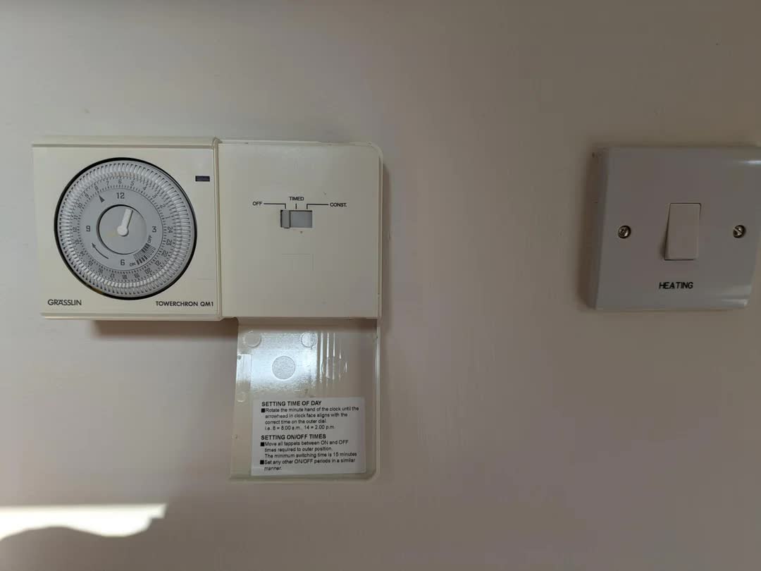

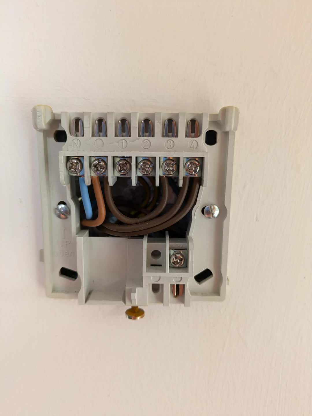

I live in the UK (Belfast) recently bought a 3 Bed house house with two floors 0 and 1. It has Glowworm Easicom 28c boiler fitted in the utility There is a programmable timer with a switch in the utility, There are two wired rotary thermostats fitted in the hallways of the two floors. There is a motorised port valve underneath the boiler.
I want to understand if this is a multi-zoned heating system and the two thermostats control the heating on the two floors separately. The timer on the boiler is always switched off even then the heating continues when the heating switch is turned on at the other program timer.
I want to replace the program timer and the rotary thermostats with smart ones (Nest, Tado, Hive...) which smart one would be suitable with this setup and do i also need Smart TRVs which gets linked with the smart thermostats.
Will i be able to do it my self or do i need an engineer. How easy/difficult would it be.
Any help appreciated. Thanks

Thermostat (same on both floors):

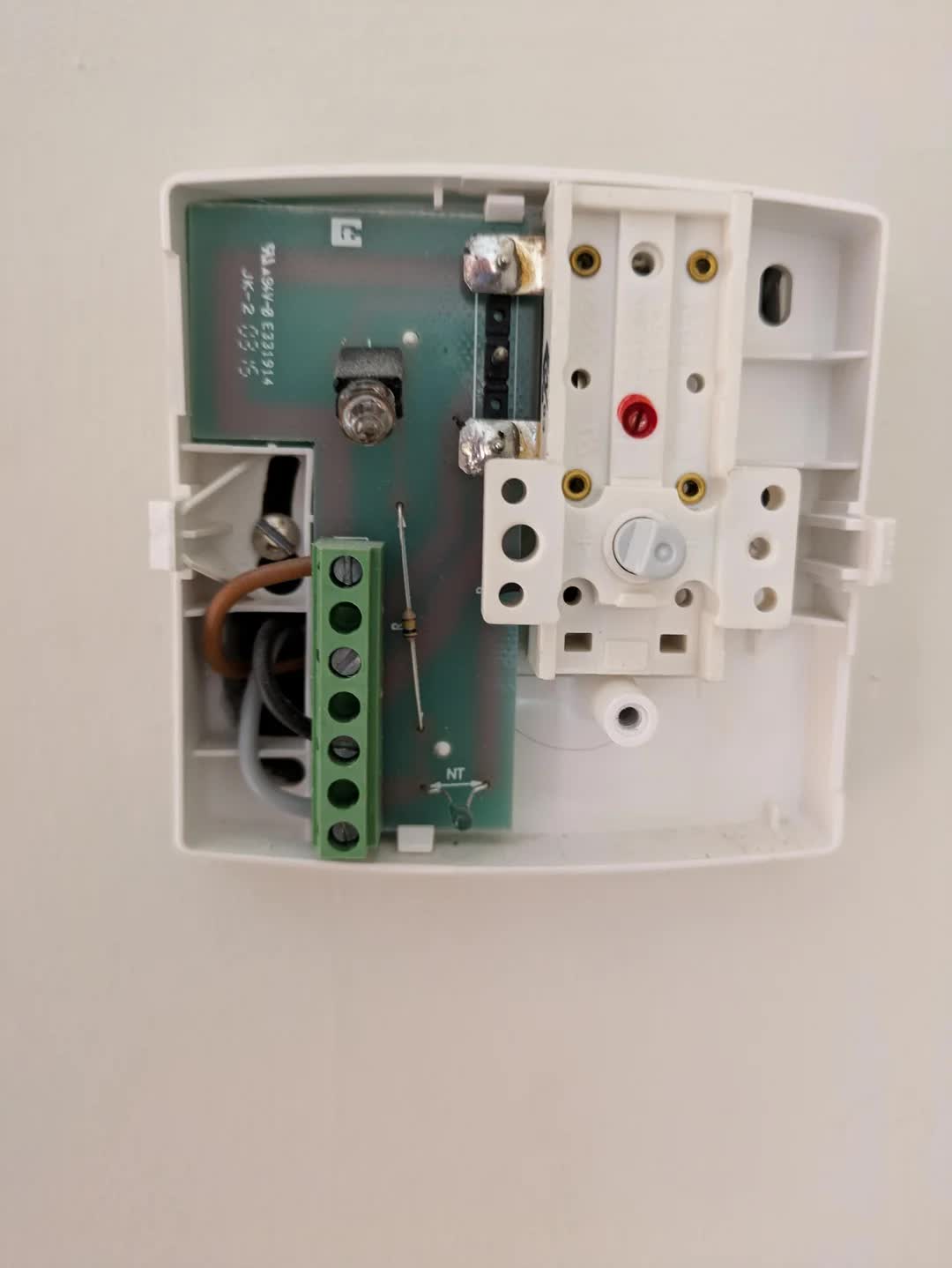

Thermostat wiring:

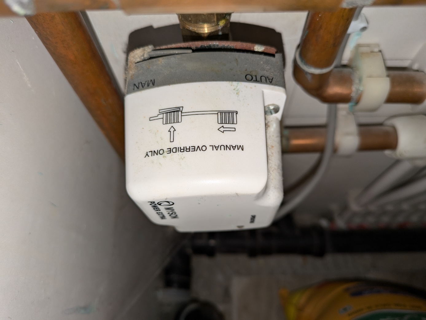

If it was multi zoned then there would normally need to be a separate zone valve and flow pipework to each floor
The fact that there are 2 stats would suggest it is, but you would need to find that other zone valve and the upstairs pipework. Can you post a pic of the valve that's under the boiler?
The programmer has 2 SL out, presumably heading to each stat, the stats will then switch back to each zone valve and from there back to the boiler. The programmer on the boiler will probably have been bypassed.

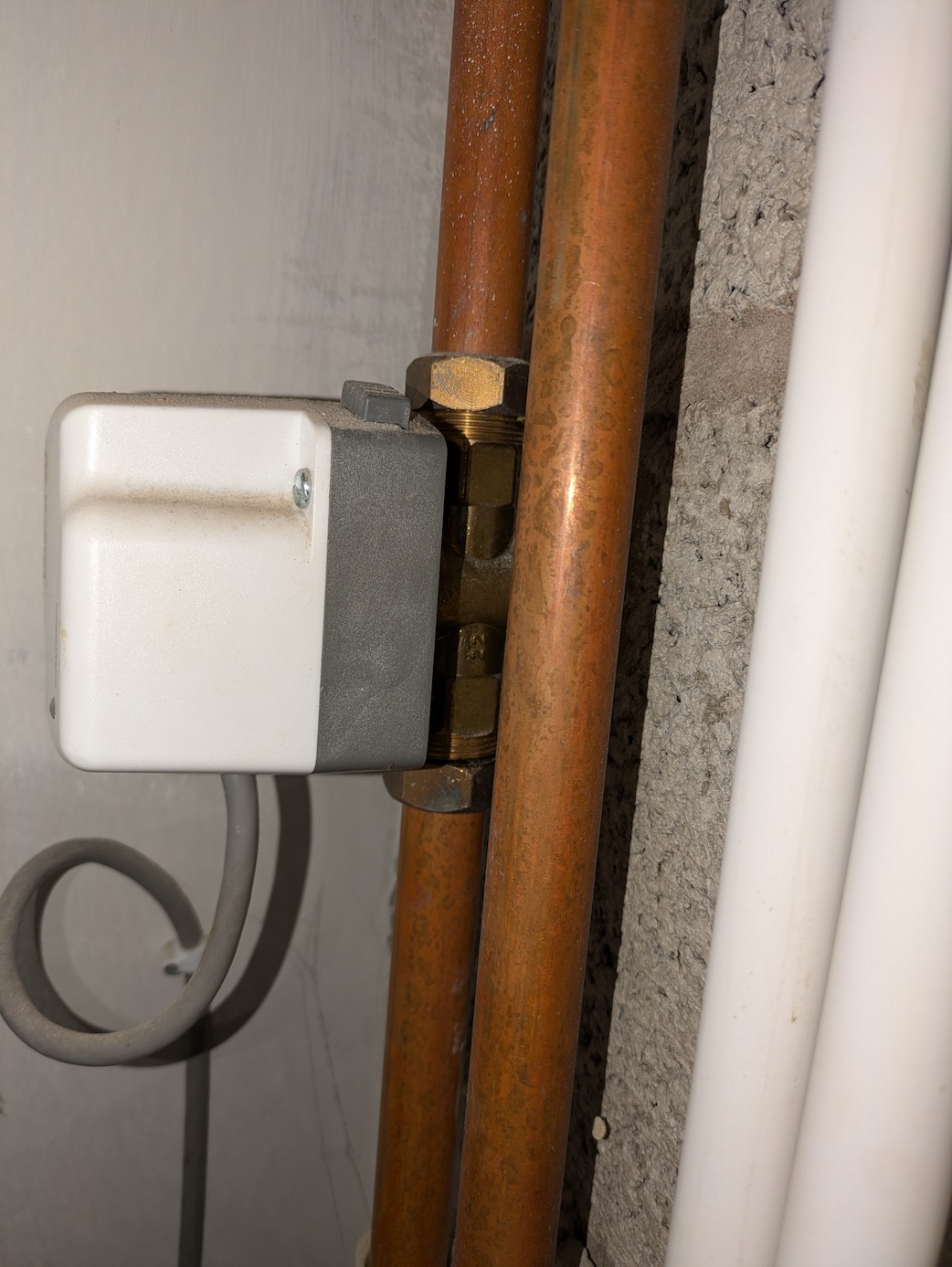

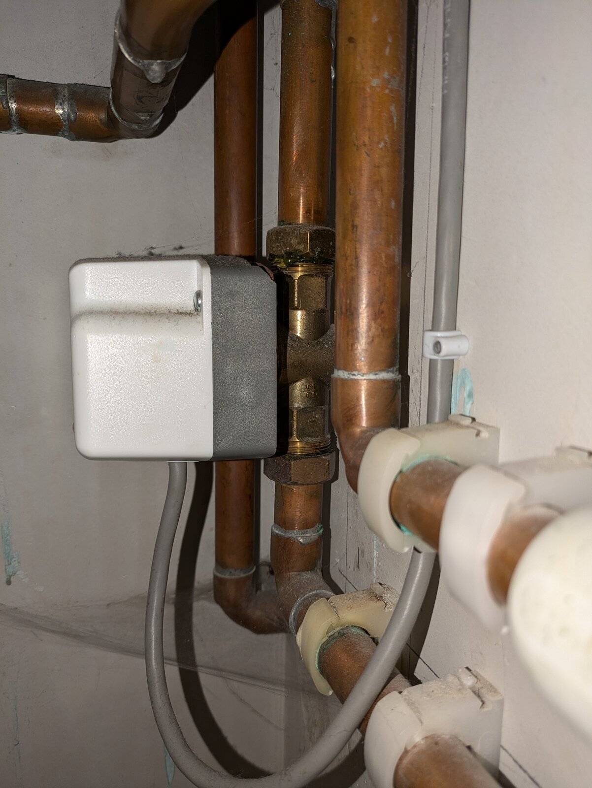

I found there are two zone valves one under the boiler (boiler is on a counter) and one hiding between boiler and the wall which i couldn't see until i climbed on the counter :giggle:
Under boiler:
Beside boiler:
OK - so the flow pipe from the boiler will split into 2 and then each will head into its own 2 port valve so yes you have an multi zone.

Alternatively, if you are happy with their current position, your existing stats have a neutral wire connected.
This allows you to replace them with any number of mains/battery powered stats
e.g. wired Tado.
You would then set the programmer to permanently on, or bridge it out (i.e. move the brown wire in terminal 3, to terminal 4, on the backplate); allowing your new stats to fully take control.

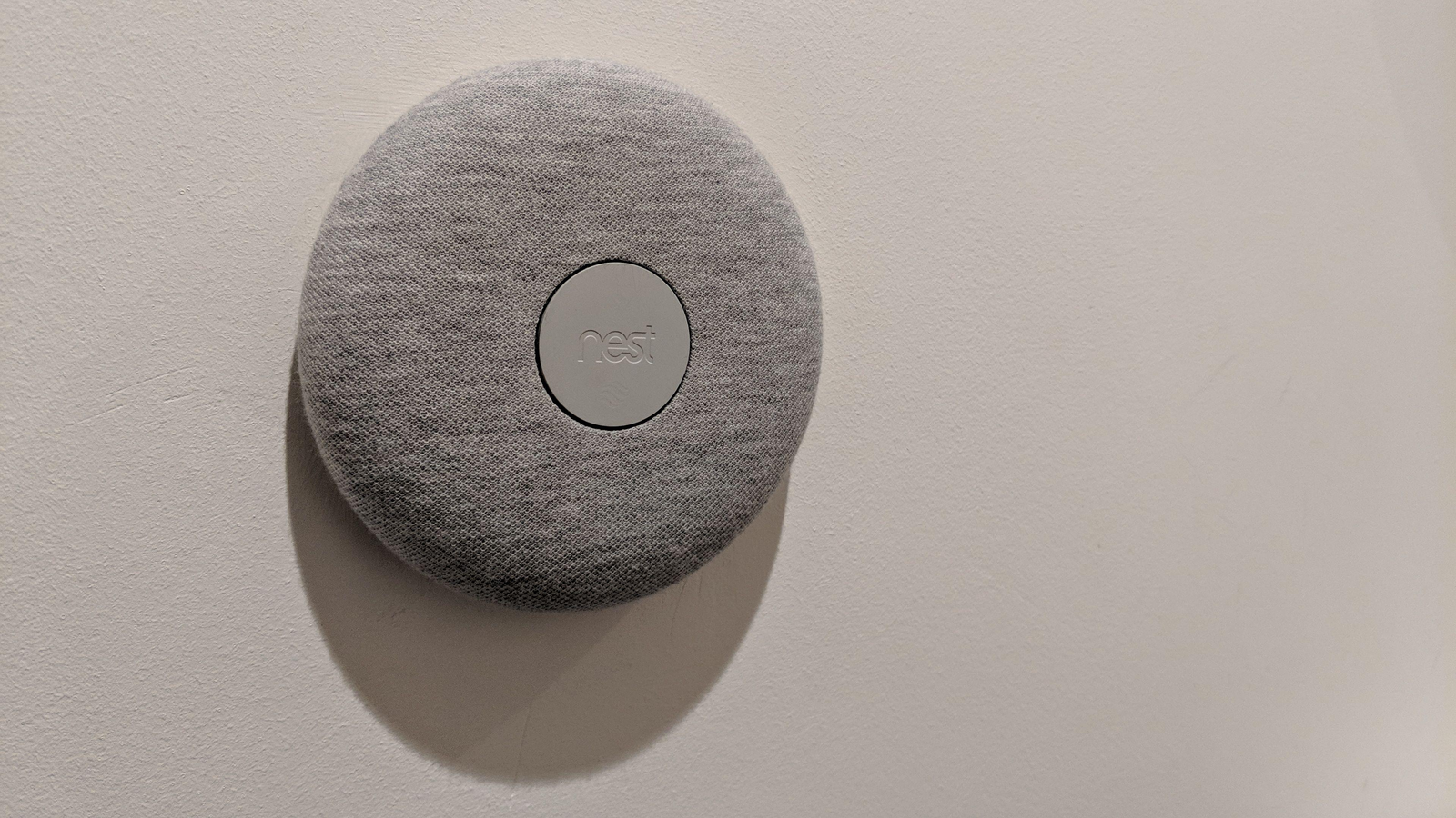

Another option with Nest, would be to mount the two Heatlinks near to the existing programmer, and attempt to reutilise the wiring going to the old stats to provide the 12V to power the Nest thermostat through the T1 and T2 terminals.

For a very straightforward solution, have a look at the Tado wired...
It supports multi zone and Tados smart TRVs.
They are battery powered stats that would be mounted where your existing stats are.
The Brown and Black wires in your existing stats terminals 1 and 3, would simply be connected to the Tados NO and COM terminals.
The grey wire currently in terminal 4, would need to be safely isolated in a separate terminal block.
And that's it, apart from turning your existing programmer to permanently on, or...

That leaves an ugly receiver on the wall rather than an aesthetic stat, i.e. the Nest Thermostat E, would be an extremely simple install, but it leaves a Heatlink on the wall...

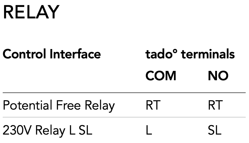

@RandomGrinch i have decided to go with Tado X to take advantage of matter and thread (if i buy more thread devices can use them to automate stuff) and now it is available in UK for £60 more for the starter kit.
Now regarding wiring did you mean respectively about the colours and the terminals into tado?
As per the Tado's instructions L -> COM and SL -> NO and on my setup Brown (1) is the Live wire (checked with a mains tester) and Black (3) is SL i suppose.
Could you please help me understand.
