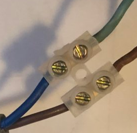

Help wiring extractor hood
He meant the screws in the connector blocks.
Are you using - putting the fuse in - the correct FCU?
Oh ok. Yes screws in the connectors are sitting fine and touching the copper wiring.
Well the 13a was fine and I swapped the dead 3a for a 5a, so technically they’re both fine if that’s what you mean?
Coco,
Apologises. When I said check the screws I meant at the termination block between the old wire and the new hood wire. This was in case the wires inside the termination black were not properly connecting to metal (all it needs is one wire ):
Hey, yes I checked as I’ve had this problem before. The screws were all sitting firmly on the copper wire end and I made sure to tug gently to see that they didn’t fall out
Is it worth wiring the extractor cable into one of the fuse boxes? Feel like I have my work cut out :/
NO! You need a multimeter to check the white cable on blue and brown wires. Supposed to be 230 volts AC although 240 and higher is more common. (mine was 258VAC last I checked). Test using the block you connected up to the extractor as it's safer for you.
If you can not test for yourself, you need to get someone in to test for you. It does not need to be an electrician, just someone with a meter and a clue how to use it !!

The white supply cable coming out the wall has several indentations/ damage to the outer sheath ,as though it has been bent sharply and clamped. Maybe one of the inner conductors is broken.

So I decided to leave off tampering with wires as it just seemed too fiddly (and dangerous). I drilled a hole in the unit instead to pass the power cord through. I reattached the plug i’d initially cut off and also extended the length of the cable so it would reach the nearest socket. Problem solved!
