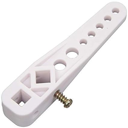

I did wonder if the alignment of the flushing mechanism had something to do with it, as the problem started when I bought a new lever.
The problem I have there is that I am limited by the hole positioning on this thing:
And it seems quite difficult to get the c link moving perfectly vertically.
Maybe I should buy a different one of those ^^ ?
Thanks again for the advice so far
Sounds like you've nailed the source of the problem, look for another one.

Use one of these, infinitely variable positioning and far superior to the plastic crap. https://www.screwfix.com/p/brass-cistern-lever-arm/4912r
This is EXACTLY what I need, if only I had this a few months ago, none of the problems would have started!!
