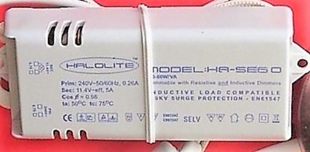

I thought it was called a transformer, they were halolite 20-60w/va model ha-se60. And can confirm completely removed. It is indeed the lamp closest to switch that is not flickering. About to check connections on each fitting.
Have just reconnected every wire on the circuit and noticed that on one of the round junction boxes the live tail was protruding too far and touching its own cable. Anyway, fitted it correctly and all good.
Thank you everyone especially mikeyd

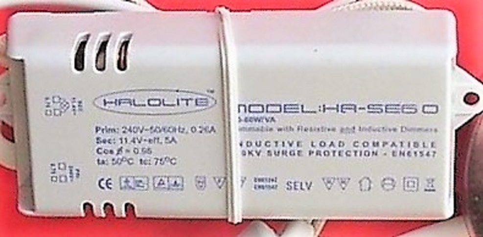

model ha-se60
So, isn't that 11.4v AC output?
