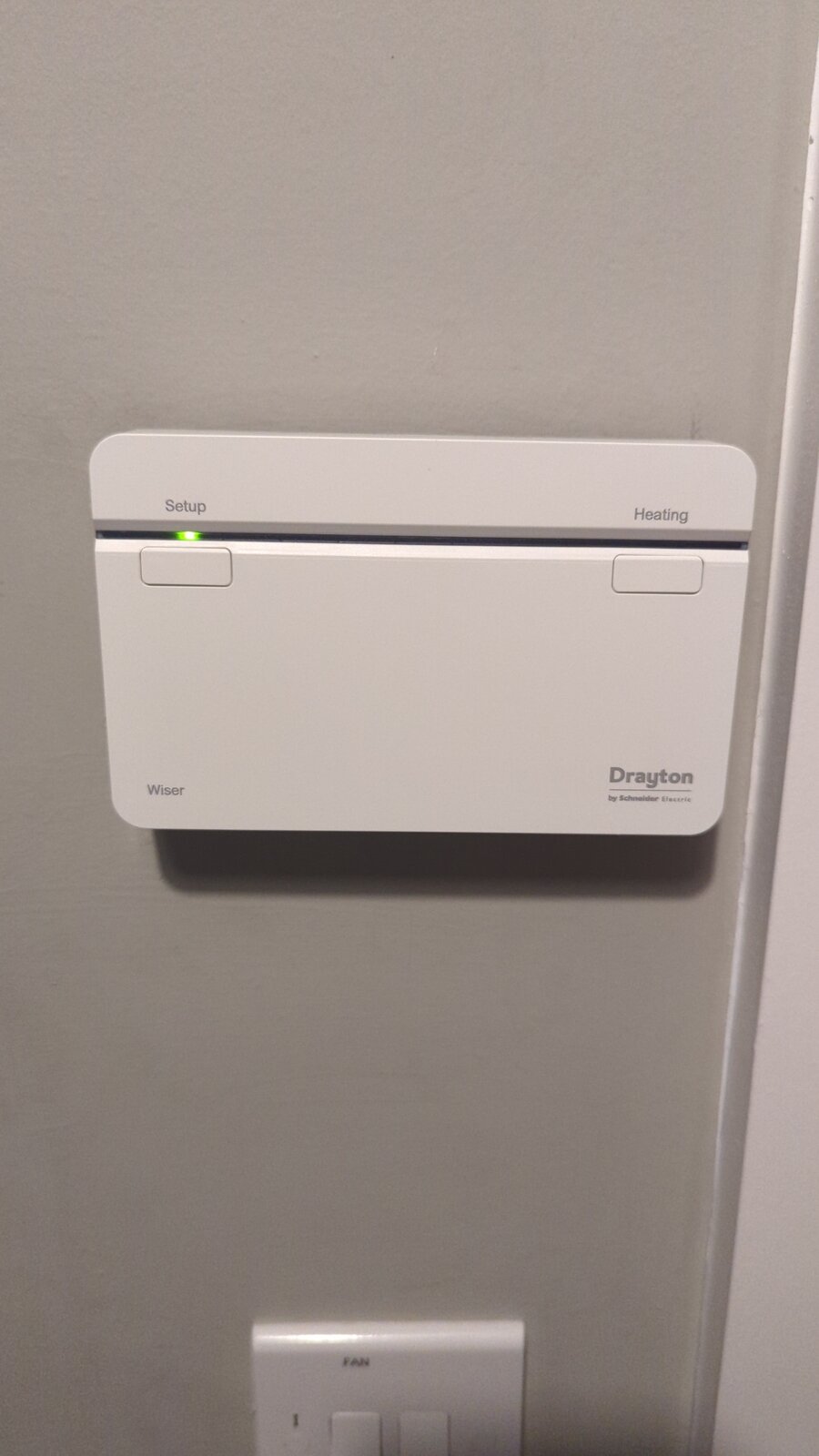

It cycles for a minute then is just permanently on.

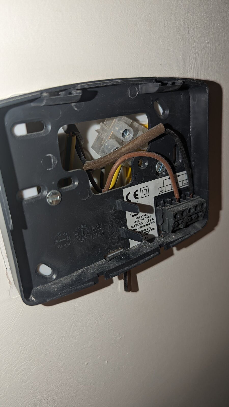

If I get some 4 core cable and just hook into these :
What would be your recommendation on removing the old programmers?
And would that work with the valves in place?

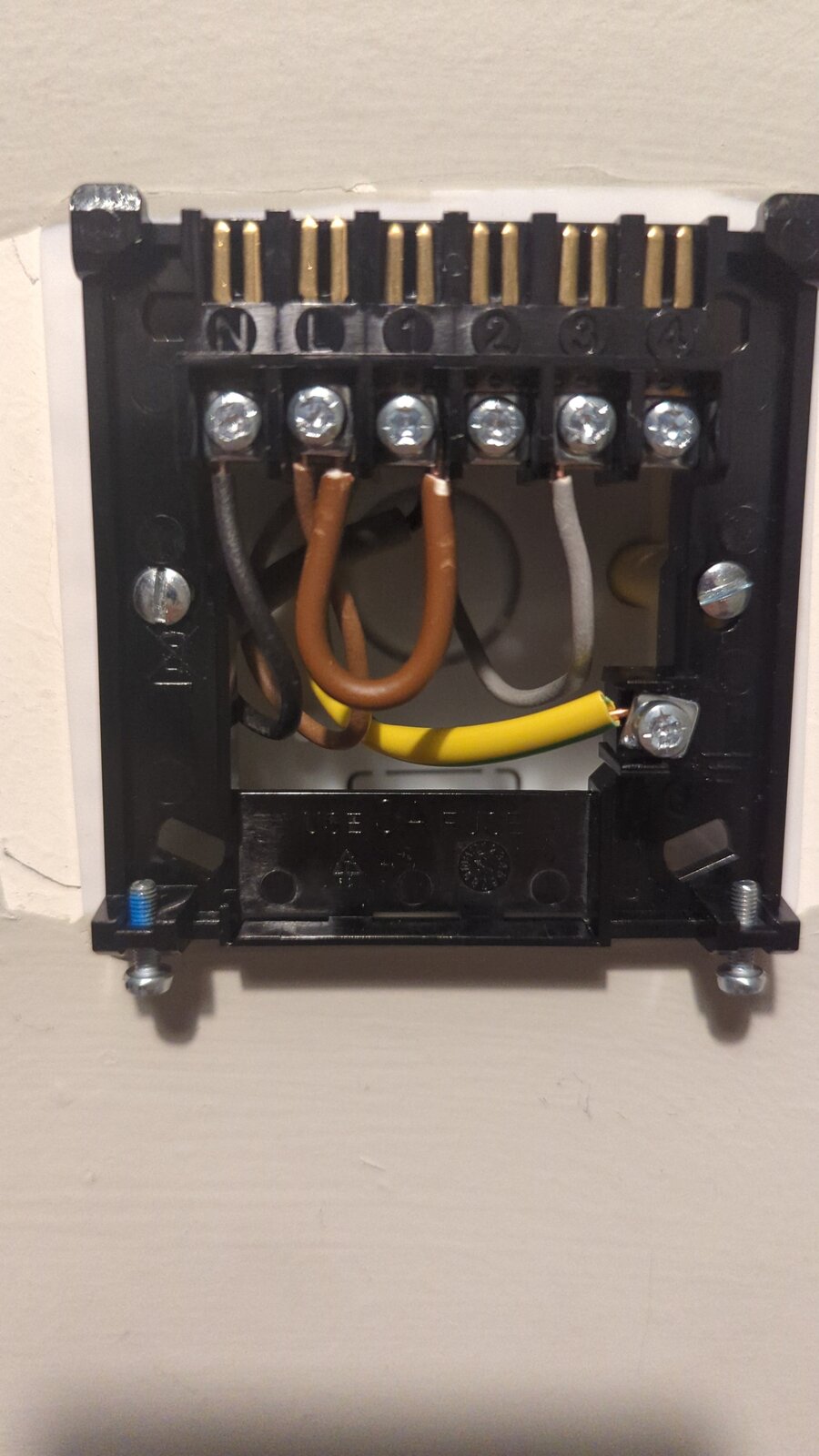

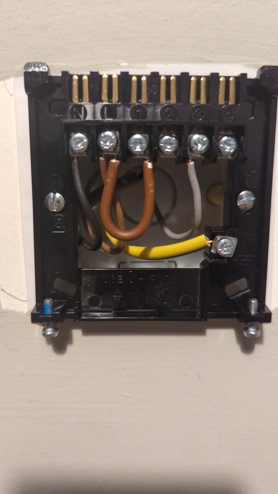

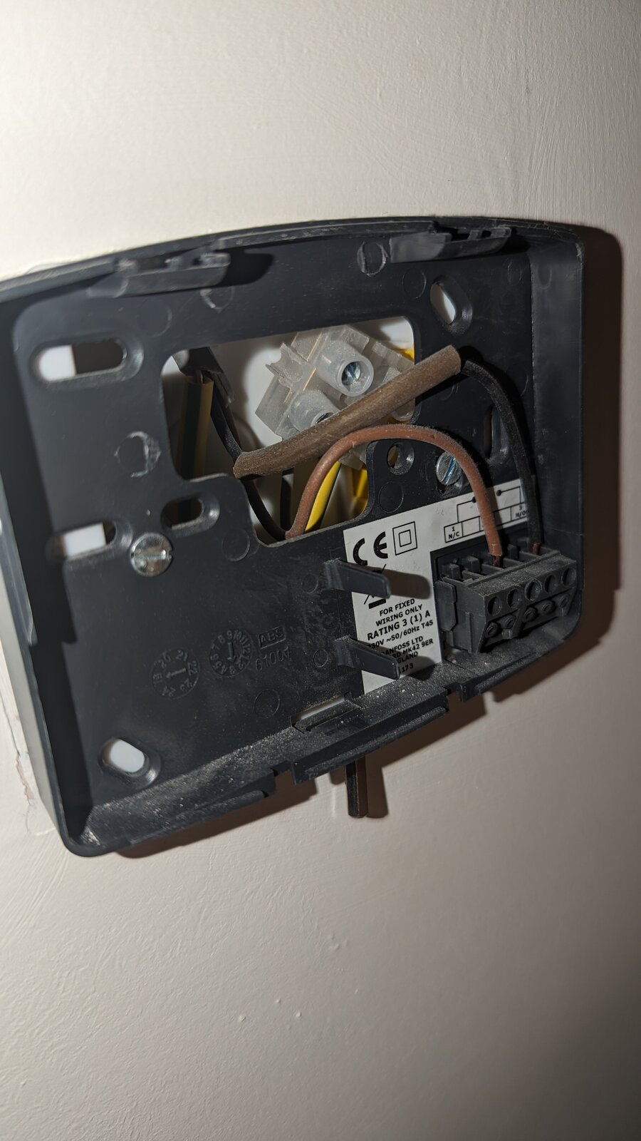

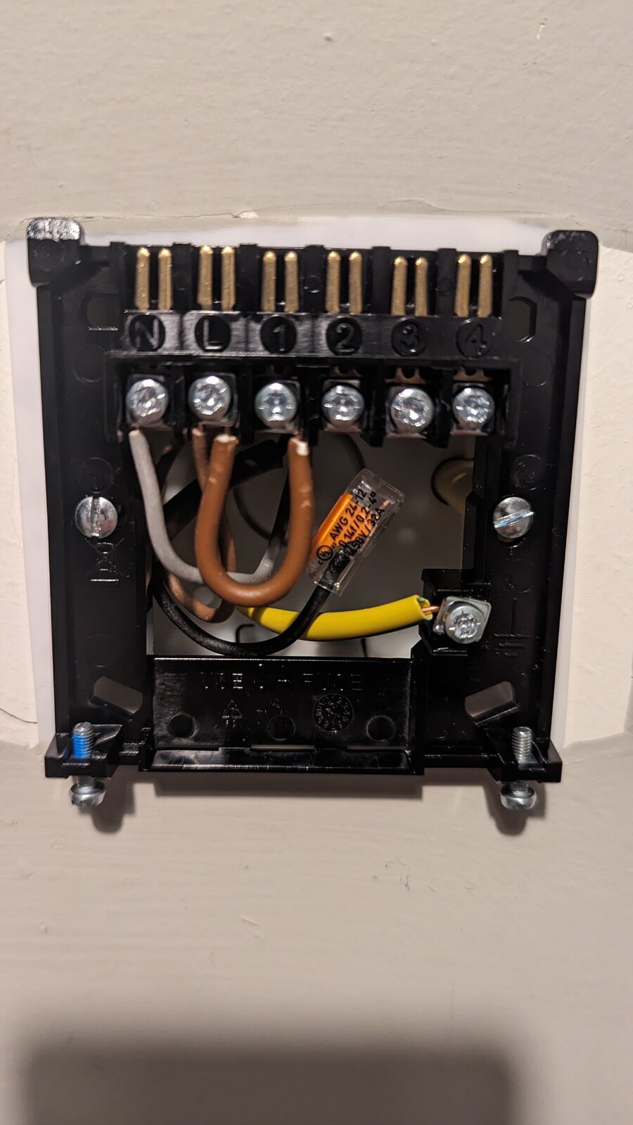

Can you show us a picture of your wiring behind the Hub R as it is now.

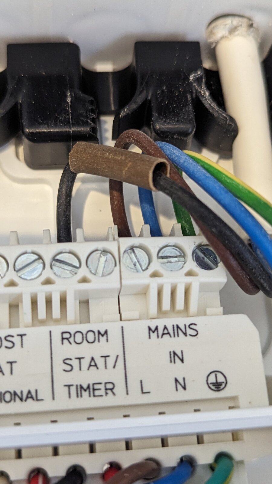

Your original photo showing a black connected to neutral is rather confusing, as all the connections seem to have been made by a competent installer, where black is the switched live throughout.
This is as of now and the video above. If I switch the grey and the black (as I would expect it to be) the Hubr is completely unresponsive

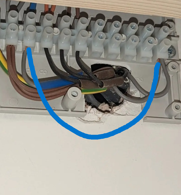

Your competent installer has left the grey wires detached from the neutral in the wiring centre.

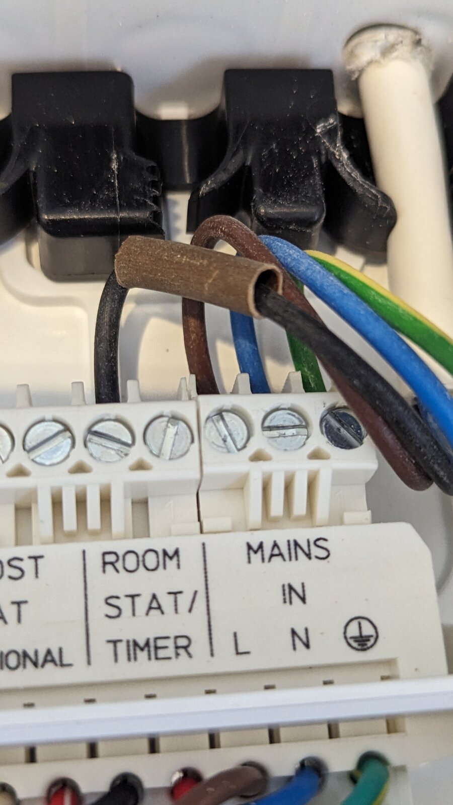

The black with brown sleeve is a switched live to the boiler (Edit: through the 2 port valve), but due to the way it is connected through these components, it is currently acting as a neutral.
The safest way to continue - disconnect the black wire temporarily.
Connect the two grey wires to neutral in the wiring centre, connect the grey to N on the thermostat, and see if it powers on.
Photo to follow...
Also zero cycling when trying to put the heating on (obviously no SL connected though)
Connect the black wire to 3 now I assume?
