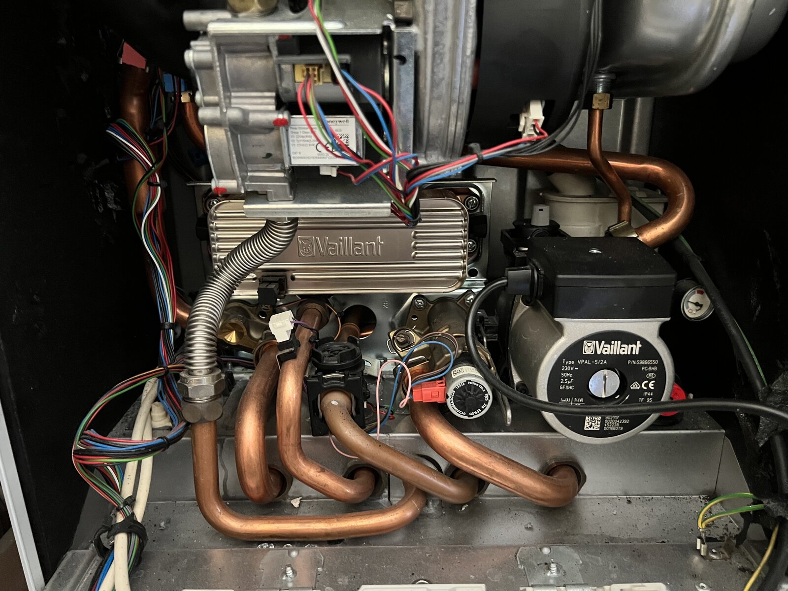

I had a call from some valliant engineer and he advised that looks like it might be going via bypass, there might be restriction in the flow pipe, apparently there is some filter in the flow pipe which sometimes can get blocked. I will have an engineer here on Monday
unless someone else got some other ideas for him to check on Monday ?

I think the sensors are top left corner, there is a blue clip and red clip so I guess red will be flow and blue return. So the return sensor is on the hot part of the pipe, the return pipe inside the boiler is hot if that make sense, the return pipe below the boiler is lukewarm.
In terms of the d40 / 41 they difference looks like it’s always around 5 degree even when it’s dropping, when the pump stops sometimes I have seen the same temp on the d40 and d41

Now that you have established the position of the return sensor, its more than likely that its reading correctly, strange that the circ pump stops though as it shouldnt during recycle conditions, next time you are doing a few tests check the S status parameters. Also the burner shouldnt cut out at its target temperature of 75C, it should rise to 80C but if the rate of rise is very rapid, easy to miss. I have read of several Vaillant owners where the burner is cutting out at only a few degrees above the target temp but this isnt your root problem.
If you assume the average boiler heat demand is say 8hw, just below its minimum output of 9kw, then assuming the rad returns at 33C and a 75C/70C boiler flow/return will mean that the circ pump flowrate is 22.93LPM of which 20.2LPM is recirculating and only 2.73LPM is circulating through the rads, normally one would expect ~ a dT of say 15C through the rads or a circ flow of 1.0LPM/kw of rad output so the rad circ rate should normally be at least 8LPM for that 8kw output.
