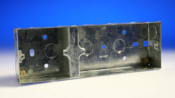

Unfortunately, all the existing sockets are required...I think I will replace the existing single gang backbox with a twin back box and mount an FCU next to a single socket..
A slightly tidier way is to replace the existing single socket with a double backbox and
a Euromodule plate with a 13A fuse, single socket and a blank units.
However, if you are knocking out the wall another idea would be a
and upgrade to double socket and FCU
Yup Good un, you can get "fastafix" type like that too, so good for plasterboard as well.
I have unfused spur going to a single double gang socket...This spur is fed from a single gang socket which is part of the ring main.
I now want to add another socket off this spur, so need to change it to a fused spur. The usual way of doing this is fitting an Fused Spur Outlet....
Rather than fitting a separate FSO near my existing socket, is there such a thing as a 13amp socket outlet with additional terminals (via a fuse)outlet for the spur wiring ie everything built into one unit? I know you can get a standard fused 13am socket, but that's not what I mean...

Yes the grid switch, I used this with mothers house IMGP7387c.jpg double socket back box and a LAP socket, switch, and fuse, with a 4 module face plate.
Might be an excellent choice there eric lad. Just what the Dr ordered meethinks.
You could put 10,000 twin sockets on that so long as the 13A fuse feeds them.
Thanks for the image, I knew I'd seen something previousely when I suggested this option but for the life of me I couldnt find it or remember who'd posted it.
I did it in mothers house, I had it rewired and the agreement was all sockets on a ring final so I could if required add more latter, but the one shown was in the corner of my mothers bedroom, and a spur, not a clue where it spurred from, and there were about 6 sockets now with no power near to this point, so it was a scratch head and work out how to power them again.
The Screwfix LAP range worked well 21218 socket £2.03 faceplate 90455 at £1.20 then 29799 fuse holder at £1.89 and a switch 48927 at £1.97 so the lot cost £7.19 and all fitted in the original back box, OK down to me to wire it, but it made life easy.
There are other ways to do the same thing, but I considered that way was cost effective.
