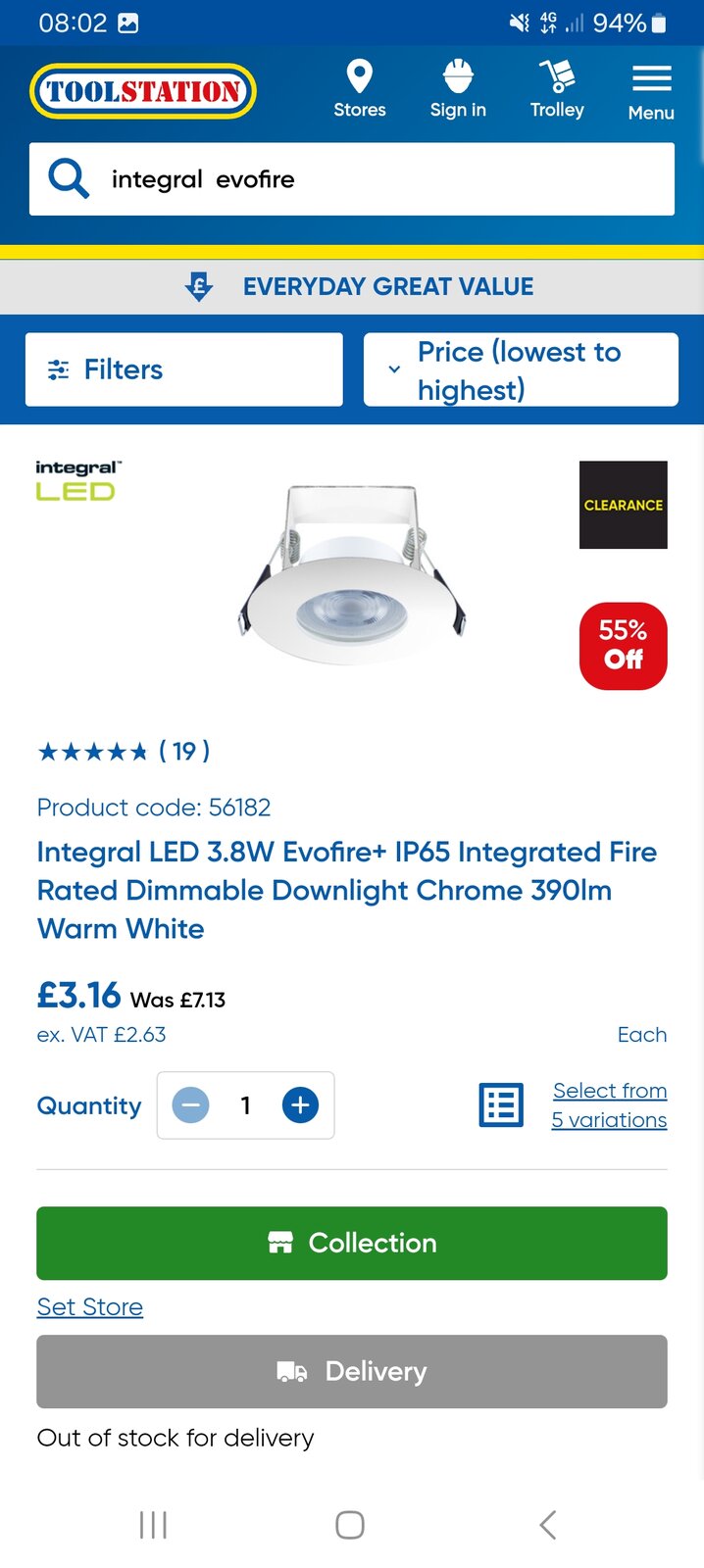

Going to go for these

I'm going for these I think.
I really wouldnt do that.. They are firstly INTEGRATED items. This means that you have to change the whole thing* if one goes pop, and they do.
Secondly they are marked as "clearance". Probably they are a discontinued range, so you'll never be able to get a replacement!
As already advised above. (8&9) get GU10 mains downlights, then you can change just the lamp if and when they die.
*EDIT I see from the Toolstation description that you can buy a new light module if one dies, but I suspect it an obsolete range.

Sorry. Those are with bulb integrated. My link included all types of Evofire.
Better off going for one you can change the bulb in my opinion.
These ones if you want chrome
Separate bulbs. Dimmable option available.
The grey wires from your ceiling will connect in.
