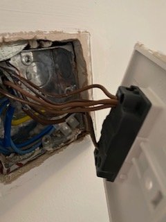

Hi
I'm trying to replace a single switch with a single dimmer switch, I've done a couple of these before no problem but this one is troubling me.
I have four live or comm wires which for the life of me I can't fit into the terminal securely just doesn't seem to be enough room.
Can I terminate 3 of the other wires separately without having to use the same terminal?
Picture of wiring attached
If there is space in the galvy box ,put them in a connector strip and add a single conductor from it ,to the switch terminal.
Looks like there is space as you can see a Choc block in there already bottom right
