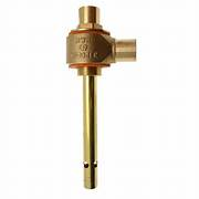

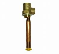

No it hasn't, the flange they have is a Warwix flange, not a Surrey (S) flange. A warwix flange vents to the side and the dip tube air free water is the centre tube, a surrey flange is the other way around, as per your diagram. Have a look at the flange that is fitted to the top of the cylinder in the first pic
Surrey Flange, top vent --------------- Warwix flange, side vent
View attachment 330146 View attachment 330148
