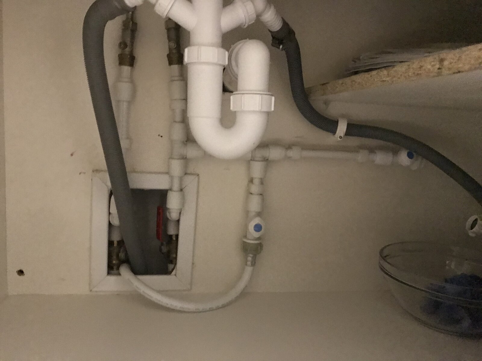

My washing machine has been discconnected from this valve as it is being repaired. This is currently in off position but is still dripping. I assume it’s faulty and needs to be replaced? Do I use the same fitting again?
Thanks in advance.

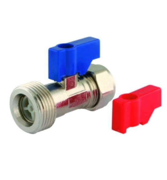

one of these?
I assume this will fit onto the hep20 plastic pipe with the insert in place?
speedfit do one similar to that .
better quality imo and not seen one leak.

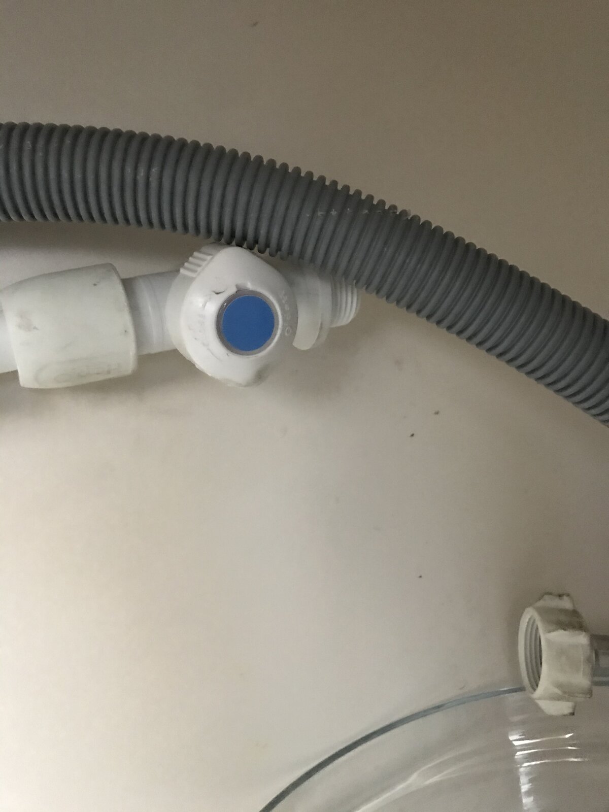

Out of curiosity (I’m that type!!), I just unscrewed my dishwasher from its hep20 valve and guess what? it’s dripping too!!!!
At this point I was captured by my heightened sense of curiosity. I purchased a new Hep20 machine valve and replaced the one on the dishwasher. At first, the outlet was bone dry since it was in the close position. Stuck my finger in the outlet a few hours later and this is dripping too. Unbelievable!
I wonder if I am doing something wrong...
I’ve just got some hep20 pipe under the kitchen cupboard. It’s using the inserts (not that there is any leak at this join) and it continues to drip at the outlet.
I would love to hear your thoughts/suggestions on this.

How high is your water pressure? If you have a brand new fitting and it's leaking then it would be a return or a call to Wavin.
Cant imagine it's very high as I remember when we were having the megaflo installed, it was touch-and-go on whether we are getting the right amount of mains pressure.
I have emailed Wavin and will let you know what they come back with. Their technical support line appears to incur a premium charge!
