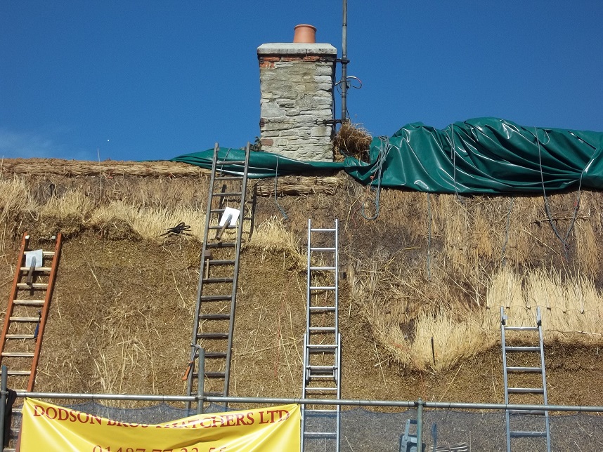

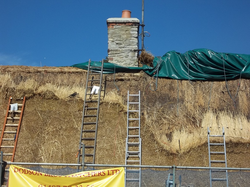

If you have as you have said, a thatched roof,
I do,
chimney.jpg during the re-thatch in 2016
then the use of an insulation jacket in your flue to protect the fabric of the building X..
What should be in place of the X
If it is as you claim, then you were mugged.
That might be your opinion.
I do,
View attachment 115074 during the re-thatch in 2016
And a fine thatch it is too.. Needs trimming before the owner gets into swimwear... I am sure it is yours however a photograph proves little to prove ownership.. Would you like to see a picture of my new Bentley?
As for what should be in place of the "X", in your case, I would recommend a liberal dollop of "KY"... Are you asking how the flue should have been fitted? If you would like me to come out and issue a report, then that is chargeable.
I'm sure that you feel that what has been stated is my opinion but HETAS have never faulted my installations.. And I have faulted yours based on what you have told us.
