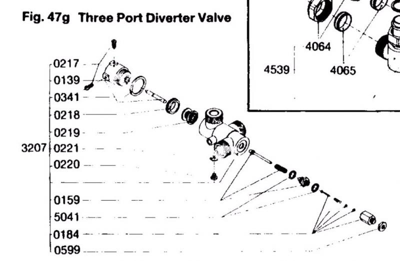

The O ring that can allow mains pressure water to pass to the heating is located on this one.
Near the little x is a small threaded plug with a hole through it. That plug holds in a tiny o ring.
If you drain the boiler and remove the 3 way valve you will be able to see if the o ring is passing by turning on a hot tap.
Oh and by the way also remove the donut washer from the tail peice of the 3 way valve as this plays a part in it as well.
Its the one on the top left of this one
You will probably find that the tail piece needs replacing and the 3 way valve needs refurbing. (requires a special tool to remove the guts of the valve.)

Gents,
Is it just 0341 in this diagram (the fibre washer for the 3 port valve) that is the common source of leaking and pressurising the system?
This is near the tail piece, so i presume it's the one being talked about.
Rob

Take the doughnut washer out of the old tail piece and fit this into new tail piece. Also replace the small O ring around the spindle sticking out of the six screw unit front plate (domestic manifold). Stick to following advice given by regulars and your boiler will be working again
No its not that one.
This is what i do.
Drain boiler, leave cold mains on for now.
Remove 3 way valve.
Behind the 3 way valve is the DHW flow valve.
Now turn on hot tap, you will see the pin pop out.
If water is coming out of where the pin comes from then that is the source of the problem. New o ring will sort it.
I usually bin the donut washer because without it the boiler can't overpressurise (the water just drips from the bottom of the tail piece instead)
I always refurb the 3 way valve at the same time. ;)
This is what i do.
Remove 3 way valve.

I removed the 3 way valve earlier and did as SMJ said and water (when hot tap opened) did pass a little past the tiny o ring secured in by the plug. Only a small amount, but i can imagine how washing up and a shower a day could equate to having to drain off a pint a week.
I replaced this also the large diagraphm (as it was badly marked and looked pitted in one area) in the manifold and cleaned it all. The small o ring didn't look damaged but there was gunk around the spindle and where the o ring was seated. I guess with mains pressure on, water only needs a tiny gap to leak and pressurise.
Cleaned out bit of gunk in the back of the tail plate infront of the large donut washer but left this in (didn't see this post till after!). Oh, i opened the hot tap again for a while when changed and seemed OK.
So, if it isn't passing the small washer, there should be no place the system could pressurise, except the secondary heat exchanger (if pinholed)
The pressure of the leaking water was shuttling the 3 port way internals which fed the water into the primary (heating) system?
I've enjoyed learning a bit about my boiler and yes, i'll ignore by cricket boiler mates!
Cheers guys,
Rob
Thats correct.
The ones that i have seen overpressurising have been:
DHW o ring = 99%
Passing fill loop = 1 %
DHW heat exchanger = 0%
