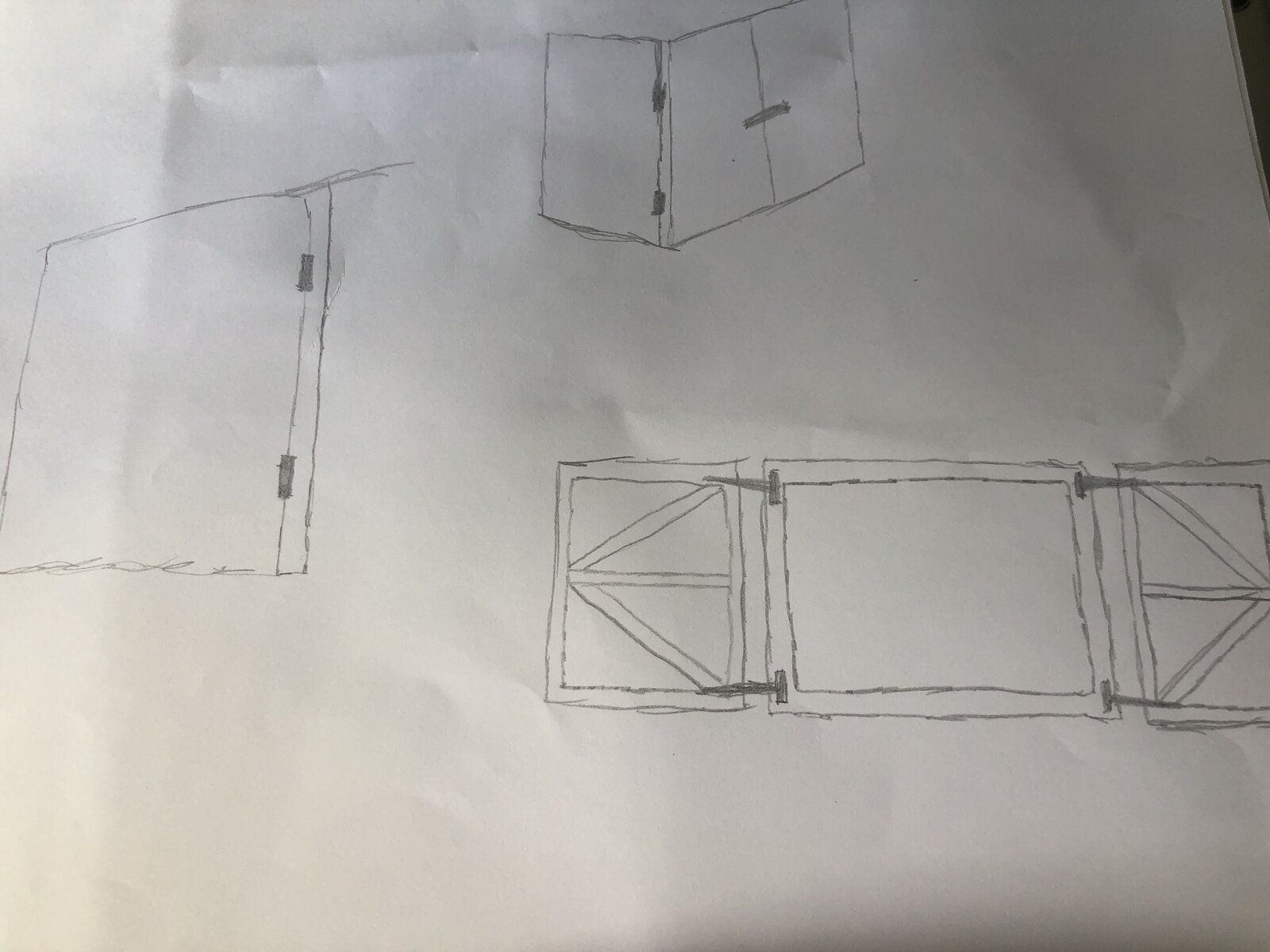

So, installing regular t hinges for a gate/shed door, installed inside (sandwiched) between frame and door should be good?
see sketch below
Sadly - no. You never be able to fully open the doors past 90 degrees as the thickness of door will stop any further opening. Put the gate type hinges on the outside of both the shed (doorway frame) and the doors themselves.
Sorry, I don't think they will work on the inner face. I think the (hinge) knuckle will be in the wrong place.
In fact the more I think about it, the more I doubt that they will be suitable. As per one one of my previous posts you might be better off with regular butt hinges.
