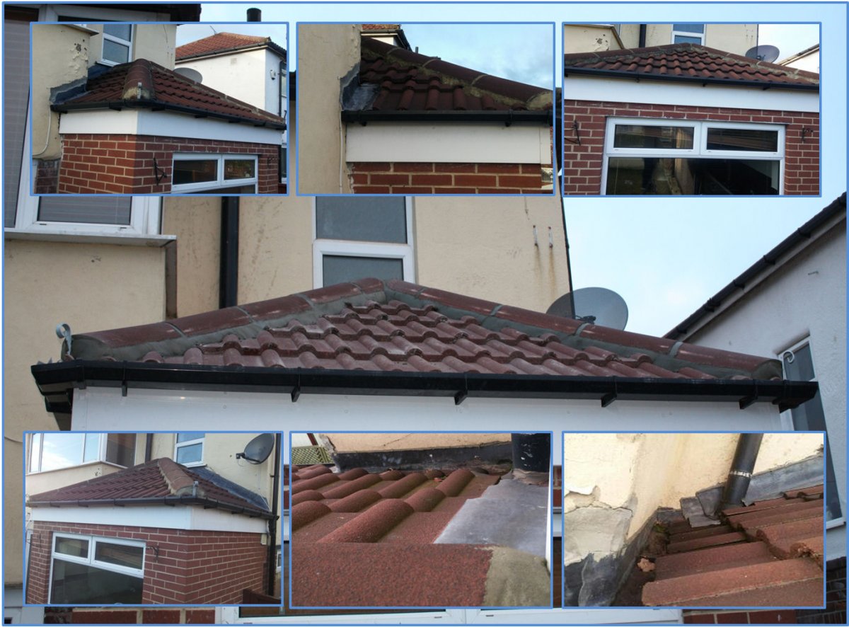

Hi folks,

Back in December 2010, we had a pitched roof installed on our extension. The builder provided us with a 10 year guarantee. A roofer came to our property, recently for 30 secs and had one look and with disgust said "that's bad workmanship, the headlaps are all wrong! Get them back and correct it". He rushed off and left the property :/

Can you please let me know from your professional prospective whats wrong with the roof, so that I can get back to the builder and to correct the issues.
See images, below thanks:

It does look untidy but is it actually leaking?
Otherwise, there may not be any 'issues' to correct.
From your fourth picture, where you can see the topmost and topmost-but-one (and two) rows. (Assuming a 50 X 25 batten) it looks like you have about a 50 mm overlap on the topmost-but-one to the topmost-but-two rows.
I would have thought that that was an absolute bare minimum and should be 75 mm at least.
If you know the tiles used and the pitch you can consult the manufacturer.
This is normally specified with the tile manufacturer and it’s advisable to check how much they say a roof tile should overlap, normally on a smooth faced tile the overlap is 75mm ( 3″ ) and on granular or sand faced tiles its 100mm ( 4″ )

But as Tony says, don't fix it if ain't broken.
In the 9th picture where the roof abutts the bay window, there does seem to be a bit of chaos going on with variable headlaps.

Perhaps there might be a problem, but it remains undetected 'cos the original felted flat roof is still in situ.
Where does the bath/sink discharge from the bathroom go now?
The discharge now goes to the right hand-side where the satellite dish is, rather than the soul pipe. (The image in blue box , bottom left) and (see orange box last image with bubble around it).
