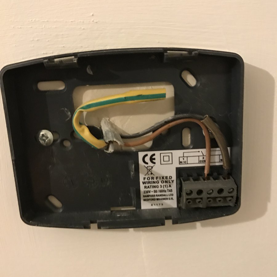

hello,
I'm looking to install a hive or two; my house is a new build and has been fitted with a danfoss tp9000 controller and thermostat downstairs that controls the heating and hot water and a tp5000 upstairs that controls the heating in the bedrooms and bathrooms.
The downstairs controller looks simple enough to fit, it looks like a simple swap the backplate over and refit. The upstairs however is baffling me. The controller only has 2 wires going to it: black to N/O and brown to COM. As the hive seems to require a few more wires, what is my current setup missing or more importantly what am I missing?
I've uploaded a photo of the upstairs controller, hope it helps explain.
Thanks for any suggestion and help.

Your programmable stat is fitted with a remote sensor which means the internal sensor is disabled, all the heating in your house is controlled by the upstairs stat, do you know how many/ what type of zone valves you have ? the tp9000 is a 2 channel (heating and hot water) so if you want more zones you will need more zone valves.
The downstairs controller only controls the downstairs heating and has a wired thermostat which is in the living room. There is no other remote or wired thermostat in the house.
When we moved in we were told that the upstairs bedroom temperature controlled the other bedrooms and bathrooms.
As for pumps, I haven't got a clue :(
if you look in the cupboard where the hot water cylinder is you should find zone valves (google for a picture) attached to the pipes, how many do you have or post some pics .
There are 3 of them, I'm guessing one for each of the zones plus the hot water?
So the upstairs controller is in fact the thermostat for the bedrooms? Thinking about this now, could I just fit the hive receiver next to the tank and put the thermostat in place of the one in the bedroom?
Yes that's right, as long as you have the zone valves you can connect a couple of hive stats to control them.

The upstairs was actually quite easy once I figured out all the wiring. I installed the hive receiver next to the hot water tank and traced which wired went to the thermostat upstairs. This wire is actually connected to the control valve to switch it on and off so I figured this should be connected to the HO in the hive. The TP5000 is actually battery powered so this is the only cable that was supplied to it.
It was then as simple as connecting the hives heating on to the switch return and then hooking up the perm live and neutral. One thing I had to do though was bridge a wire from live to COM.

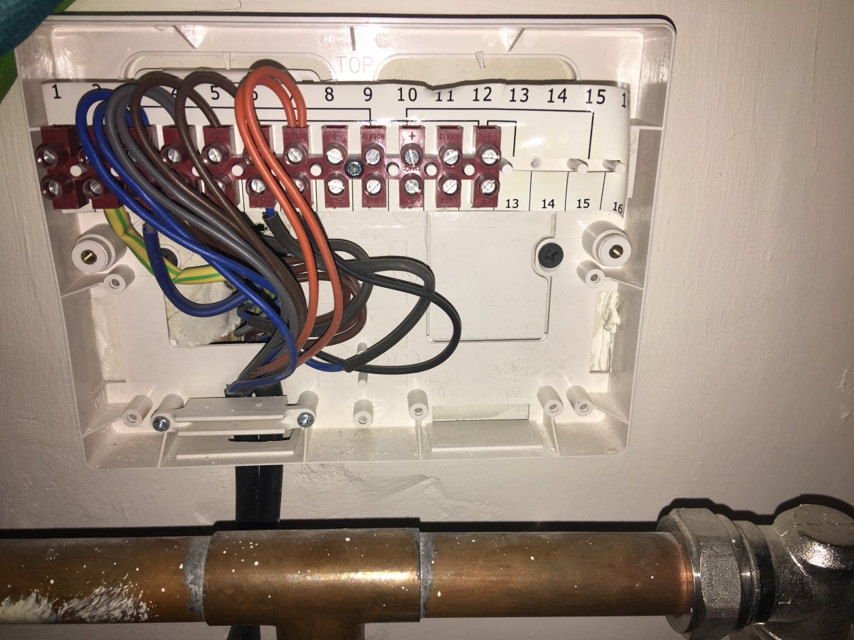

Good morning I wonder if you would be kind enough to look at my set up in the attached picture and guide me as to how to wire up my 2 receivers to replace my current danfoss multi zone set up.
Thanks.

Hi, I'd be wiring your twin channel receiver to your programmer backplate and your single channel there at the wiring centre using permanent LNE and then replace stat common and call with your hive.
Hi Buddy, Many thanks for the quick reply.
Please excuse me as I'm fairly new at this.
The problem I have is that BOTH my Danfoss Thermostats (upstairs and downstairs) are TP5000 so I can't wire the twin channel to the programmer backplate.....
I would really appreciate it if you could take a look at the picture attached and perhaps be good enough to tell me which wire from the Hive receivers goes into which terminal in the wiring centre.
I would really really appreciate your help on this.
Kind Regards,
Can you please confirm that the following wiring should do it?
From Receivers: Brown (L) to Red (7 - Live) in Wiring Centre Box
From Receivers: Blue (N) to Blue (3 - Neutral) in Wiring Centre Box
From Receivers: Black to Brown (5&6 - Zone Valves) in Wiring Centre Box
If this is correct, what the heck are the grey wires from the Wiring Centre Box for???
