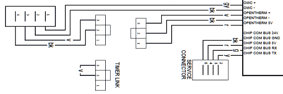

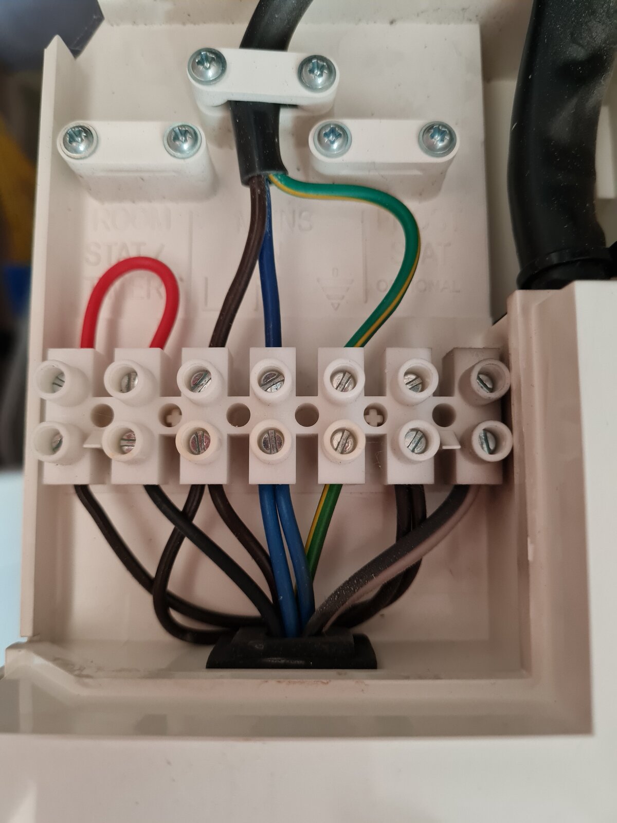

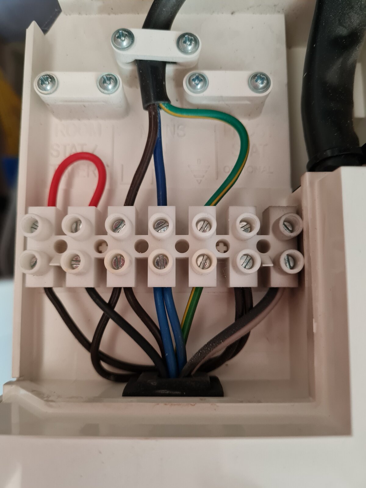

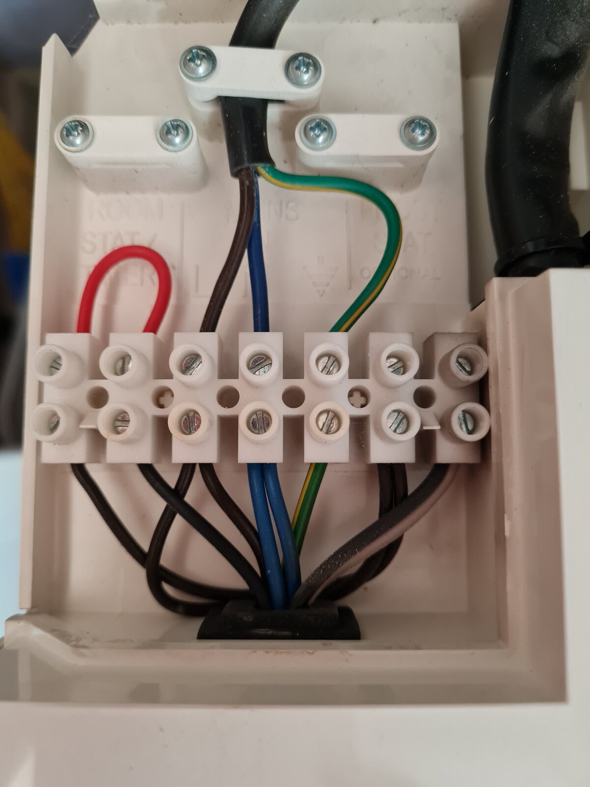

Hi, new here and i apologise if this has been asked a thousand times. Im looking to fit Hive to my current boiler which is a ideal logic combi 30 which is controlled remotely (no wires) by an ideal PRT3 programmer in the living room. I now want to fit Hive, my question is apart from the power do i just remove the link shown in the picture and replace it with the wires from the Hive?

Yes, the Hive contact replaces the link. You will also need to run LN&E To the Hive to power it. So you’ll need two twin and earth cables, or a 4-core plus earth cable.

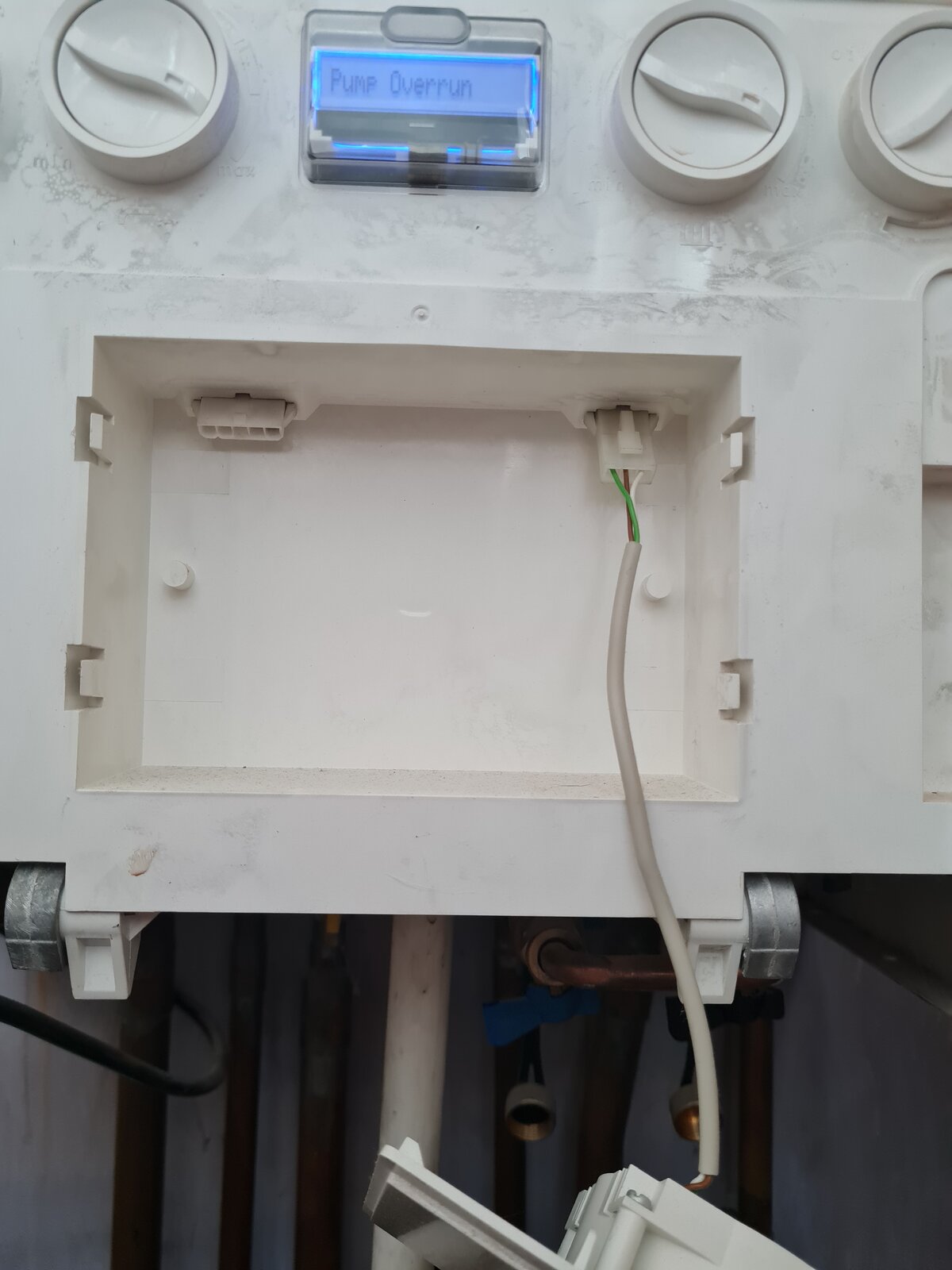

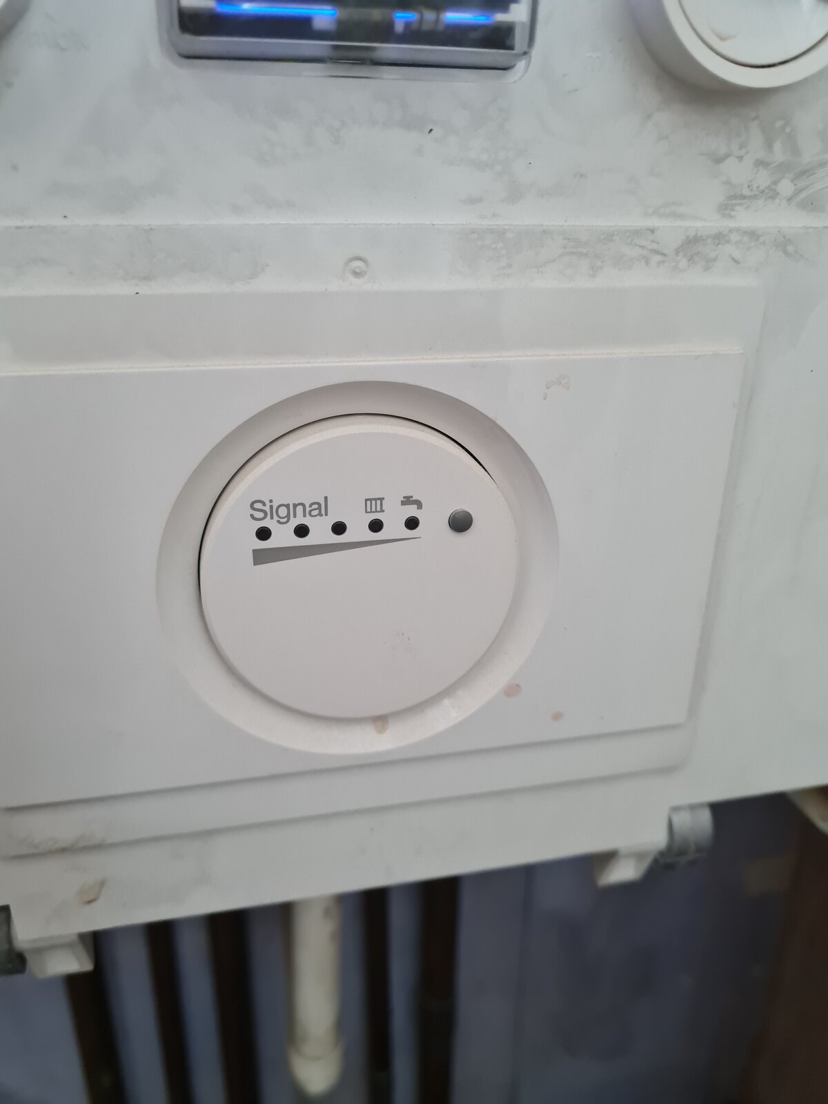

Thanks :) that's what i thought, do i need to do anything with the receiver on the front of the boiler? shown in picture

You would need to replace the link wire plug removed when the PRT3 programmer was fitted. I have looked at the installation instructions for the PRT3 and it does not say it is a modulating control. However Diagram D page 33 does give the connection details for OpenTherm, it says
Locate the OpenTherm connection on the right hand side of the boiler installer connections area and connect the 2 core cable from the OpenTherm device.
so it seems likely the PRT3 programmer is opentherm, and Hive is not opentherm, so looking at Honeywell EvoHome or Drayton Wiser or Tado or even Nest although Nest does not work with TRV heads.

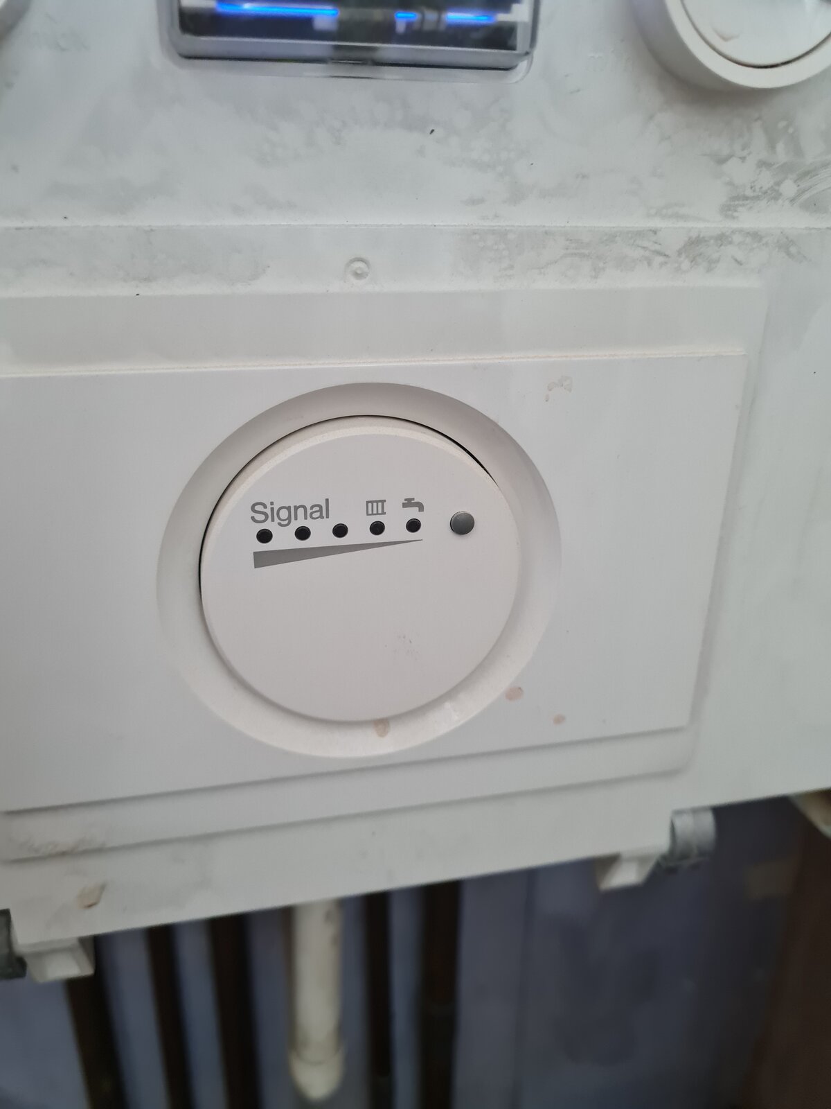

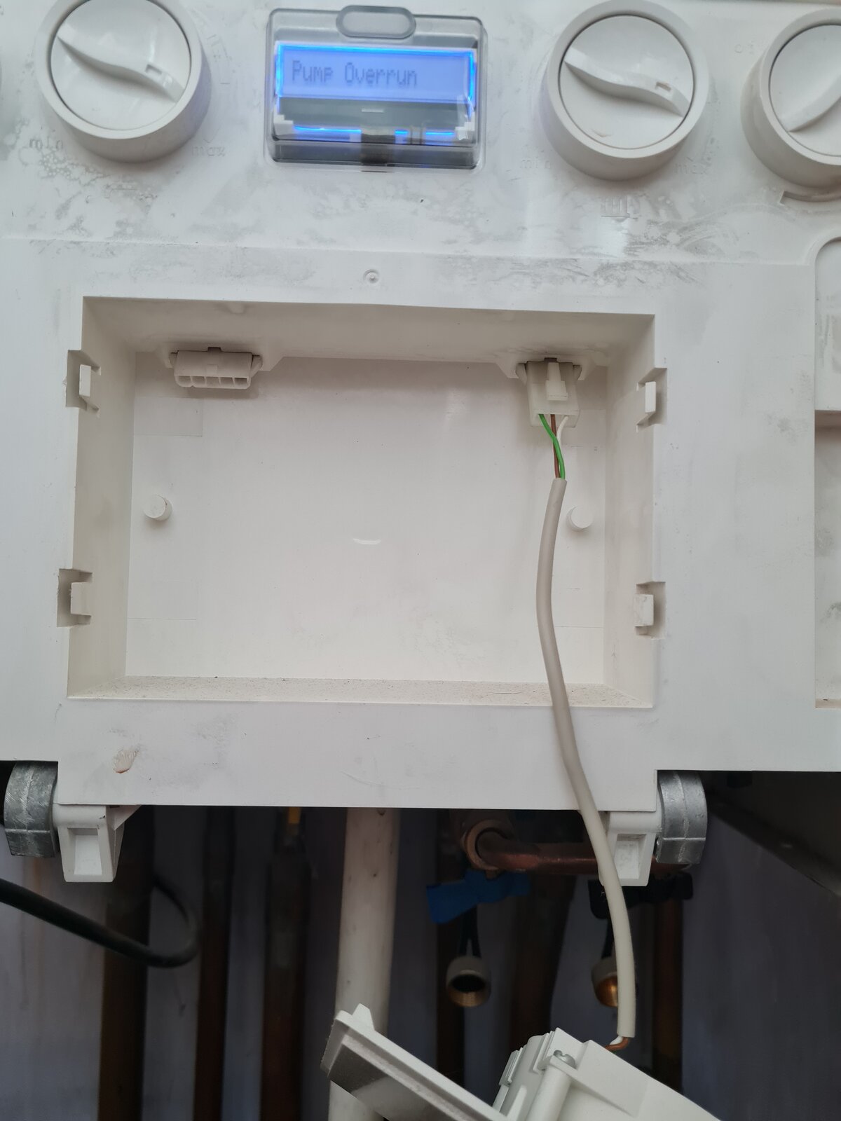

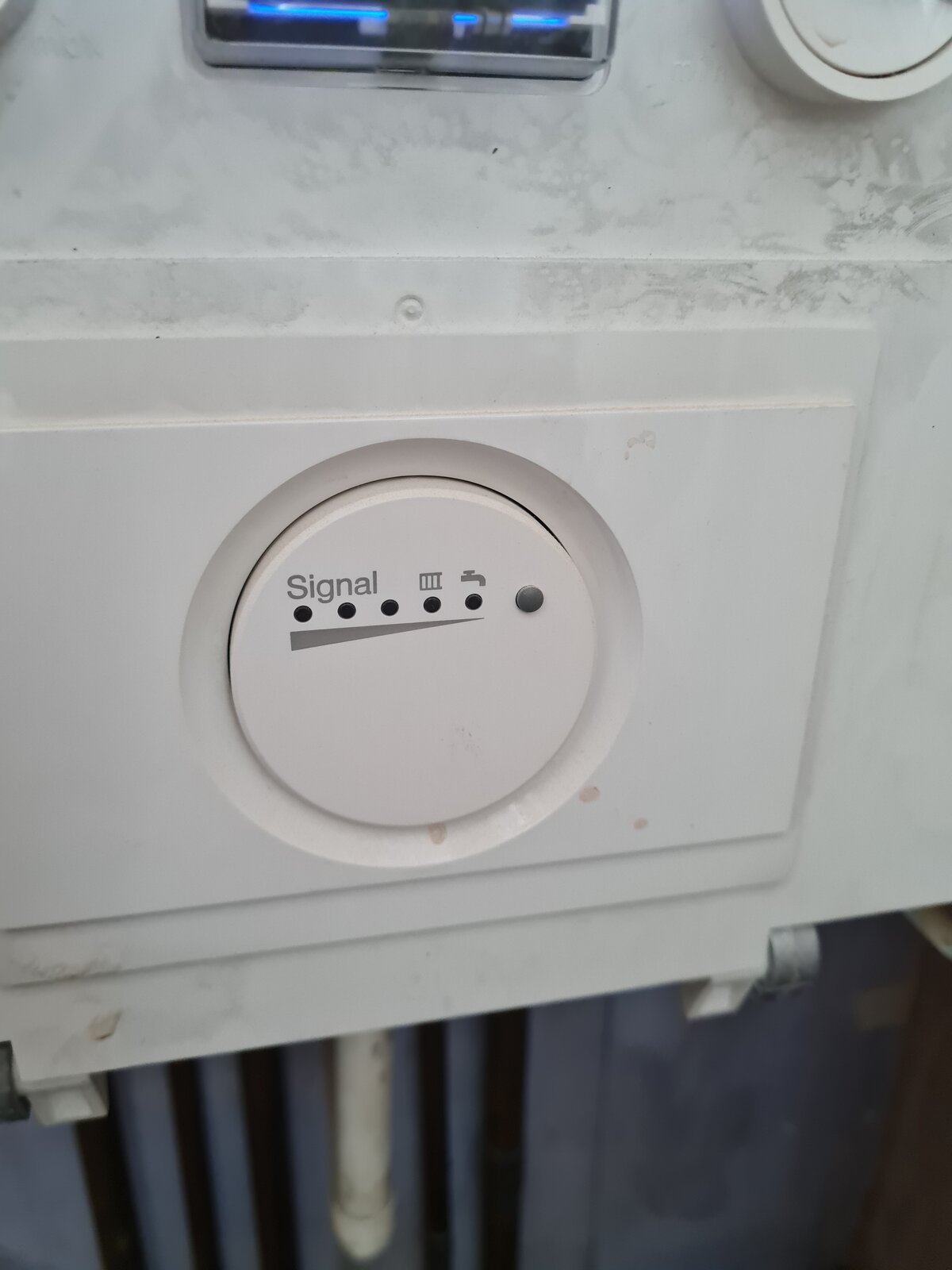

So do i need to link the receiver out? please see pic? was pretty sure what i needed to do, until the post by ericmark

You can use Hive, there are two ways to control a modulating boiler, one is with a thermostat connected to the ebus and the other is by the return water temperature. The problem in your case is to replace the link wire plug which I would assume you don't have.
You assume correct, i don't have it, the boiler was fitted when we moved in, but can i just solder the wires needed together and heat shrink?
