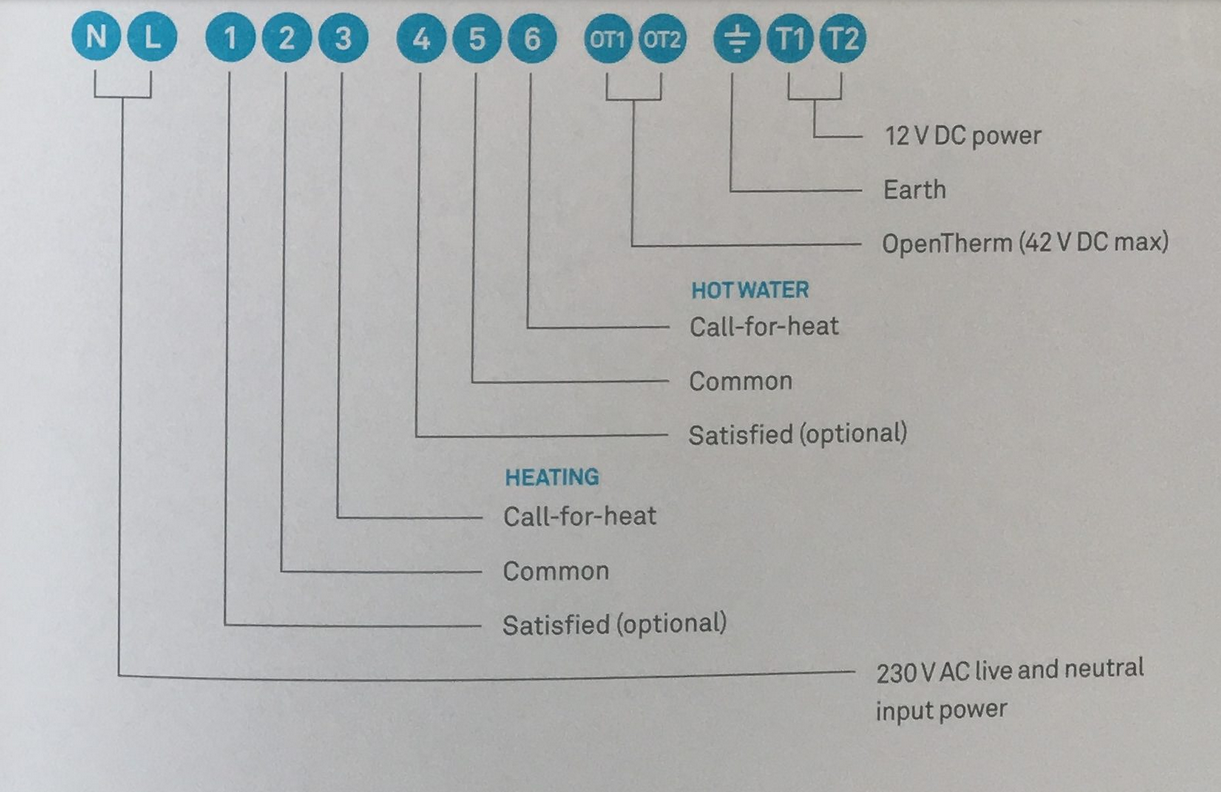

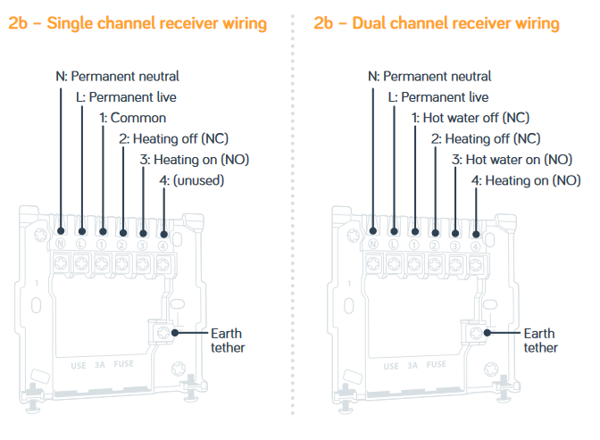

1727528213359.pngThere is no T1 with Hive, Nest Gen 3 1727528371746.png has a T1 and to connect that to the 230 volt supply would likely mess it up, as T1 and T2 are 12 volt.

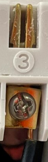

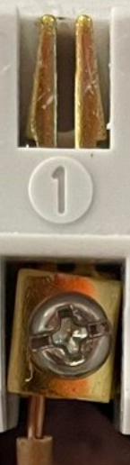

1727528925554.png This is the normally line terminal used to put three port valve in fully over position if you set DWH off and CH on, with CH off it does not do a thing. Well it can hold the three port valve all the way across, but it will not fire boiler. This wire must be line 1727529225173.png for the boiler to fire up to supply DHW if central heating not running.

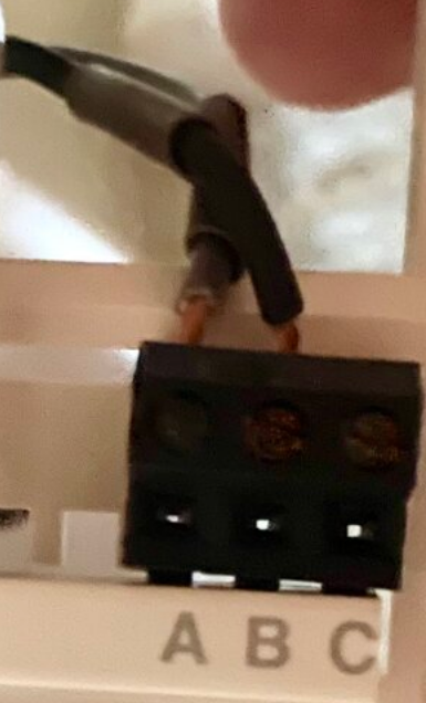

This points to a wiring fault, not anything wrong with Hive or motorised valve. It would seem most likely some one has tried to by-pass the wall thermostat in the wiring centre. As shown here 1727529745768.png but in error they have bridged the wrong pair.
With a picture of wiring centre we may see error, these two wires 1727529991747.png should be bridged at wiring centre end, maybe we can work out what has been bridged in error. But it may need some one with test gear to work out what has been done.
