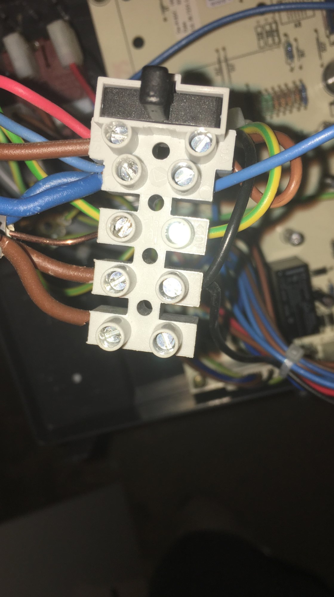

Ok here is the wiring to my baxi 105e from hive receiver. Anyone any ideas now?
I noticed there are 2 black wires coming out of 1 in the boiler is this correct ?

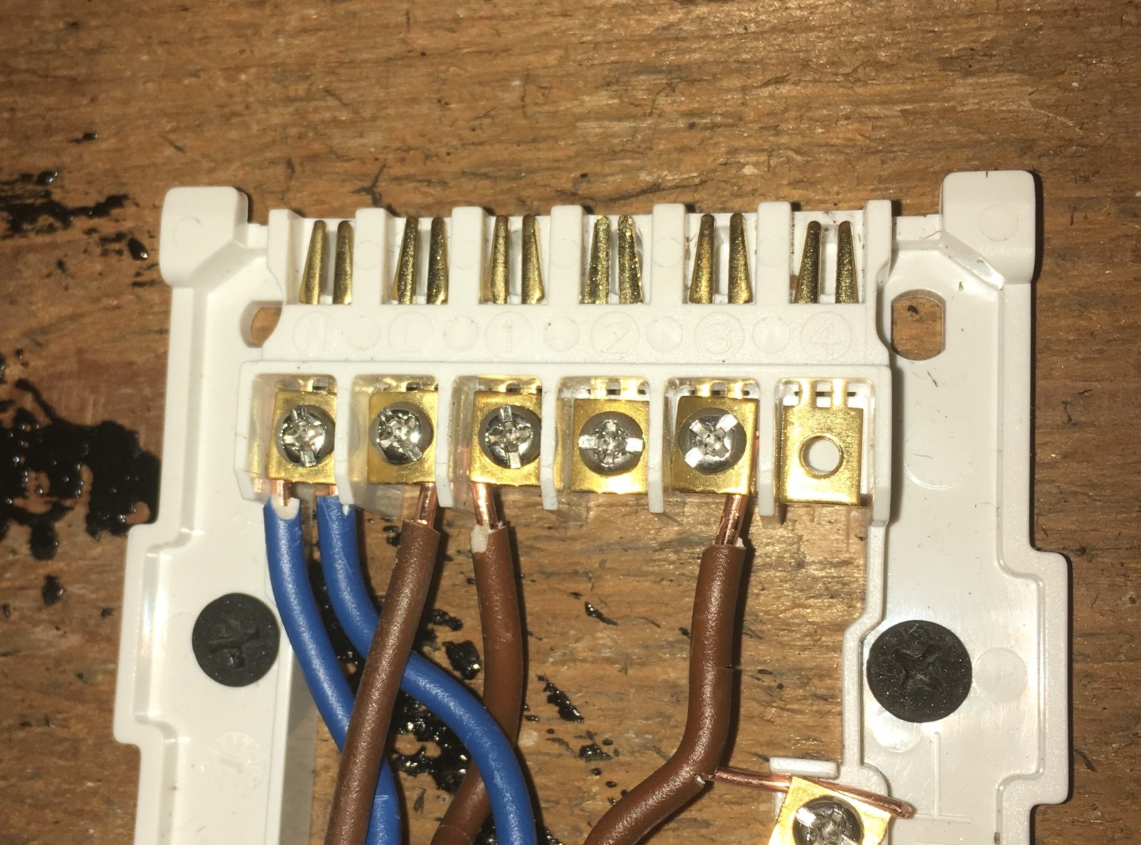

Remove the wire from 3 on the receiver. Does boiler go off then?
If it does then there must be a problem with the Hive.
Removed wire from 3 on receiver and boiler still firing ? So looks like no problem with hive?
And here is the wiring to my receiver please someone help this is driving me

Regarding the boiler wiring. There are two black wires in the terminal one up from the bottom (1). That's wrong. One of them should be in the bottom terminal (2) It doesn't matter which one.
As per the diagram posted by EFLimpudence earlier.

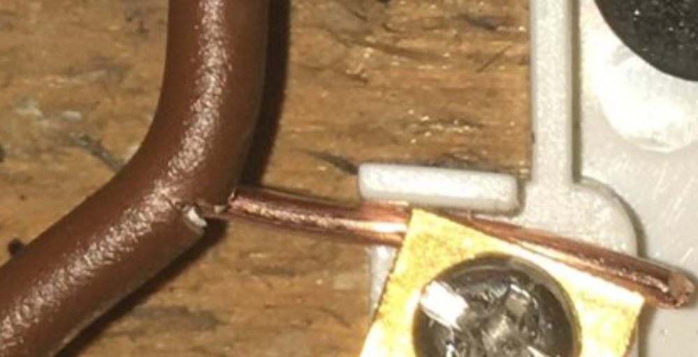

In the photo of the Hive backplate wiring it looks like the earth is coming out of the brown wire, and they say the camera never lies. ;)
Haha bad photography ! The earth was not coming out the brown wire lol.
So I put one of the black wires into 2 and it's worked! So pleased thank you so much don't know why there were 2 blacks coming out of 1 but moving it has sorted the problem. Thanks to all who contributed :)(y)

Instead of the installer inserting a link between terminals 1 & 2, the boiler black wires had simply been put in the same terminal instead, which from an electrical point of view achieves exactly the same thing. Your photo of the boiler wiring just served to highlight where the problem actually was.
