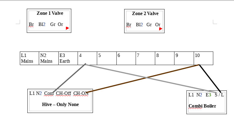

Hi Stem,
I did not get a chance to reply yesterday. I understand your point, the only thing which confuses me is one spare cable from the boiler. Please see attached is my existing wiring without any zones. Only one HIVE controlling the whole house.
Following is how my 5 core cable coming from the boiler.
Brown going to permanently live
Blue going to perminent N
Green going to Earth
Grey from boiler going to COM on the HIVE
Black from boiler going to CHon on the HIVE.
I know I am going around the circles but just wanted to be sure of it before I touch it.

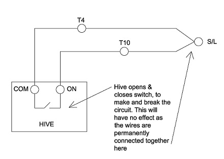

Hive 'com' and 'on' are just an electrical switch. When the Hive turns the heating 'on' the two terminals are electrically connected together, but according to your drawing they are already permanently connected together at S/L effectively bypassing the Hive switch and meaning it would do absolutely nothing. So either the Hive is not working now, or you have drawn something wrong. Are you really sure that the Grey and Black cables are both connected together at S/L? I Would expect CH 'on' to go to S/L, and 'Com' to go to a permanent live, either at the boiler or via T4.
Hopefully you will see what I mean from the slightly different representation of your diagram below:

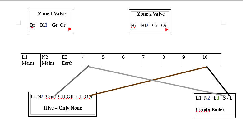

No, Two separate cables coming from the boiler and not connected.
My only worry is with the zone valves one the cables will connect to orange, what will happen to the other?
The orange and grey wires are connected to a microswitch inside the motorised valve, when the valve opens, the microswitch operates, and the grey and orange wires are electrically connected together. This is what switches the boiler 'on'. As the existing motorised valve (Zone 1) will already be doing this, connecting the grey and orange wire of the new valve (Zone 2) to the grey and orange wire of the existing valve means that when the new valve opens it too will switch the boiler on.
Sorry don't understand that! In your drawing, you show the black and grey wires connected together at S/L.
BTW I think you maybe getting the terms 'wires' and 'cables' confused. They are not the same thing.
