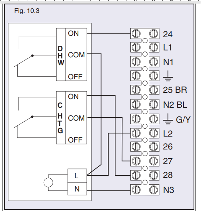

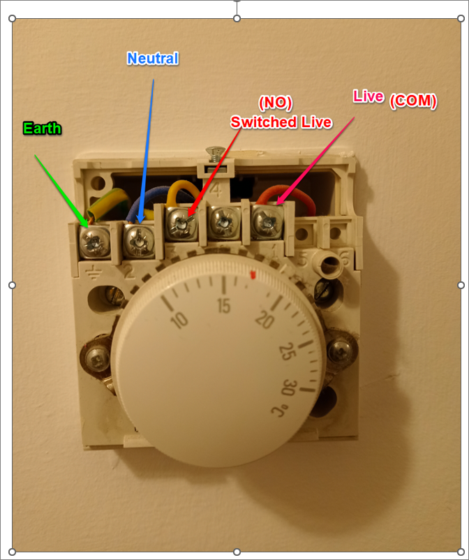

I plan to replace the wired thermostat on my powermax SS 155X with a Tado Wired Thermostat as the current Honeywell TS seems to be way off the temp readings. Based on what I had read through it looks to be fairly straightforward as we only need 2 wires( Live and SL) on Tado. Drawings Attached. Can you please let me know if my understanding is correct?

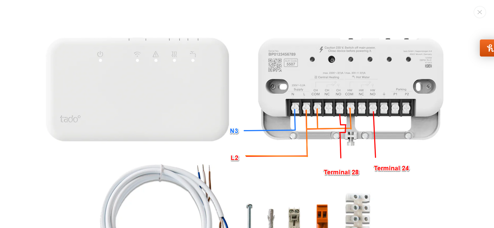

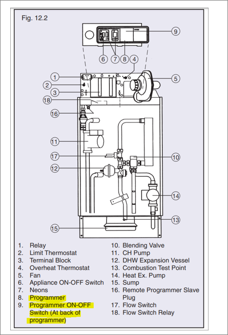

The next task I have is to replace the inbuilt programmer with Tado receiver to have DHW control. as per the manual, we can disable the inbuild programmer using the ON/OFF switch on the back of the programmer itself. The reason for this is I can't run CH independently without running the HW. I could use the inbuilt timers to match the time I want the CH to be ON or leave HW ON on all the time, but I don't think that's very efficient and the Tado has less control. I have a connection drawing for the receiver attached with DHW control. Do they look correct?

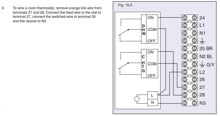

Normally the Tado receiver replaces the existing programmer, and your sketch with the wires from the CH NO and HW NO terminals to 28 and 24 look good to me, as does the live link to the two common terminals. The switch you mention would be set to disable an inbuilt programmer.

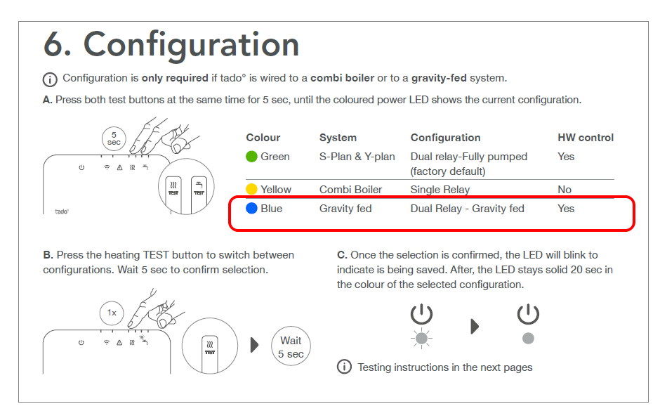

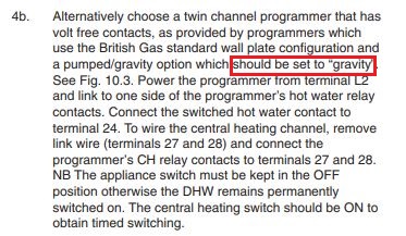

However, from the Powermax 155X manual below any programmer used with it needs to be set to 'gravity' this setting would mean that the HW would come 'on' automatically whenever the CH was 'on'.

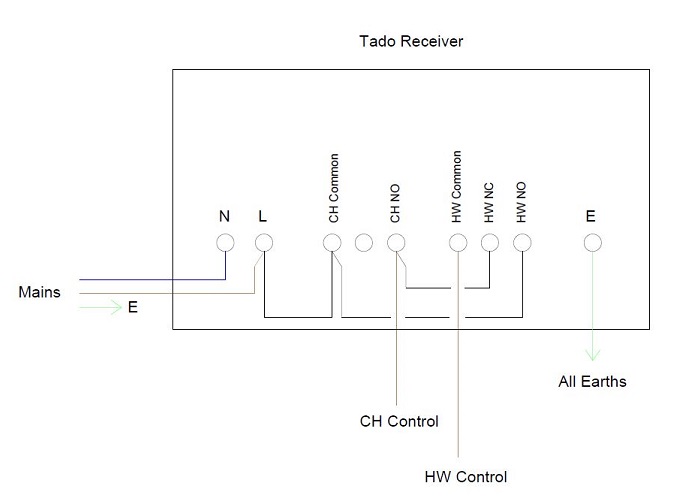

Unfortunately AFAIK Tado doesn't have this facility. There are several versions of the Tado receiver out there now, and if you have the installation manual for the receiver you have, it should tell you if it does have a gravity mode. If it doesn't mention gravity mode it probably doesn't. I have got a hardwired workaround that I've used with the Nest Receiver (aka Heat link) that has the same wiring arrangement as Tado and switches the HW on, whenever the CH is on. Post back if you would like it.
To remove the old room thermostat, I would do this by disconnecting the existing thermostat cable and reinstating the link between terminals 27 & 28 as per the manual.

Thanks @stem for the info. I don't see any gravity settings on Tado receivers. does that not mean we can't use Tado receivers? Can you pls send me a hardwired workaround? Sorry about hijacking this port as I thought this was the closest discussion to what I was looking to achieve.

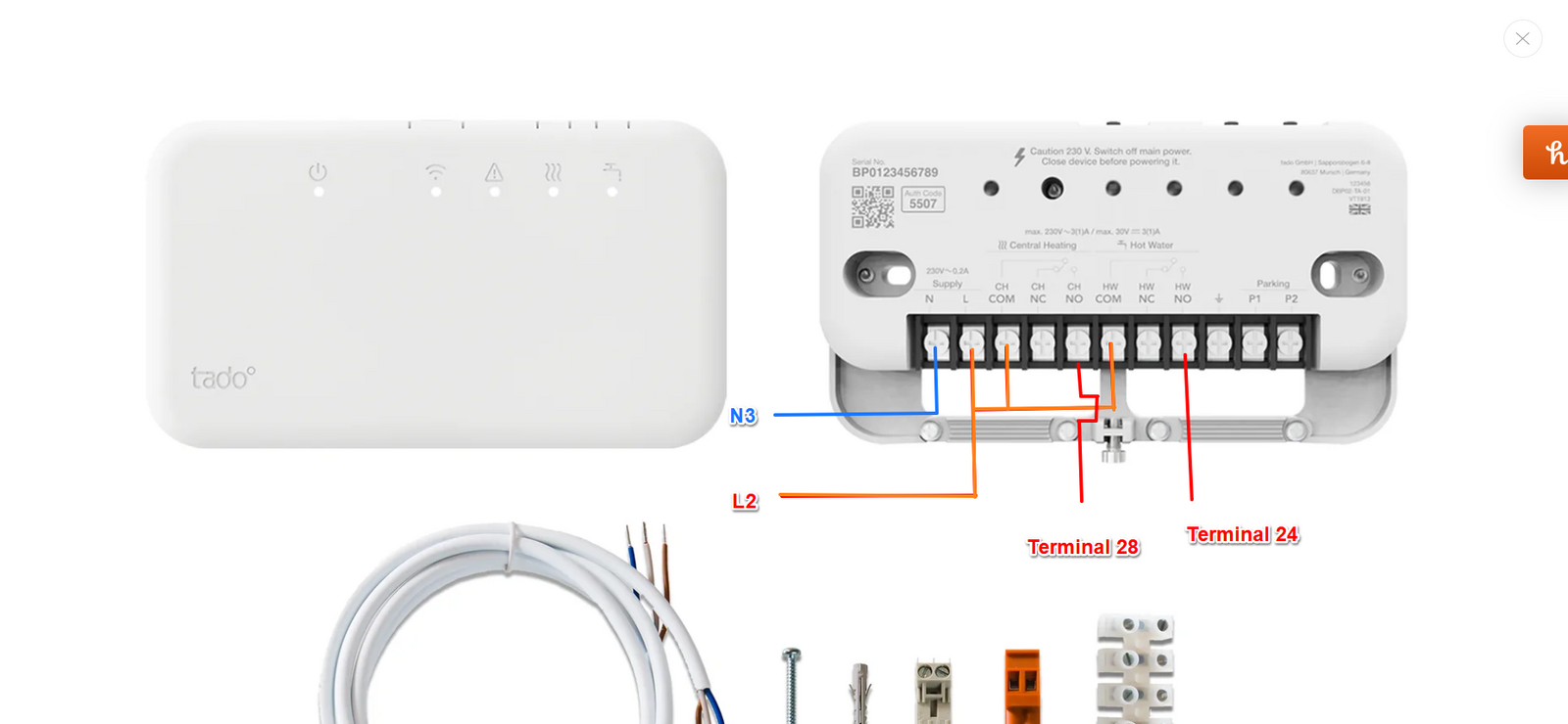

Here's the hardwired workaround. With this arrangement the HW can be 'on' on its own. But whenever the CH is 'on' it will also put the HW 'on' automatically at the same time.
Based on your earlier diagram, the wires shown below are:
CH Control = 28
HW Control = 24
Make the links between the terminals carefully, it's easy to get them wrong.
