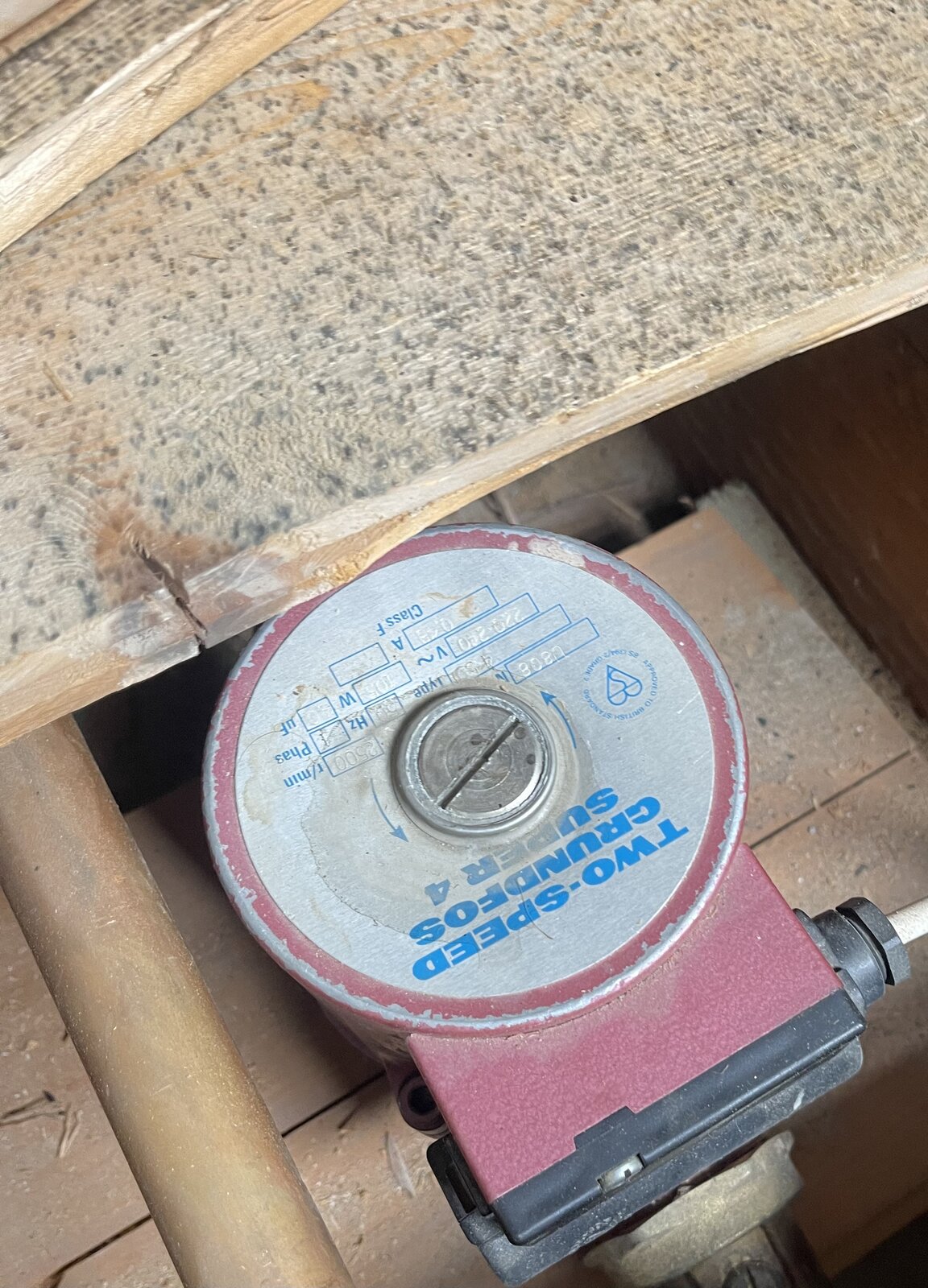

Looks like we also have a pumped system as I found this under the floorboards near the cylinder tank.

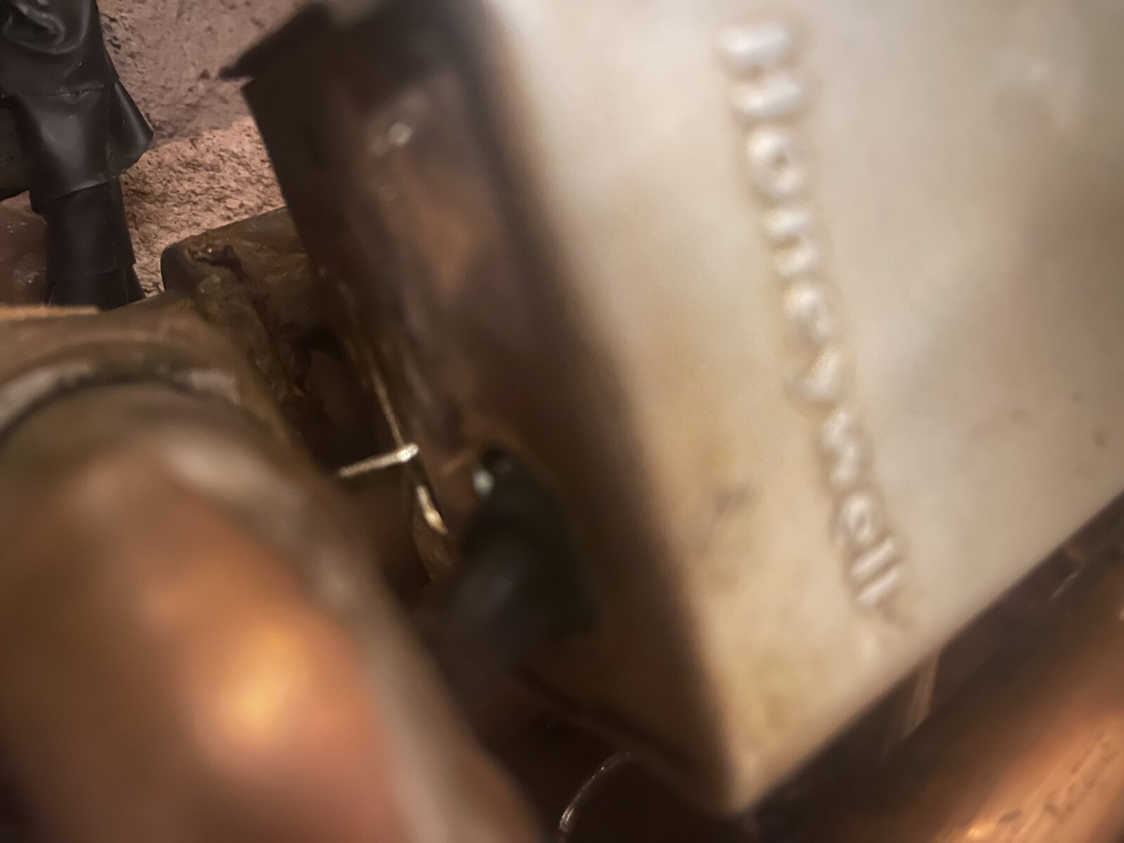

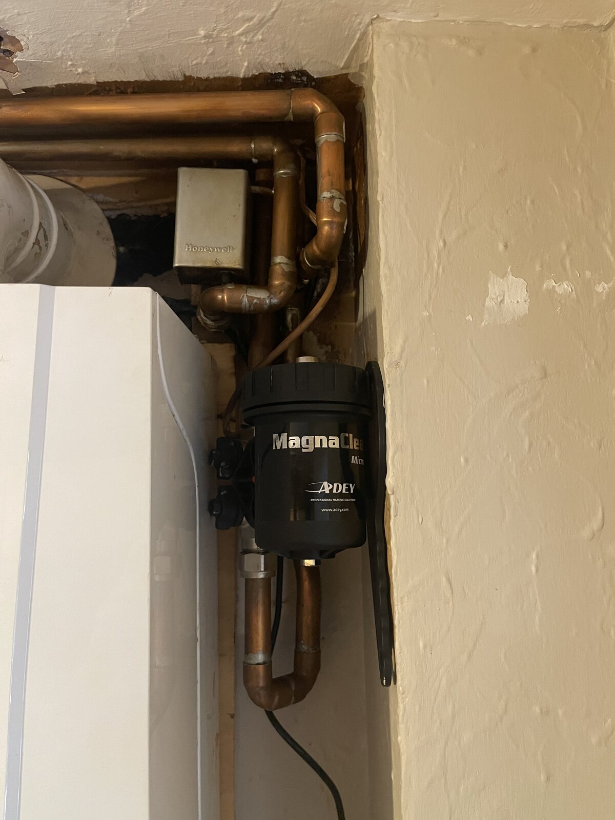

There’s a a Honeywell valve thing? As seen in the picture
