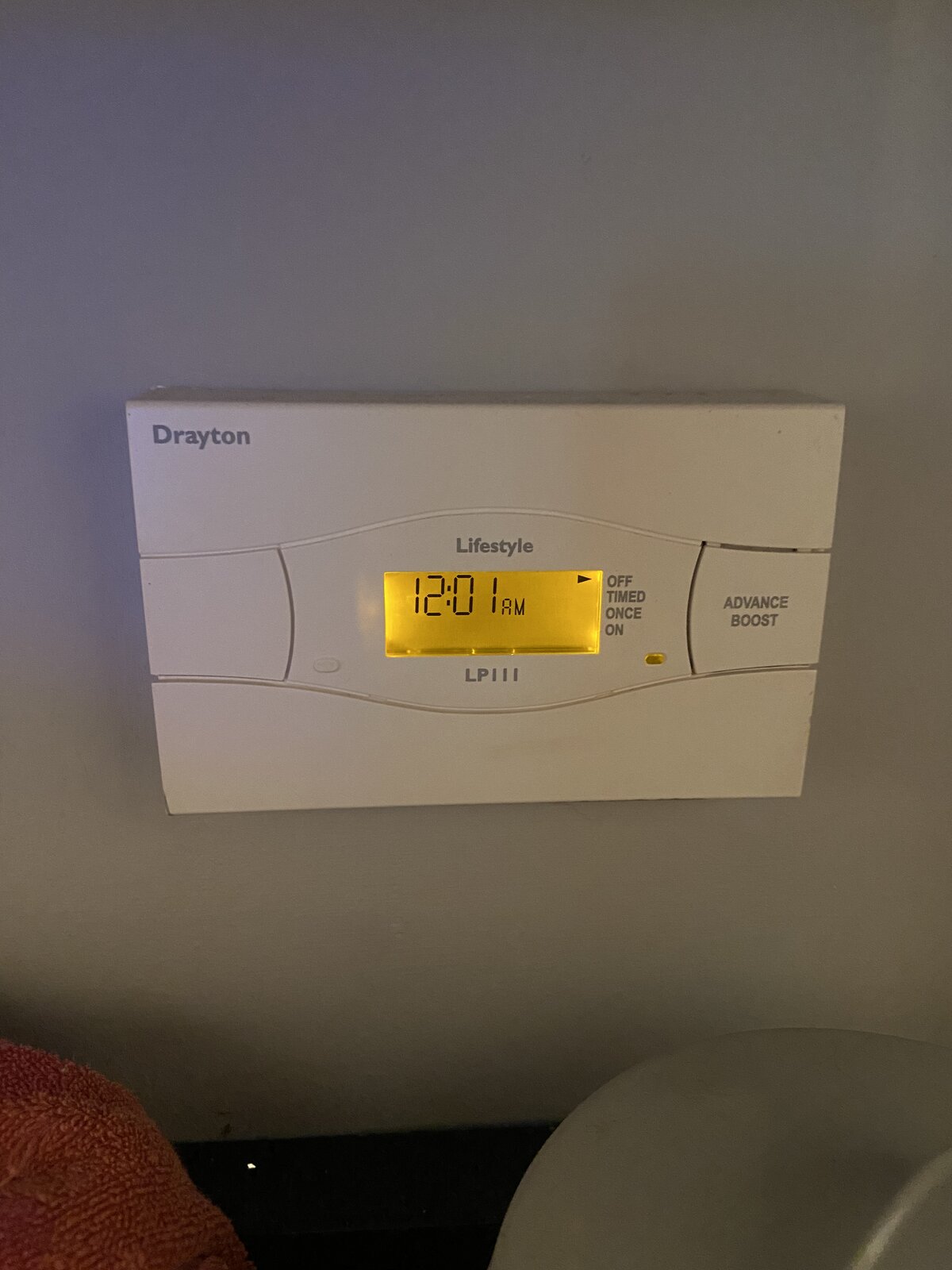

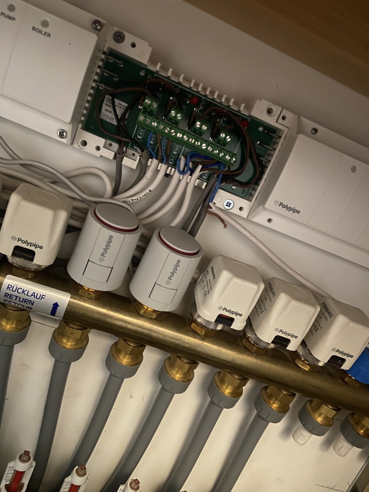

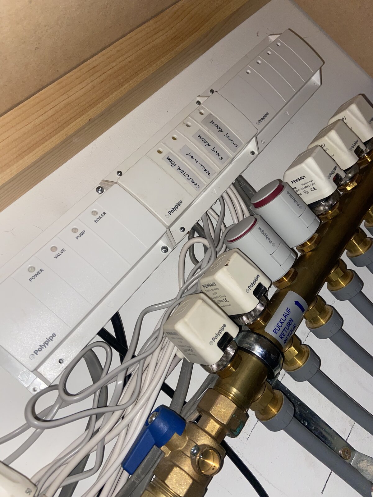

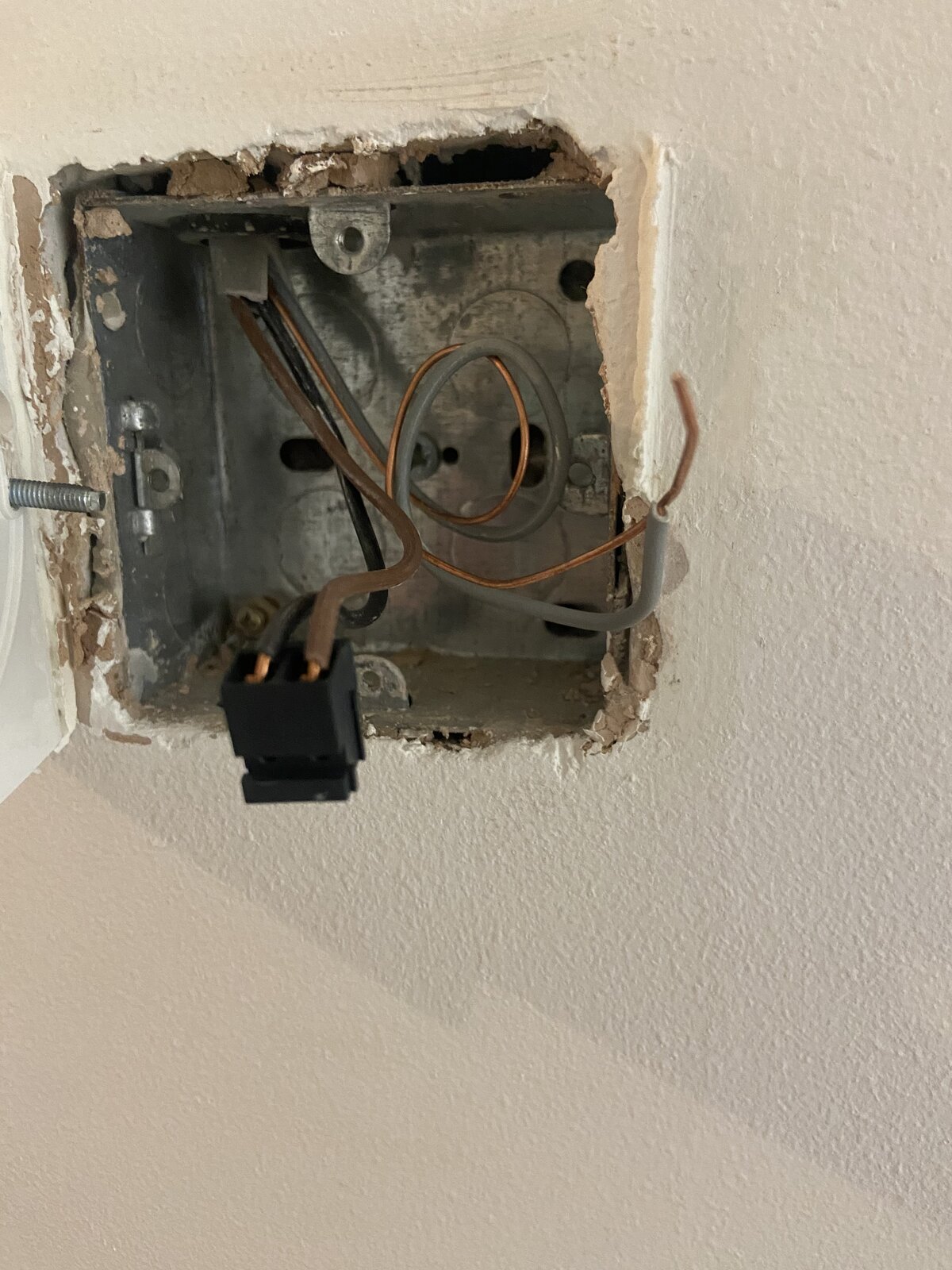

Hi I want to change these poly pipe room thermostats that control the ufh with hive ones so I can operate remotely. There are four thermostats controlling x7 zones. Each one has two wires attached and there is a spare wire is this something that could be easily done? Would I need to change the main Drayton unit as well tia Rick

If you really must install Hive devices there it can be done.
The Drayton programmer goes away
Hive receivers are installed at the location of the rest of the controls and wired into the wiring box there.
Wiring in the walls is irrelevant as Hive thermostats are battery powered.

The Hive thermostat is a wireless battery operated piece.
The mains powered Hive receivers are wired to the control unit.

Nothing, with Hive or similar it's totally redundant.

Hive don't do UFH controls. Nor, do I think can they do 4 individual zones as you would require to control the 7 loops in 4 rooms actuators you have (plus another for HW if it's not a combi).
You probably want to consider something like the Drayton Wiser system https://www.draytoncontrols.co.uk/p...r-heating/wiser-underfloor-heating-controller (or the Honeywell evoHome equivalent) where the UFH actuator wiring system is replaced and you have individual wireless battery thermostat units for each room.

The TRV (if one would fit the manifold valve thread, and operate the correct way) will control it according to the temperature in the manifold's location - not the room the loop is heating.
Rooms with two or more loops only need one room thermostat to switch all the associated actuators on/off.
If the objective is to just turn the system on or off remotely, then keep the existing thermostats, remove the programmer and replace with a Shelly1 or similar.
Cost about £20.
