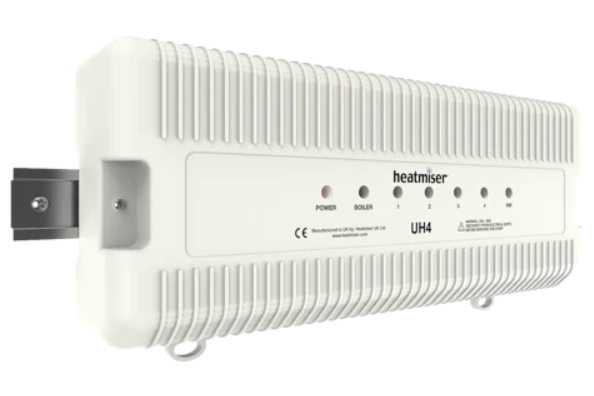

In the main a thermostat has a single pole relay, but we want it to do at least two functions, one open the valve, and two fire up the boiler, it may also need to start a pump, so what we need as a bank of relays to turn the single pole into multi-pole.
Units like this 1701738295403.png have the relays required, and it seems likely that is what your existing system does. One could design your own relay bank, but easier to use one ready made. The radiator system motorised valves have micro switches built in, these are not built into the UFH valves, and the TRV can have an electronic head which connects to the wall thermostat, again this is not as far as I am aware available for UFH.
In the main for UFH the problem is to avoid the hysteresis, some wall thermostats have very complex algorithms to get around the problem, Hive is a rather basic wall thermostat, so seems unlikely it will produce good results.

The UFH pump shouldn't need a manual switch on/off -- that should be automatically done by the Polypipe thermal actuator control box you pictured when there is demand from a zone: it has pump and boiler (call) lights on it!! It may need a timer on/off control if the existing stats don't support a set temp and lower set-back temp automatically.
Something like the Drayton Wiser 3 (to control 1st and 2nd floor radiators - add in smart wiser room TRVs if you want even more granular control) plus the Wiser UFH box and another 4 room stats to control the 7 actuators and four room zones would be one solution. It's possible some rewiring of the existing control systems may be needed.
