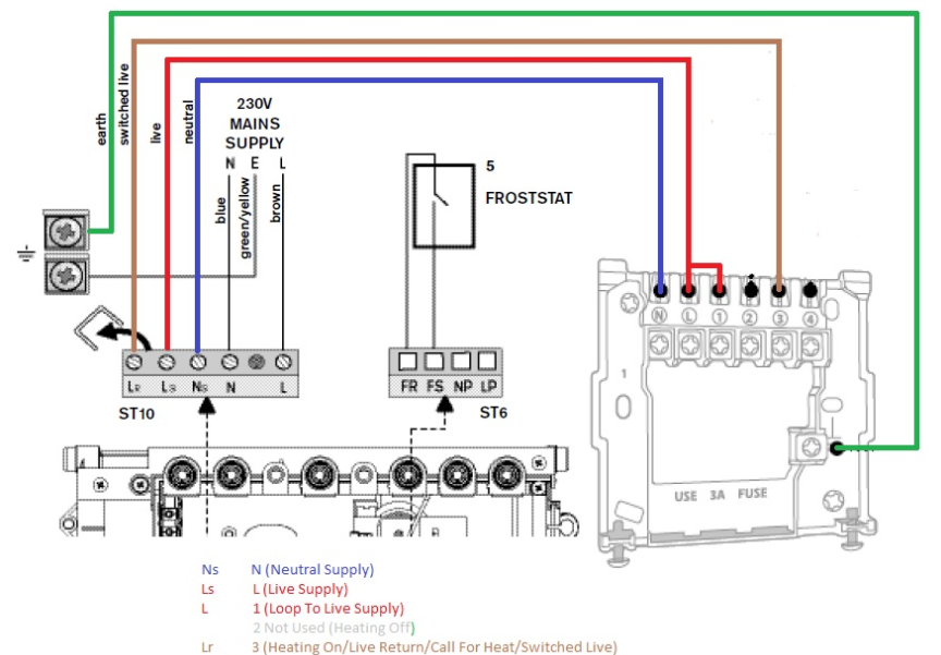

I have recently moved in with the Mrs(!) and bought my Hive kit with me. I used to have Hive v2 setup on a heating and hot water boiler with a duel channel receiver, the boiler at her house is a combi (Worcester Bosch Greenstar 37 CDI GC 37-406-08)
I called the Hive tech team and they very nicely sent me out a single receiver for free! Now it needs fitting so I wondered if you clever lot could help me out with the correct wiring. The wireless controls are internal on the new boiler so I need to wire in the backplate for the Hive receiver.
I found a similar diag on another thread and wondered if the wiring is the same, in a slightly different order?
Any help greatly appreciated!
