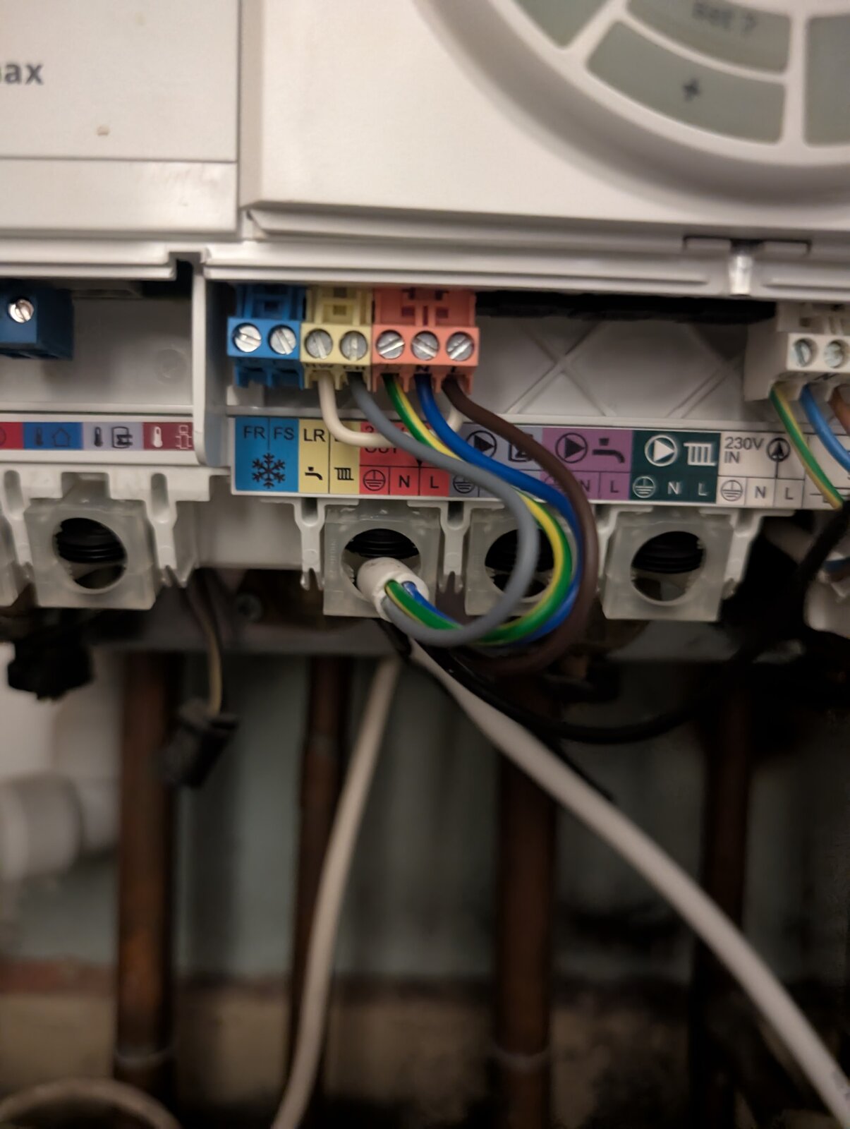

Wiring Hive on Worcester Bosch Greenstar 25 Si or 30 Si
Just thought I would share the wiring I used when I installed the single channel Hive receiver on a Greenstar 30Si boiler

One quick query the link between live and 1 on the hive backplate is not shown on any hive literature what is that achieving on the worcester is it replacing the link between LS and LR that worcester say to take out when fitting 3rd party controllers??
Its not a massive issue as if it does not need it on my 25si its quicker for him to take it out than fit one. ;)
Thanks Again
Ls is "Live supply" and Lr is "Live return". Not all boiler manufacturers provide the "live supply" terminal, so in that case, it is picked up from the Hive's main live terminal by adding the link between L & 1. As you have this feature and are running 4 wires excluding any earth (2 of which include a 230v for your L & N supply) then you don't need a link at the Hive.

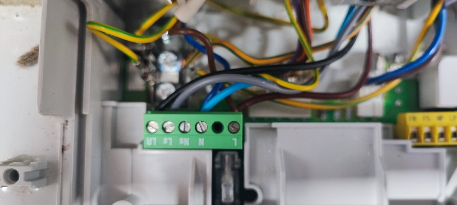

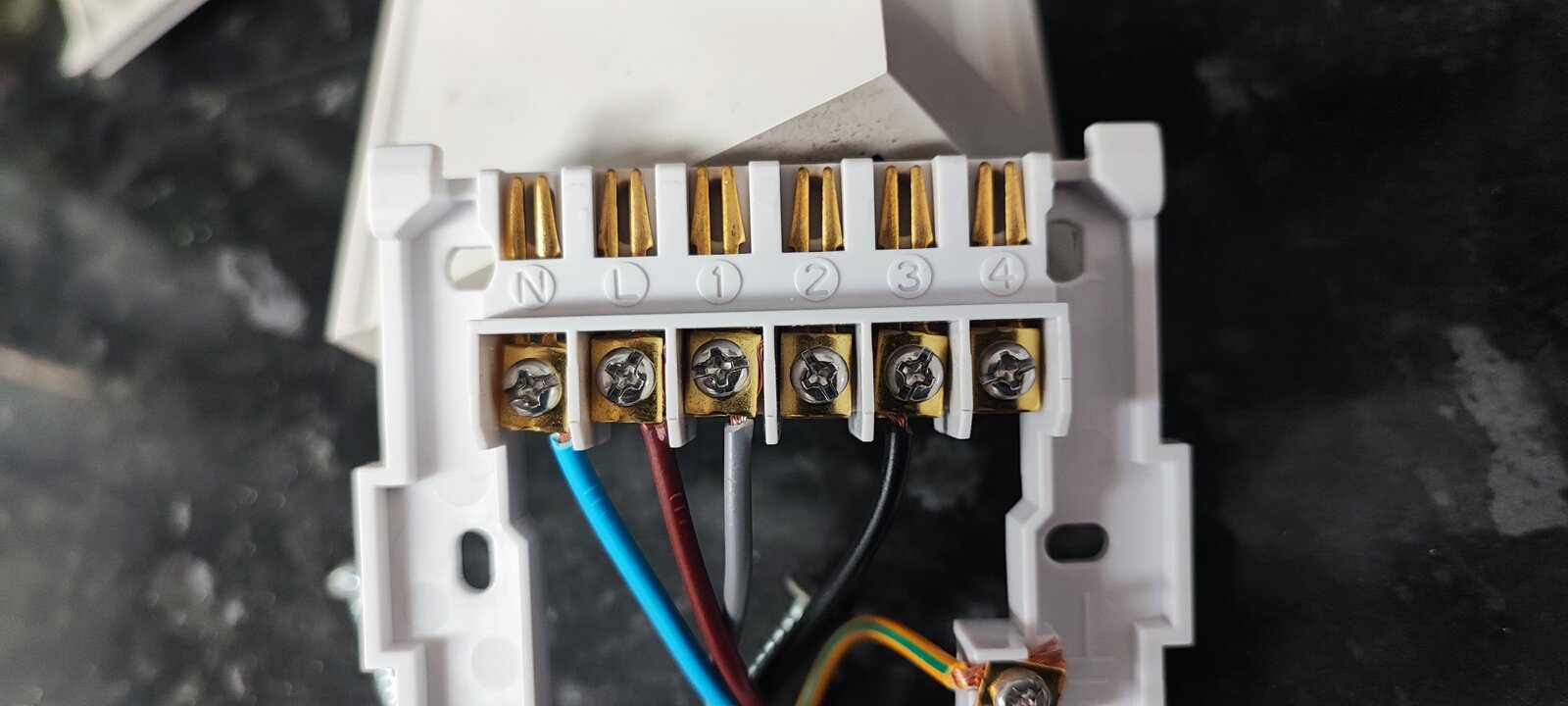

This wiring diagram didn't work for my 25si boiler using the new V3 hive single channel, so spoke to my mate who is a heating engineer and he walked me through the wiring over the phone.
I used 5 core cable. Neutral to neutral and live to live using the main feed from the boiler, so just adding into to what was already there. These are the terminals on right.
Then obviously earth to earth.
Then ran the
grey from LS(boiler) to 1(hive)
Black from LR(boiler) to 3(hive)
Nothing in NS(boiler)
Also with the boiler chassis still off ,take out the screw top left front of the timer face plate,slide up the bit of plastic, then slide up and out the timer unit and unplug the ribbon cable from the boiler side, not the back of the timer itself.
I then just fitted the timer unit back as it was, so it didn't look odd.
Hope this helps someone.
Cheers
Rob

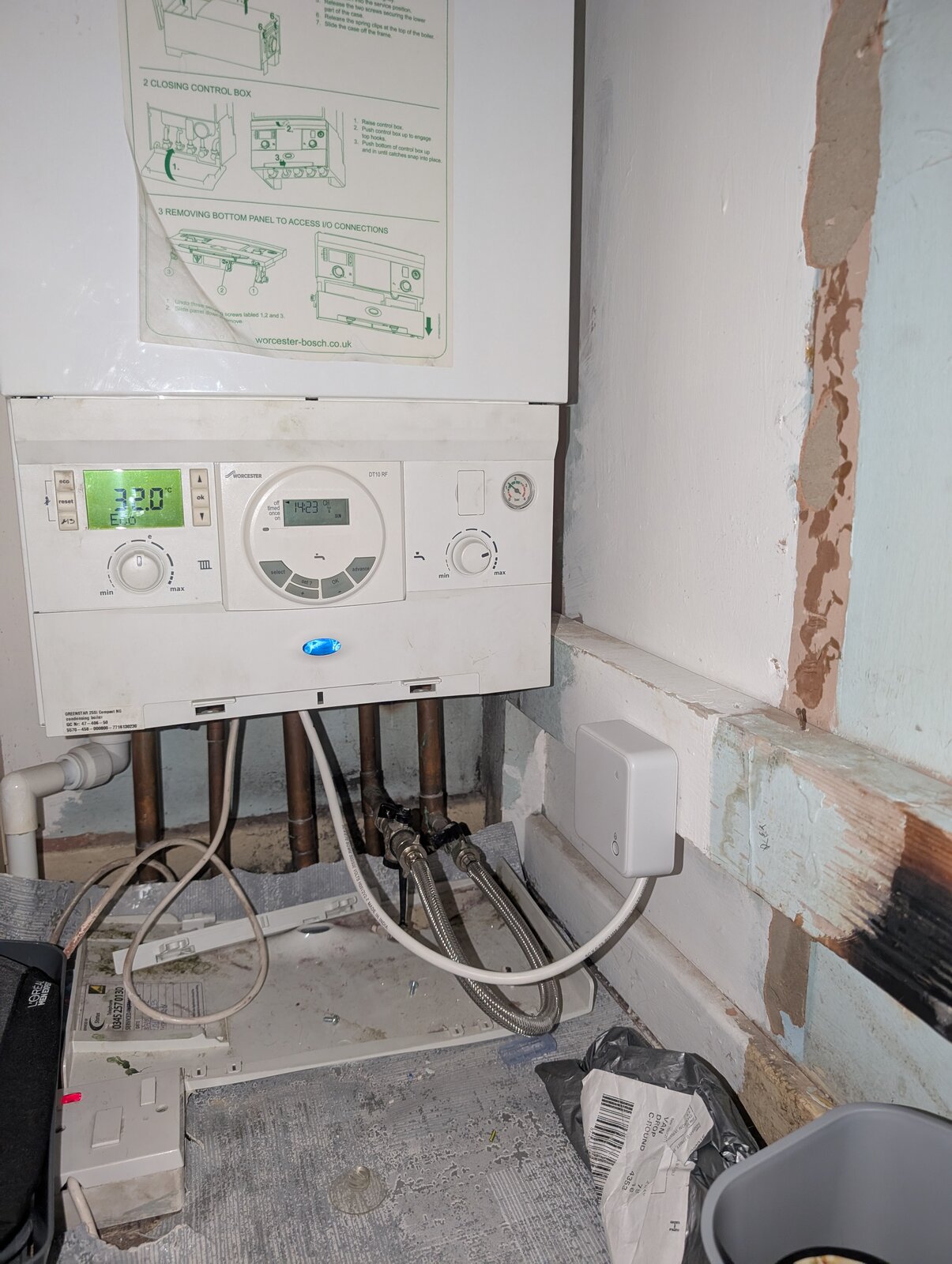

I have just installed a hive thermostat to a Greenstar 25si for a customer and they are saying the heating works at night but not during the day ? The scheduling is turned off on the hive app, any ideas ?

It's always best to start a new thread (and it's in the forum rules!).
The built in controls to the boiler are a DT10RF. This was (and is still, judging by the signal on the display) connected to a remote stat.
The controls on the DT10RF should be turned to permanently "ON", to allow the Hive to take over control.
It's possible that the Hive is working at Night, because the existing stat is also cold enough to be calling for heat.
Edit:
Sorry, having read further, the control on the DT10RF front panel is ONLY for hot water preheat.
For full control by the Hive, the DT10RF could be removed from the boiler - I am unsure if the socket where the ribbon cable comes out of would require a linking plug.
