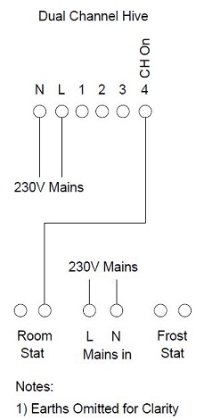

The N & L are straightforward. And then the switched live terminal from the boiler (that has one of the black wires in) goes to Hive terminal 4. They are the only 3 wires needed. No links required. The other room stat terminal remains empty as shown in the diagram from the Logic+ Combi manual below.
230V N&L Supply to Hive N&L
One wire from Dual Channel Hive terminal 4 goes to the room stat terminal as highlighted in Red, the other room stat terminal shown in Purple isn't connected as per the diagram from the manual.

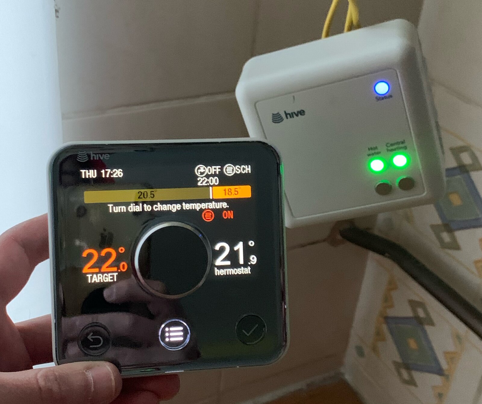

The only way it would have worked would be if the Dual Channel Hive was set to 'Gravity Operation' in which case, the Hot water terminal 3 is also made live when the heating terminal 4 is made live. It fools the Hive into switching the hot water terminal on whenever the heating is switched on.

You can tell if it is in gravity mode, the top light will be blue instead of green.
That is the only way it would have worked that I can think of.

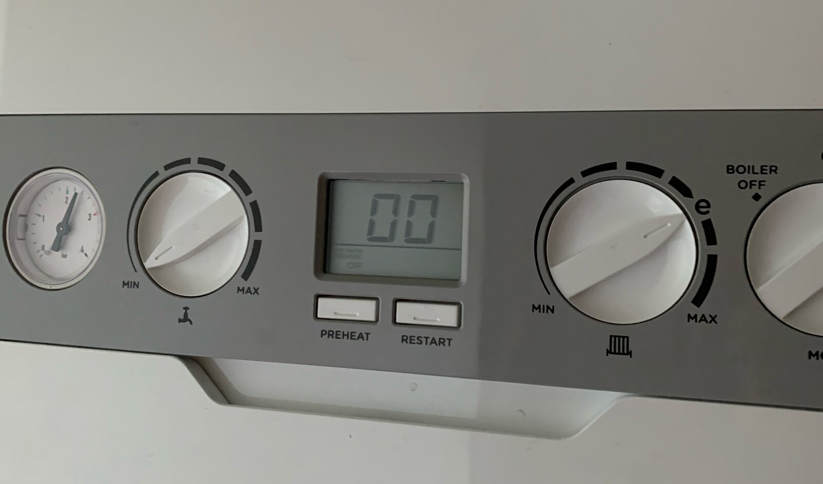

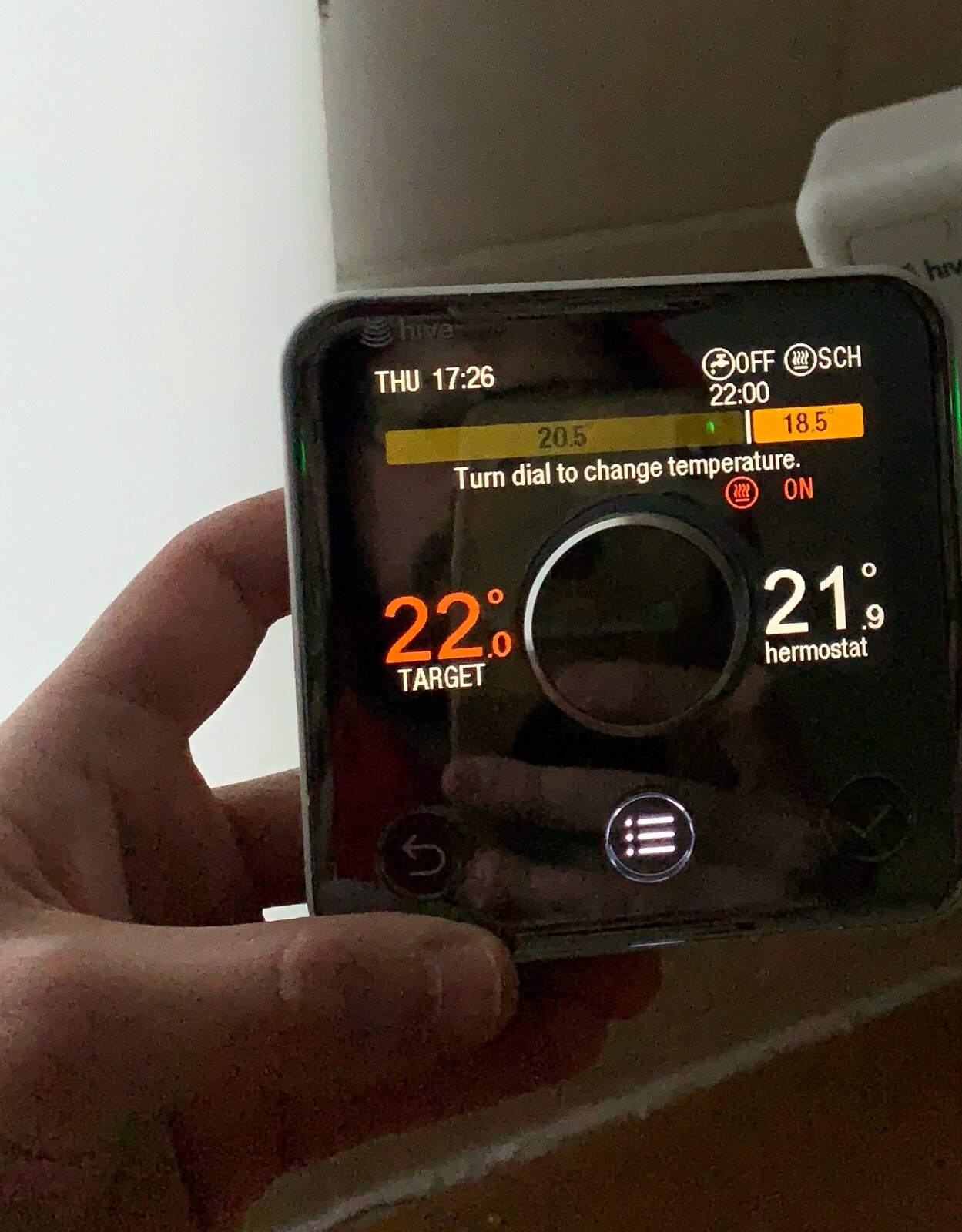

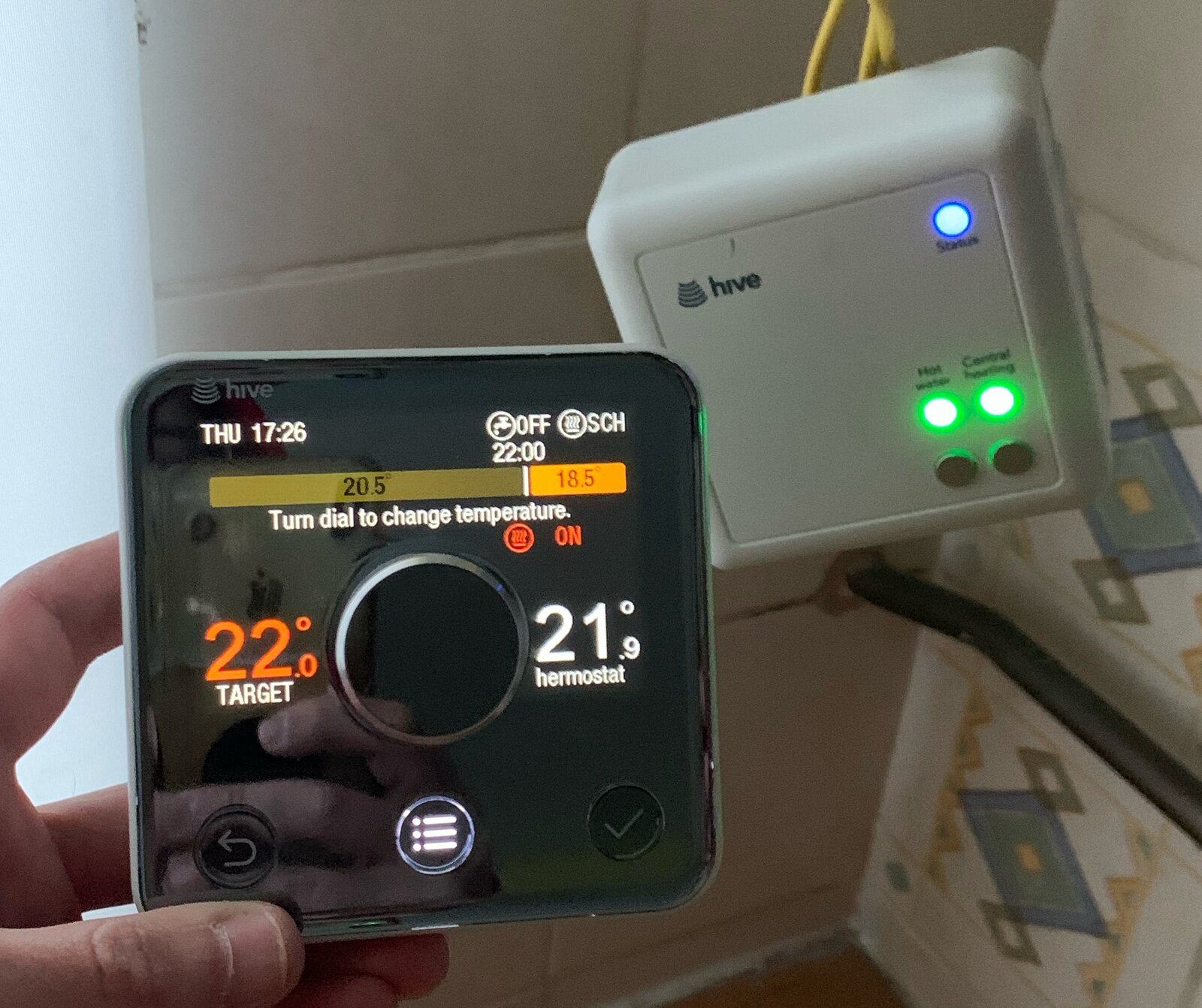

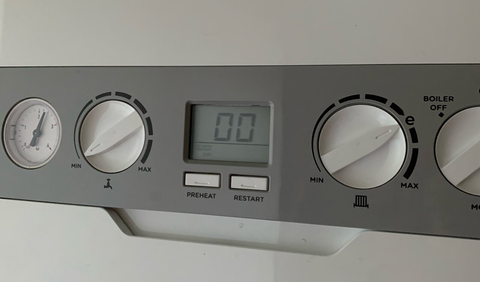

Receiver activates, but heating doesn't turn on. I am not sure how would it work with only one cable in the room stat.

you need to go into setup on the nest and set it to fully pumped it is set to gravity HW
Try moving the single wire in the room stat terminal to the other room stat terminal. I seem to think from memory the diagram in the manual might be wrong.
The room stat wiring has two connections, one is a live and the other a switched live. You don't need the live because that is provided from inside the Hive, as per the diagrams provided by @bernardgreen
Irritatingly Ideal don't label which is which for you.
