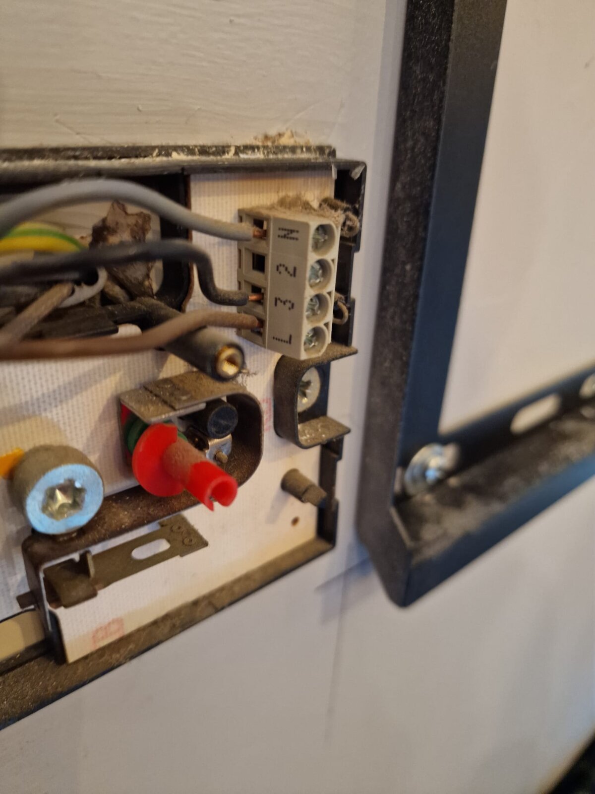

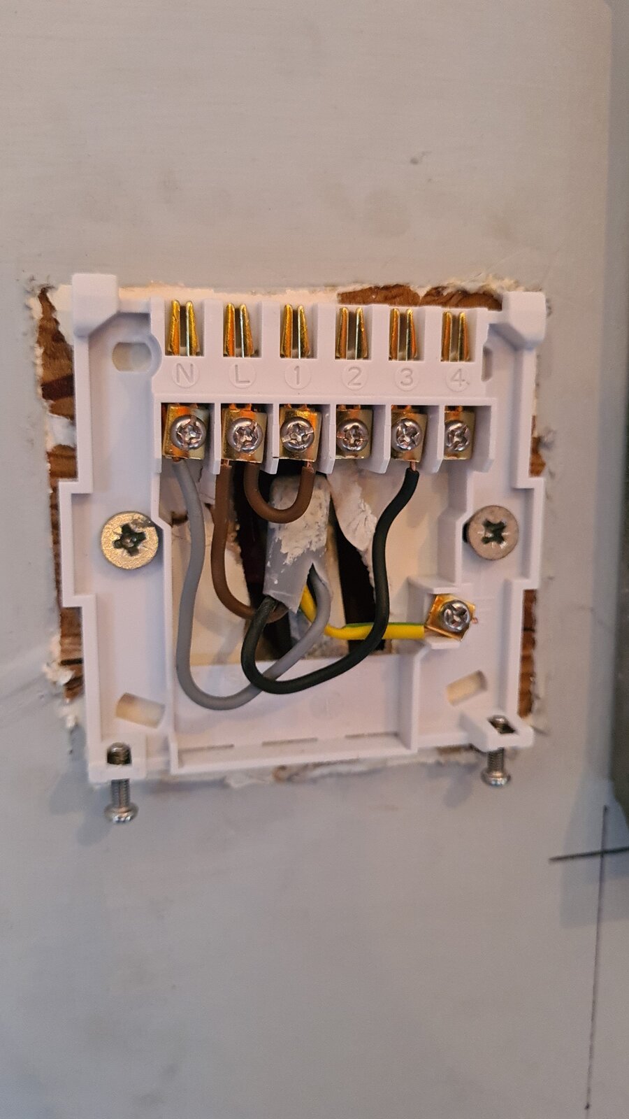

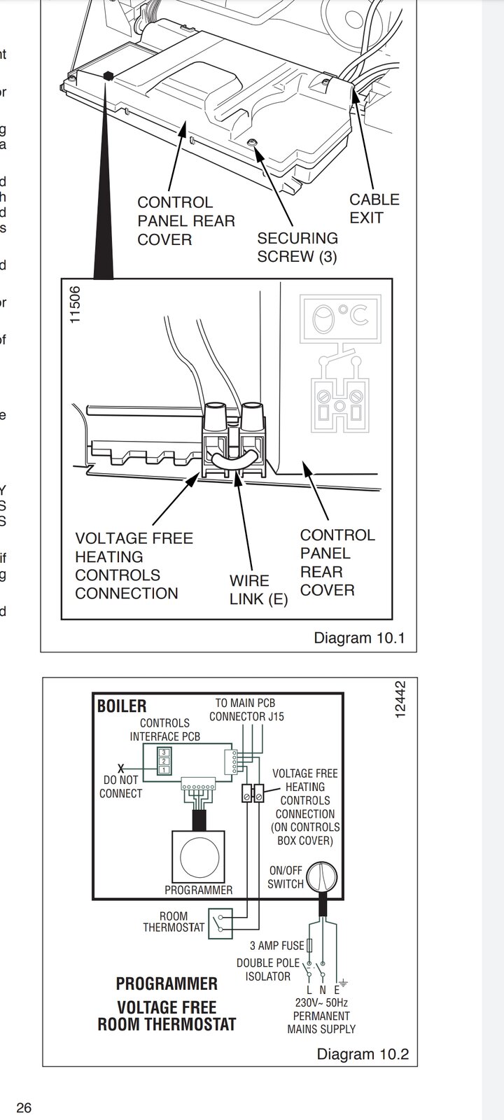

Hey everyone. So we have a Glow worm combi boiler and had a thermostat (honey well I believe) and it seems to have stopped working (boiler will just continue to run even when at tempreature). So we have bought a HIVE and trying to understand the wiring is beyond us! We have tried every combo possible and the thermostat for HIVE doesn't seem to be over riding the boiler still. So the boiler just keeps running even though the thermostat is switched off. Can anyone help? Thanks
