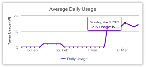

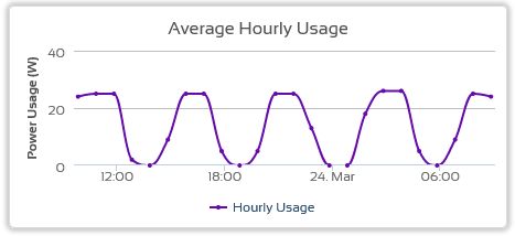

So by monitoring power used by heat plate
I know 25 watt when full on so if under 25 watt it is switching off/on so warm enough, but I do not watch the fermenter so it is hard to know if it over heats other than a zero power use.
It does not heat up fast, so set to 19°C with max of around 24°C before the brew becomes very bitter with an after taste, in the main it is OK, but only 100% method involves cooling.
However if it does over heat, then storing for a long time does improve the taste and get rid of a lot of the after taste. However what I want is set up and forget, I want to do the transfer, bottling etc when I have free time, not when the hydrometer says I should, and with the energy monitor I was able to check my brew even when in hospital. Not that I could have done anything if it went wrong.
