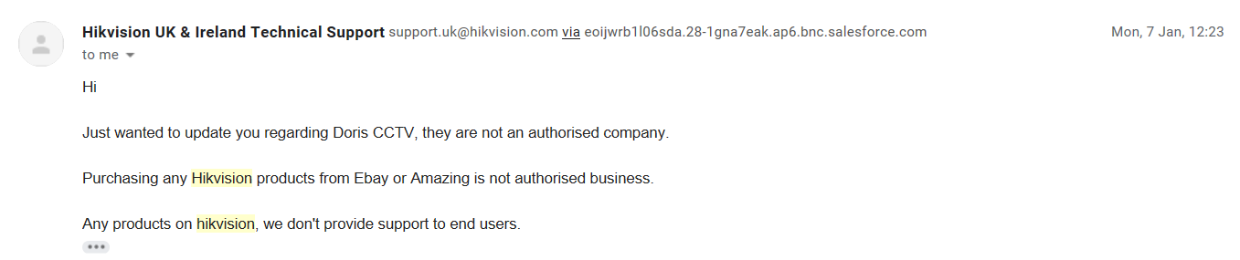

I actually contacted Hikvision to ask about a seller on eBay after reading here that they don't sell direct, here's their response:

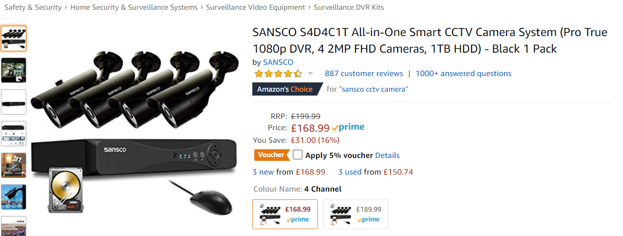

I am probably going to buy these soon - on Amazon, company looks like UK based, they are active on Facebook with support etc. so seems like a good cheap option. I know there's always a risk with self installing an unknown product, but the reviews are mostly OK and they do seem to provide real Uk based support.

Is £170 for a simple computer, HHD and a 4 cameras cheap?
My 6 camera setup was over £1000 for everything and that’s not even the really expensive end of the scale.
Yes it's cheap.
You're getting analog cameras with 2MP sensors (2MP is the lowest you can go with 1080P, so don't expect great quality). They will require power sources for each camera as well as the video cable routing, this adds time and effort to the install.
Do you trust this company to protect your privacy? They have their own software installed on it which you are going to give full access to your cameras and everything else on your home network. Will they issue security updates if vulnerabilities are found? Can you be sure there aren't backdoors in their software?

I went with a cheap setup first just under £300 and lasted me about 2 years. £170 is not a lot so worst case you will just need to replace it in a year or so. Maybe buy that and get yourself familiar with a CCTV system and save until it breaks then go for a really decent one. (y)
