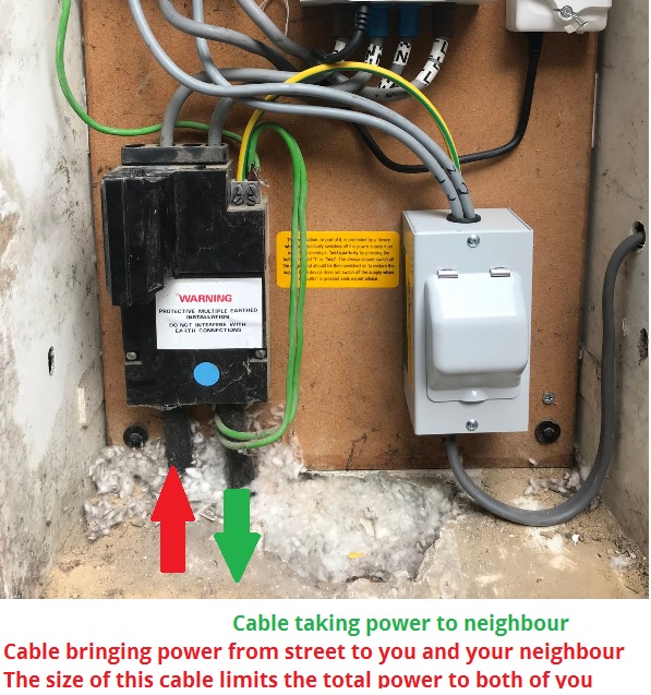

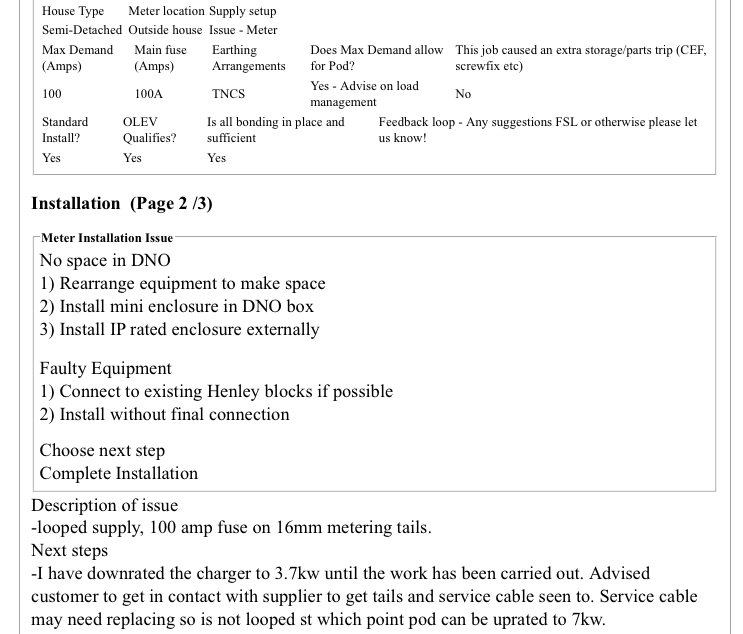

Just had a Pod Point home car charger installed. It was meant to be the 7kw (32a) version but the installer said my property has a ‘looped’ supply to it and that they could only allow operational charging at 3.7kw.
I have done some reading online but still a little unsure about a looped supply.
I called U.K. Power and the said they could take me out of the loop for a price. However other people I’ve seen online have had this done at the cost of the supply company???
Is there a difference?

To remove the loop will require a new supply cable from the street to your neighbour and maybe a new cable from street to your house.
As far as this is concerned
Because it states 100A on the carrier (this is the maximum rating) does not mean there is 100A fuse inside.
It could be 80A or even 60A, in either case your cables are fine.
Did they actually look inside?

So the loop only consists of 2 properties? Supply into mine which then goes on to my neighbours property to the

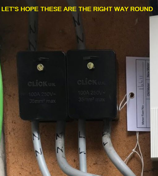

Thanks for this. So, if I understand correctly I have the supply coming in to my property and then my neighbour to the left is on a looped service from me(he only has one black cable going to the head???) or I am in a chain from the neighbour to my right aswell?? They also have 2 black cables going to their head.
Cheers
Both outgoing cables have 'N' for neutral on them - don't know why.
There may be nothing wrong but you or an electrician should make sure which ones are connecteed to L and N in your consumer unit.
Thanks,
It would seem not, the giveaway is the coloured sticker on the cable head, You have a blue one, to indicate you are on Blue phase, as does your neighbour to the left, The neighbour to the right has a yellow one, to indicate he is on yellow phase, and you'll probably find his other neighour has one cable and a yellow sticker. In most cases they'd stick to two looped supplies and not create daisy chains of them, although exceptions do exist. You are lucky that they actually bothered with teh coloured stickers though, and that they havn't been pulled off over the years
Not convinced that worrying that its a looped supply at this stage isn't a bit OTT, send in the form notifying the DNO of the car charger, and if they want to change it, they can, but in reaility I doubt it'll cause any problems in practice.

Not convinced that worrying that its a looped supply at this stage isn't a bit OTT, send in the form notifying the DNO of the car charger, and if they want to change it, they can, but in reality I doubt it'll cause any problems in practice.
I agree. I don't think the fact that the service is looped is, in itself, particularly relevant. What matters is the adequacy of the supply in relation to the OP's demand.
