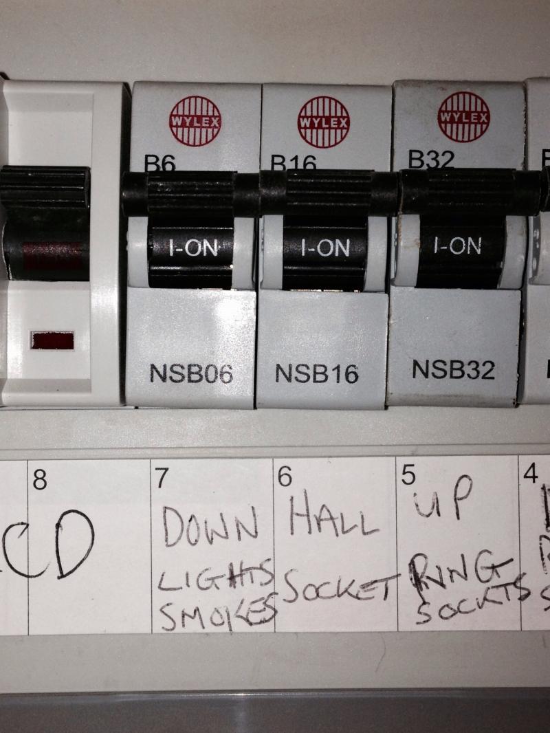

Home lighting- down lights circuit on RCD
I double checked wires, I will check again tomorrow. Why has it affected others though? (Hall, living room etc) because the kitchen is in between hall and utility. Kitchen works nowhere else downstairs does?

Lighting circuits are radial. That means the feed wires (both line and neutral) start at the consumer unit and hop from one light to the next.
eg
MCB > A > B > C > D > E
So, if there is a break in the wiring on the output side of light C, then A,B and C will work, but D and E will not.
I wired it exactly as it was previously, and I did the same for the kitchen ones...................
I'm just trying to get an understanding of how to rectify it and I want to cover all possibilities!
As you have power to the kitchen lights, that means you have a supply to that point, but you have no power to lights beyond that location.
So even though you have stated you have copied identical to previous set up, it seems you have introduced a problem that prevents either or both continuity of the live line or the neutral conductors. This will give you power loss to other lights on the circuit , the reasons why are straight forward, you have no contact at either or both line and neutral from either the kitchen or a nearby room.
There is no point starting at the consumer unit, unless the lighting circuit is spurred at the MCB for other parts of the circuit (this cannot be ruled out)
But I would suggest/recommend a first visit to the kitchen light.
You will be looking for loose/broken conductors or nipped insulation at live and neutral loops. You may even missed one out.
