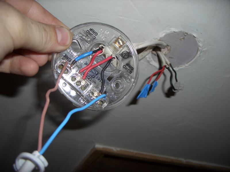

Well thanks for all the feedback my friend - I'll pop round his later with my new found knowledge and see what I can do
Everything is connected to a 3 switch wall socket?

All sorted now - It was a case of connecting the 2 remaining black wires together in a separate connection block then connecting 1 red into the loop and 1 into the neutral - and walaa - job done!
A red being used for neutral??? :confused:
I was just thinking that...
stop right now and figure out which wire is the switch wire and swap the other one round so that there is a red and black in the terminal block ( switched black and red to light ) and a black in the neutral..
live to switch ---Switch --- Switched live ---|--- Switched live to other light--- Light --- Neutral back to rose
