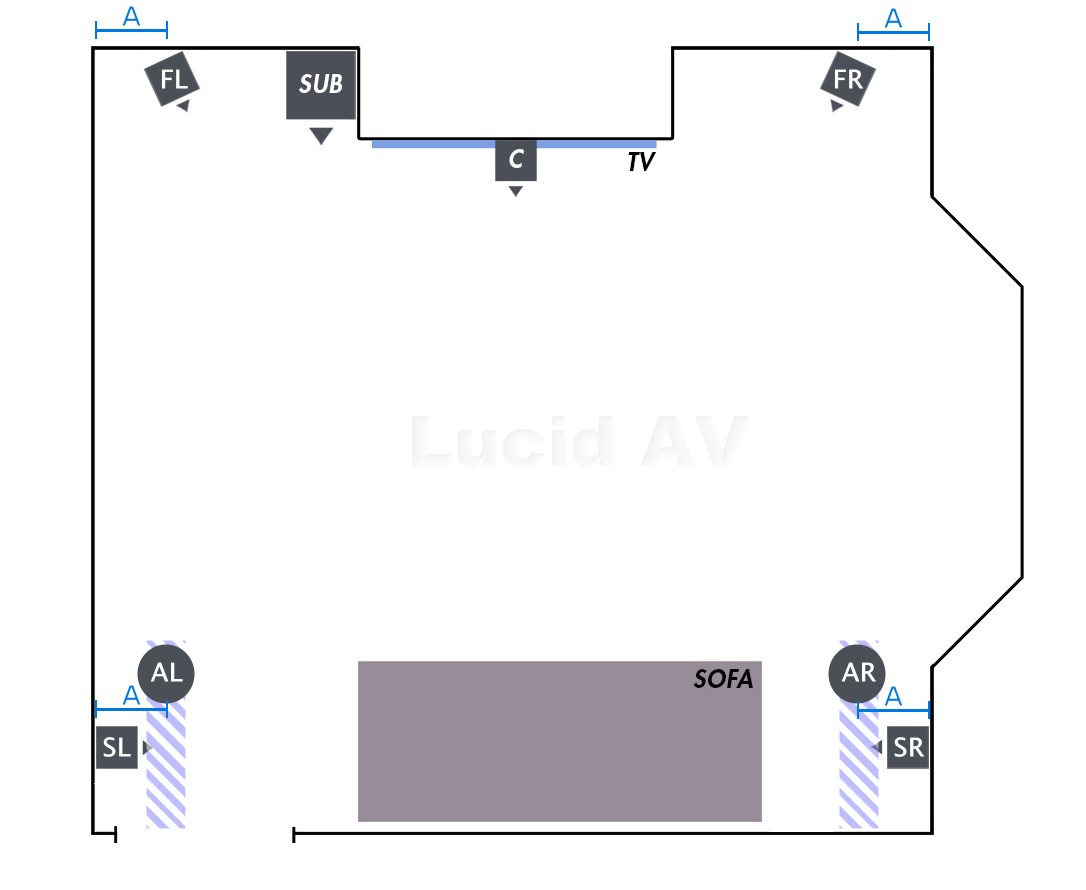

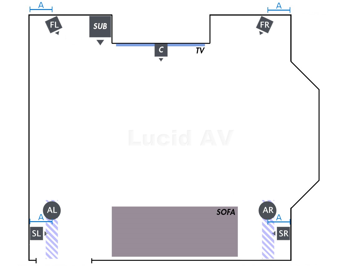

Heres my potential positions for the speakers (I think the Sub and Centre will be good where they are), I'm thinking of running wire for a future 5.1.2 ATMOS setup if that makes any difference (regards to the 5.1 part of the layout) Any feedback on which positions to go for would be greatly appreciated. Also it would be great to discuss about used gear so expect a PM shortly.
The room layout with the sofa against the back wall means you won't be able to get a pair of Atmos speakers overhead behind the sofa for a 5.1.4 or 7.1.4 layout. Unless moving the sofa forward is a possibility then your best option in that room is a 5.1.2 layout.
If the diagram is accurate then your seating is off centre; shifted right, but the rest of the room looks fairly symmetrical. The blue hatched area shows the permissible range for fitting the Atmos Left and Atmos Right in-ceilings.
Thanks for taking the time with that diagram, your are right the Sofa will only be slightly off centre not nearly as much as my diagram suggests. can I ask is the ''A'' value a specific distance, if not would there be an optimal distance from the wall.
