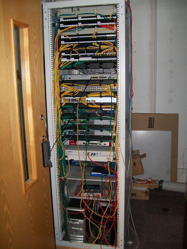

I'm just trying to get some ideas for how these things can be installed - I've never seen an installation in the flesh and it's a little difficult to picture what it may end up looking like.
Somewhat overkill for your needs, but this is how they are normally used in a commercial environment. They are indeed a pair of vertical rails, to which any manner of equipment bolts. This is one I am responsible for, which is why it's reasonably neat.

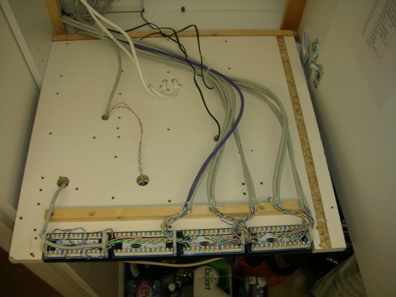

However, this is more like how you can expect to find them when done by clueless <insert derogatory term of abuse> who don't give a <expletive>
Just an observation, but the cables are badly terminated - though I've seen a LOT worse :rolleyes: There should be hardly any stripped back sheath so the pairs retain their closeness right up to the connector, and then there should be no more untwisted pair than is required to terminate each one. I;ve seen people strip back and untwist a foot or more :eek: To put things in perspective, IIRC Cat5e is supposed to be rated up to something like 250MHz, and at that frequency the wavelength is under 1 m (wavelength in free space is 1.2m, and the NVP* of this type of cable tends to be around 0.7c). For good signalling, it's essential to avoid, as far as is possible, any changes to the mechanical arrangement of the pairs as that affects the impedance and causes degradation in the signals being carried.
* NVP = Nominal Velocity of Propagation, the speed at which a signal travels in the cable, and I believe it's typically in the order of 0.7 x the speed of light in a vacuum(c).
Hmm Not heard of that before. I can't see how the small imbalance between pairs of unsheathed 4-pair in the photo could degrade the signals. Of course the characteristic impedance of the individual pairs could be affected if the pairs are separated but that would have to be far worse than you see in the photo. Small compared with the impedance changes caused by the terminations to the sockets.
Indeed. And if you look closely you'll see that I've maintained the integrity of pairs up to the terminations.

These photos are from a job I did last year. In the back you can see how I fan out the cables and they are individually secured to the panel. If you look closely, you'll see a couple of cables that didn't have enough length - thanks the the clueless ******* of a so called electrician who didn't understand the idea of leaving sufficient length. Can't name names, but if I ever have to work with them again I'll be bumping up the cost to suit.
And this is the front when termination was almost complete. Unfortunately, the manufacturer modified the panels a few years ago, the connectors used to slot in to a complete panel from above, now they use a two part panel where the connectors slot in from the front - which makes it a LOT harder to add connectors to a panel that's in use.
