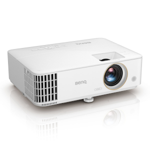

I'm thinking about this one, although touted as a gaming model, also rates well for movies and general viewing.

One aimed at gamers is not going to be as nice as one aimed at home cinema. Its also 1080p not 4k. A bit more budget and you are in to 4k.

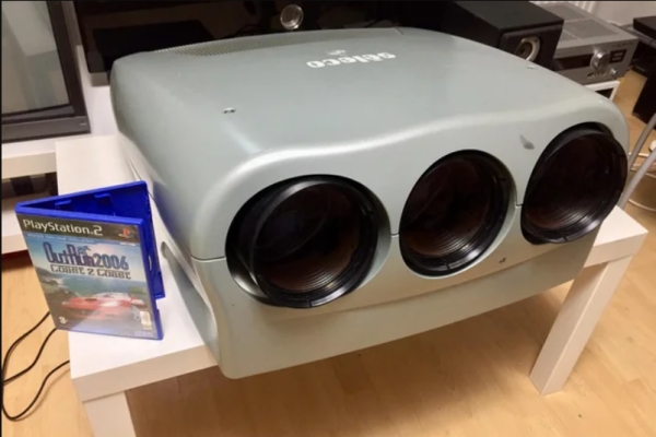

One of the firms I used to work for was the UK's biggest supplier of CRT projectors to the leisure market installer trade. This was mostly driven by football and the pubs market. I mention this because it highlights why manufacturer figures on brightness should be taken with a pinch of salt.
Measured in the same way as today's digitals, these old CRTs put out around 160-190 ANSI lumens. That was enough to get a decent image on a 72" diagonal screen in a typical pub during the day. There were a couple of caveats; you couldn't have any daylight falling directly on the screen, and you'd want to switch off any electric lights that were hitting the screen too. Other than that they worked well even if most of the installers couldn't converge for toffee.
Image: Seleco SVP350 CRT

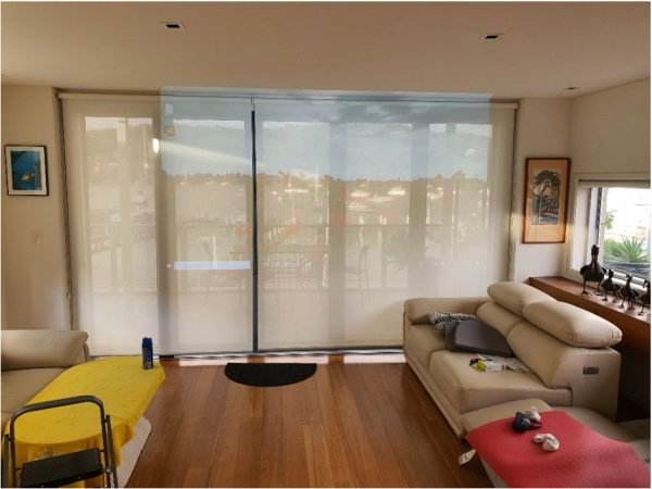

Contrast that with todays budget gaming/entertainment projectors with claimed brightnesses of 3000-4000 ANSI lumens. You'd think there'd be no contest.
Image: Benq TH585 - gadgetguy.com review
The image is a little unfair. He's obviously projecting onto the window blinds which are somewhat translucent (you can see the boats through the windows) and there's also some sunlight falling on the image from the window to the right of the shot.
The point here is threefold.
1) Manufacturer brightness figures are a bit of a con, but they're all involved in the same 'arms race' to quote big numbers because that's all consumers have to go off
2) Don't sweat a difference of a few hundred ANSI lumens between models. It won't make a significant difference
3) Daytime projection in the same way you might use a TV just isn't going to happen no matter what the manufacturers claim. However, with a sympathetic setup then you can project during the day. Just avoid natural light falling directly on the screen. The sun trumps any projector
You can read the rest of the gadgetguy review here. It's pretty useful. https://www.gadgetguy.com.au/benq-th585-2020-home-entertainment-projector/

If you're in Fife then RicherSounds at Edinburgh might be worth contacting. See if they can set up a demo of the Benq (£629) versus the Optoma HD29He (£749). If gaming is really important to you then the Optoma manages 8ms in 1080 SDR mode. It also supports 120Hz frame rate. Better blacks. Good motion.

Great post and advice, thanks. Tbh gaming isn't that important to me, so as someone else touched on, the Benq I linked to maybe isn't the one to go for. Yeah I'd read about stated vs actual brightness performance, reminds me a bit of stated vs actual vehicle mpg ;)
