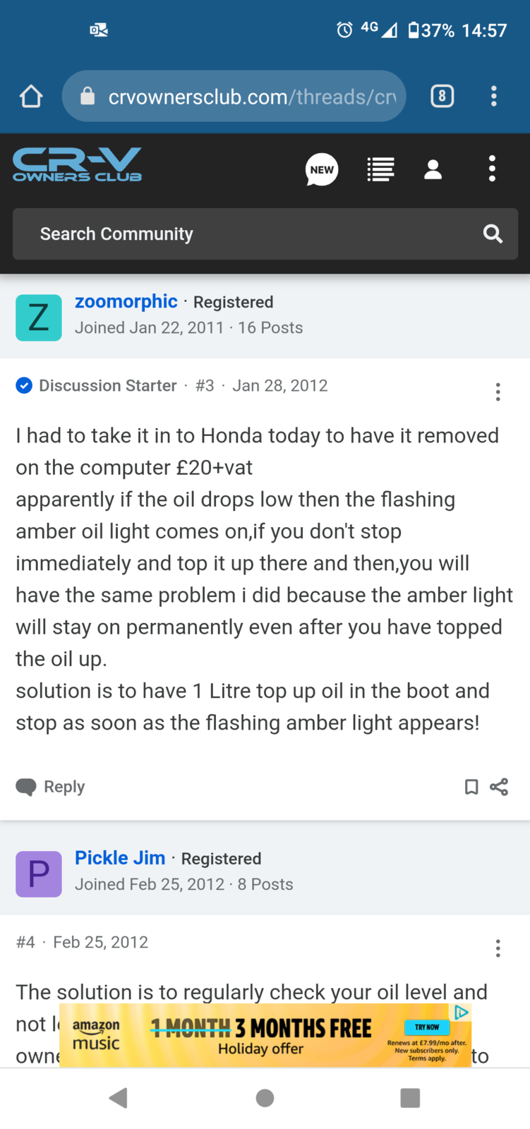

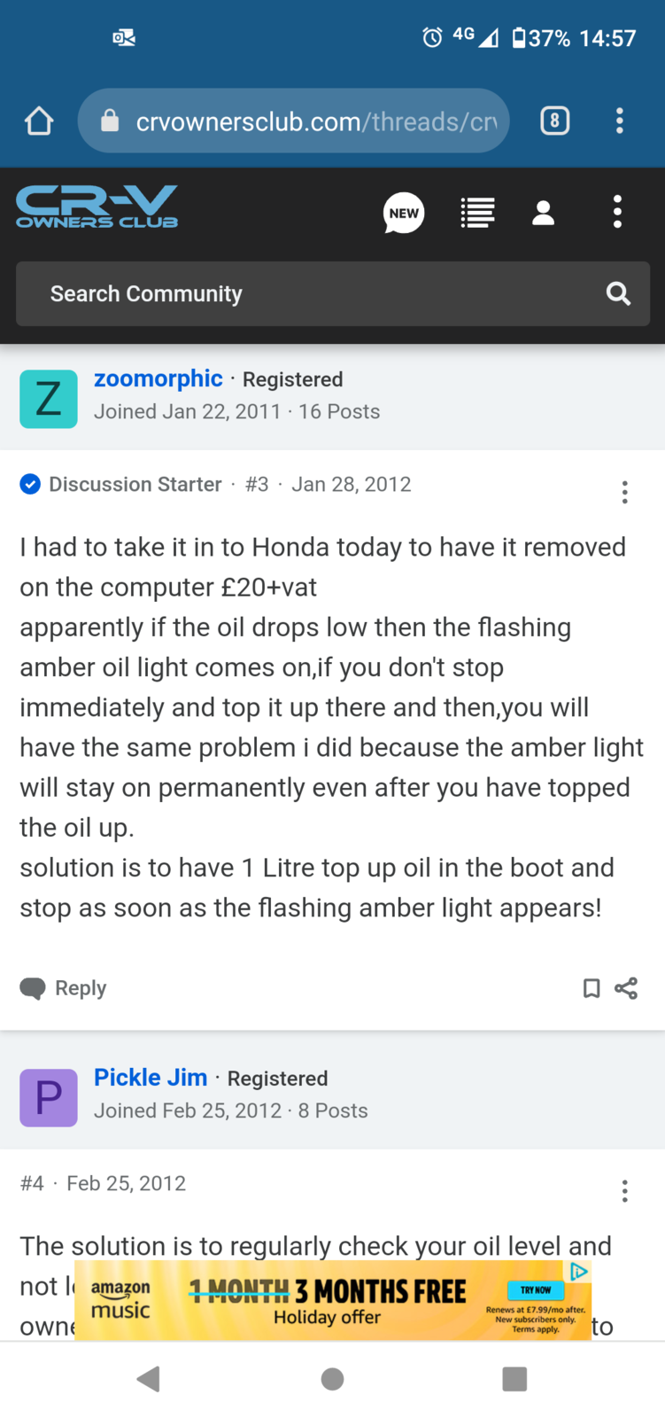

Quick 10 second Google search:
I had low oil in the past and still not flashing amber oil light came out. Stopped put a bit of oil and issue went away. This time the flashing light came out from the start not during travelling. Don't think is same thing unfortunately.
