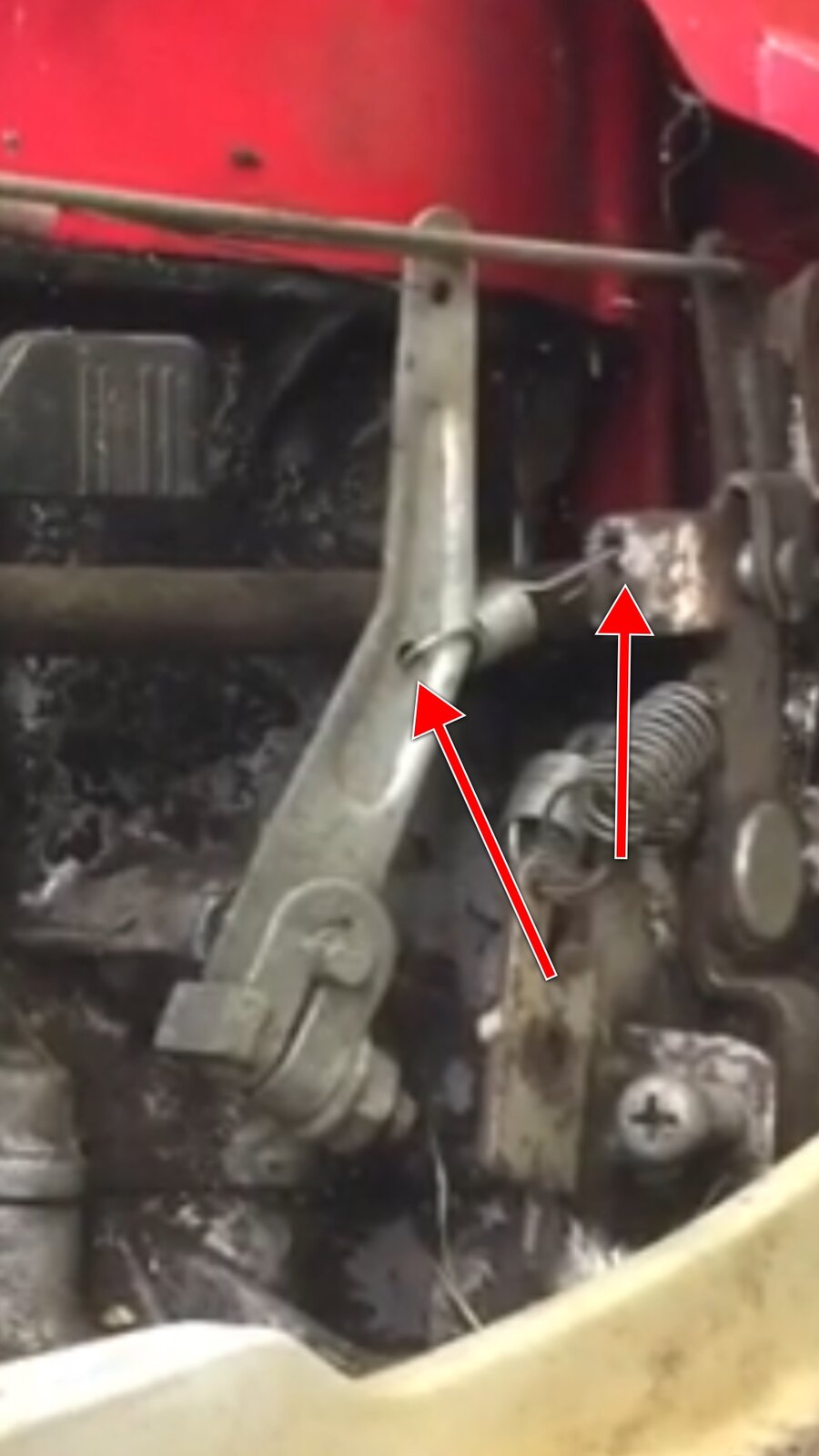

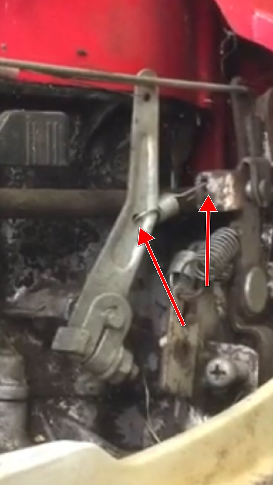

My neighbour had a crankshaft replaced in his mower & asked me if I could assemble the engine back in the deck & all the cables etc.
I’ve now completed it but stuck on one thing.
I’ve supplied some photos for you.
Whoever took the engine out to be sent away took the lever / bar off the shaft which comes out of the side of the engine. Photos of the item in question shown in photos.
I’m not sure what position this lever / bar should be before I do the nut & bolt up.
Also I have a spring left over & not sure where it goes.
I do see a hole in the middle of this bar / lever and the bracket to the right has 3 holes in it so this is where I think it connects BUT with the spring fitted theres no effort used to stretch it over & connect into the hole hence why it falls off all the time.

Welcome to the fastest revving side valve engine of all time!
The rod coming out from the side of the engine bears onto the governor inside the crankcase and ideally this should have been left alone - there’s no need to disconnect this to replace the crankshaft.
You’ll just have to experiment, I’m afraid unless you can get hold of an exploded diagram but try slackening the pinch bolt on the arm, and then turning the rod until it connects with the governor inside - tighten the pinch bolt and the arm should be free to pivot.
Best get the engine to start, and see if the governor works I think - unless you want to split the crankcase open.

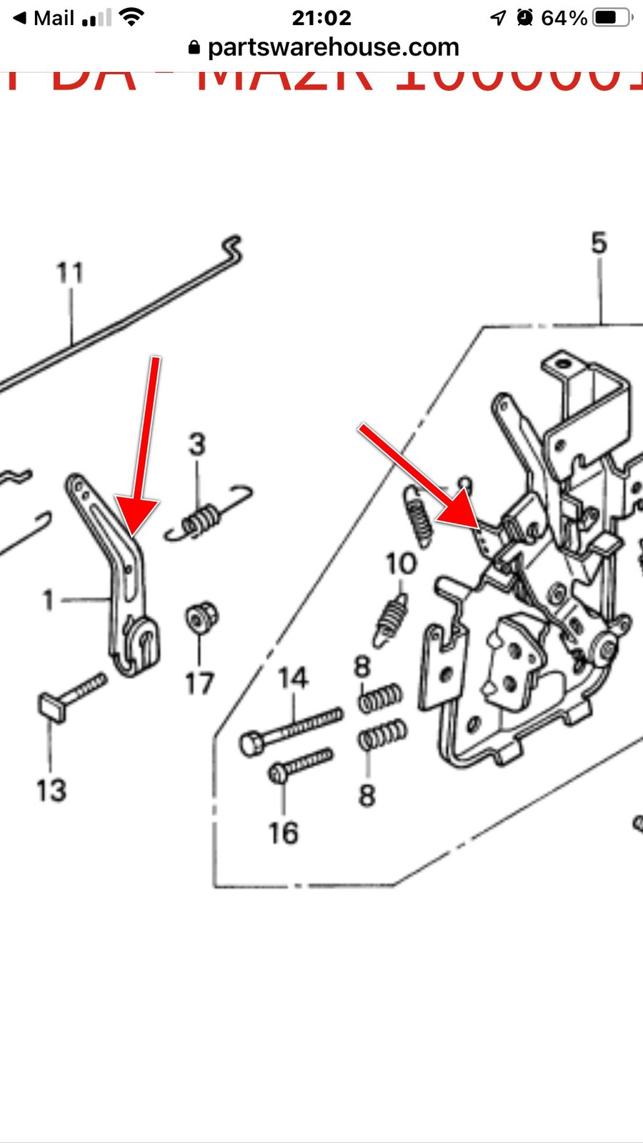

I did yes.
In the attached photo the other place I can see where it’s possible to fit is as shown.
But I have two issues.
1, The distance between the two point is less than the spring. So the spring falls off each time.
2, The rod that comes out of the engine is now back inside the case.
The rod that comes out the engine I assume should have a hole in it & the clip passes through the hole. Well I think the person who put the crank in just put the clip over the shaft & not through the hole. I say that because when I was pushing the bar back into the shaft it pushed the shaft back into the case.

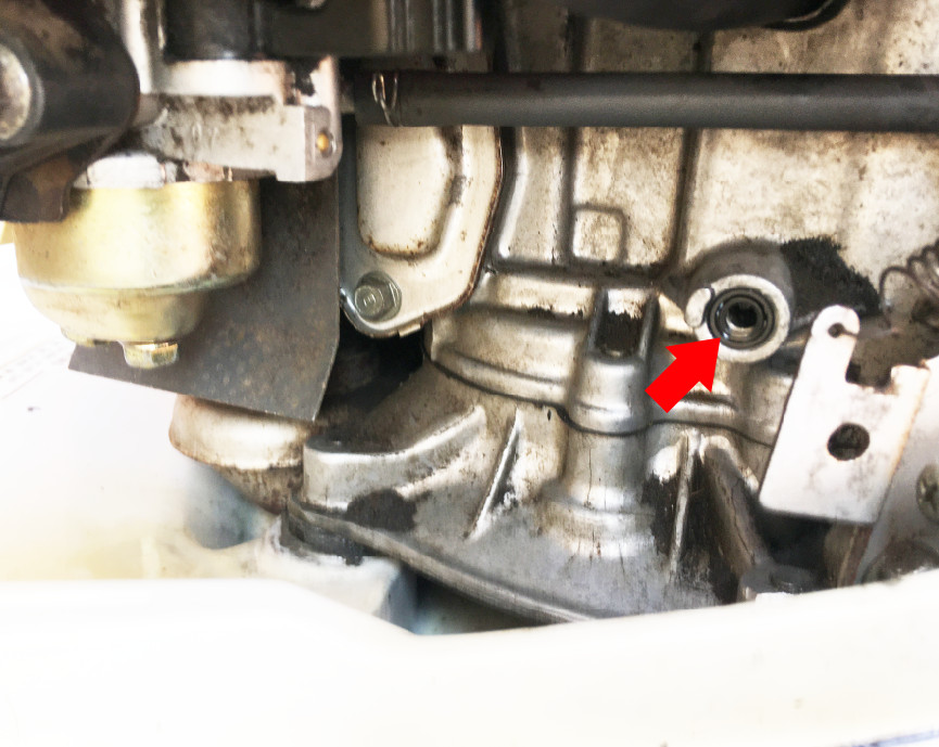

Attached is a photo of the issue i have in that the rod has now gone back inside the case.
I understand i have to remove the engine again but is it then just a simple job like remove the lower part of 6the engine ?
I need to push the rod back through & secure it with the clip.
Basically im not sure what to expect if / when the engine case is opened

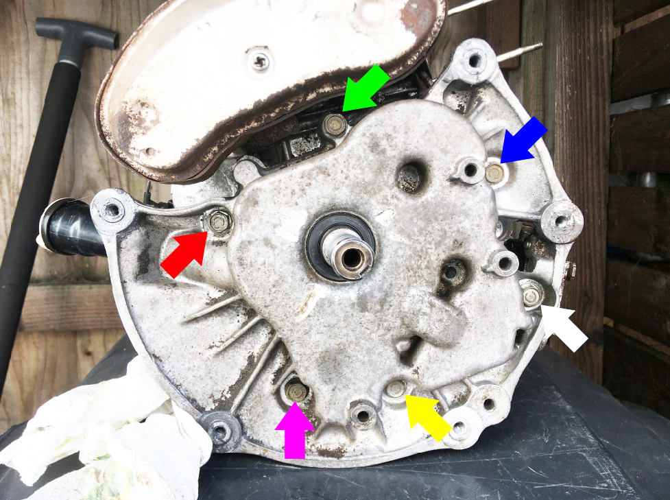

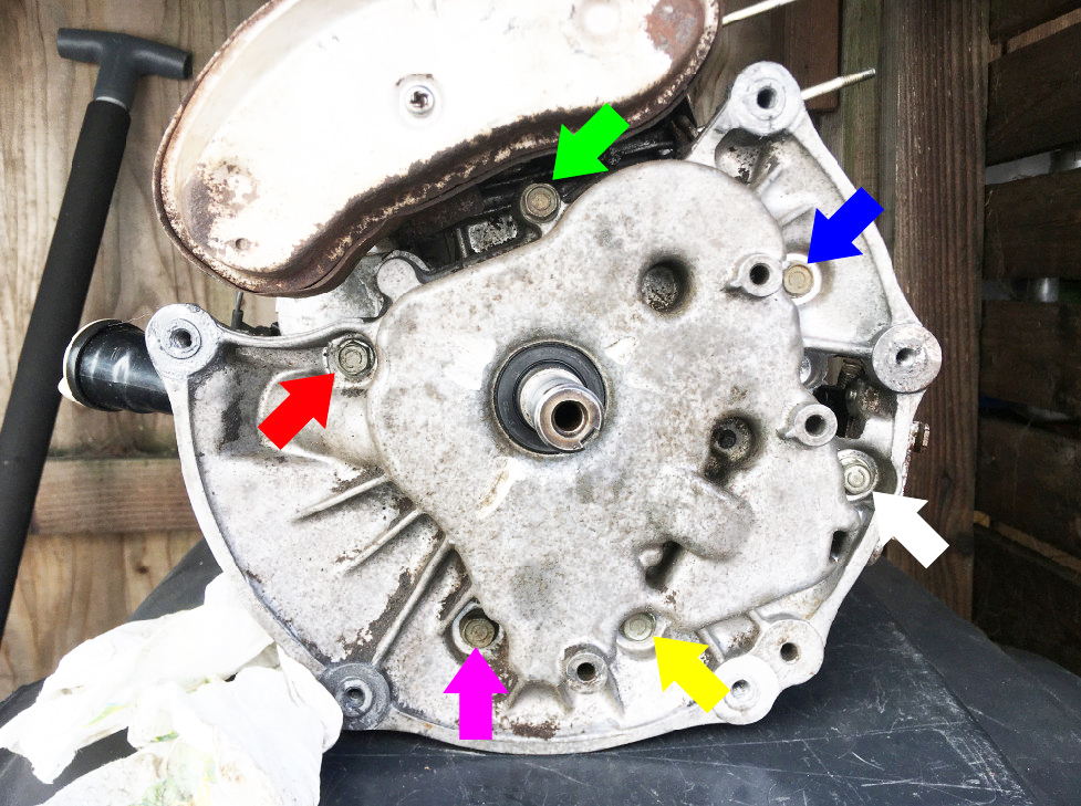

Ive now removed the engine.
Photo attached of the underside of it.
I see 6 x 10 mm bolts of which ive coloured different.
If i undo the 6 bolts & slide the cover off the crank will i then be able to push the governer rod back through the casing of will i bee expecting a gear etc to fall out ?
Shift those bolts and remove the casting.....make sure there are no burrs on the crankshaft end and keyway that could potentially damage the oil seal.
Nothing else should come away, if the camshaft drops out there is a centre punch mark that aligns with the crankshaft.
All else should be straight forward, I think but I leave some clearance between governor and rod....just a bit.
John :)
