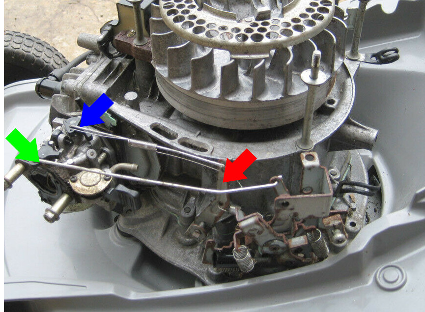

Ive now removed air filter to see what we have.
Here is a short video clip.
As you can see when i operate the throttle lever sonthing moves at all on the carb.
Please advise what i need to do in order to set up the throttle cable so we can start to fix this.

In my attached photo i assume the RED arrow is the vertical arm you meantion correct ?
There are two flaps on the carb.
If i move the throttle lever i see nothing happen but if i push it past HI to the CHOKE the i see the GREEN arrow move

Yes, red is the vertical arm of the governor.
It must be free to move......it controls the throttle butterfly in the carb. (Blue).
If it doesn’t move, it’s either fouling against the governor inside the engine, or the rod from the governor rod to the carb isn’t connected correctly.
I would slacken the pinch bolt and see if the arm moves then.
John :)
Ive now undone that pinch bolt to move the arm a touch.
Now done it up again & now i can move the vertical arm.
Moving the throttle lever from LO to HIGH stil does nothing BUT stil if i move past HIGH to CHOKE that still works
When you move the red arm by hand, does the carb butterfly move too? If yes, the linkage is correct.
I’d guess the entire movement of the red arm is in the region of 20 degrees, not much more.
When you move to full throttle on the handlebar, the red lever needs to pull full throttle on the carb.
John :)
Does the lever, red arrow move easily by hand, not by throttle lever, forward and back and move the butterfly lever from fully open to fully closed?
It looks to me as if the governor shaft is locked too far anticlockwise , try setting so the flat on the shaft is nearer to 90° to the lower part of the lever arm
Now being able to move that lever i have throttle & i think its now fixed.
