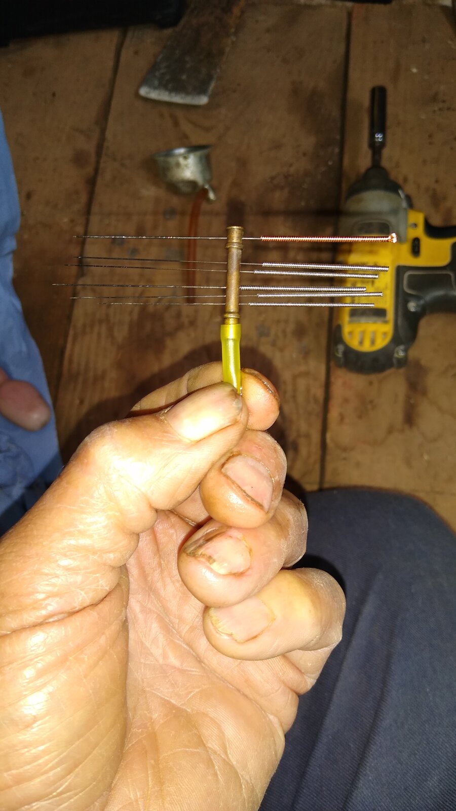

It's 4 pairs maybe more (8 large i think), plus the associated lower smaller holes below.
One of them was blocked, it was nothing imo, but it's clear mate, it's an even 'fountain' was sprayed into it, even distrubation.
I can take a pic if you wish?
I honestly presumed the main jet, under the EMT was the problem when i first stripped it as it was loose, not secured at all, i wound it in first. 4 turns 'loose'!
Removed, cleaned, refitted....Tripe checked the EMT was the right wat up...Can you confirm that, the LONG end goes into the carb... Doubting myslef now pal..
Yes small end in first which is visible when you look past the choke ... This is an advisable watch for anyone thinking if stripping a Honda carb although I don't agree with his , imo, over zealous use of tip cleaners in the jets.
Just come in from sorting the carb off a Honda GXH50 , the central bore of the ET had a hard green coating almost blocking it, cross holes are definitely clear:D
Anyone wanting fine jet cleaners, these took 2 weeks to come from China.
