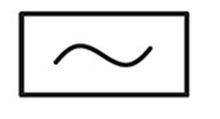

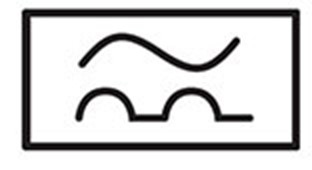

You have pointed out however the RBCO should have the
not the
to show it can work with a DC component. So must be a Type A or better, the normal Type AC is not good enough. Looking at Screwfix can't find a single RCD which is type A they are all type AC, thought the RCBO was type B but then realised this referred to MCB part of unit not RCD part of unit.
