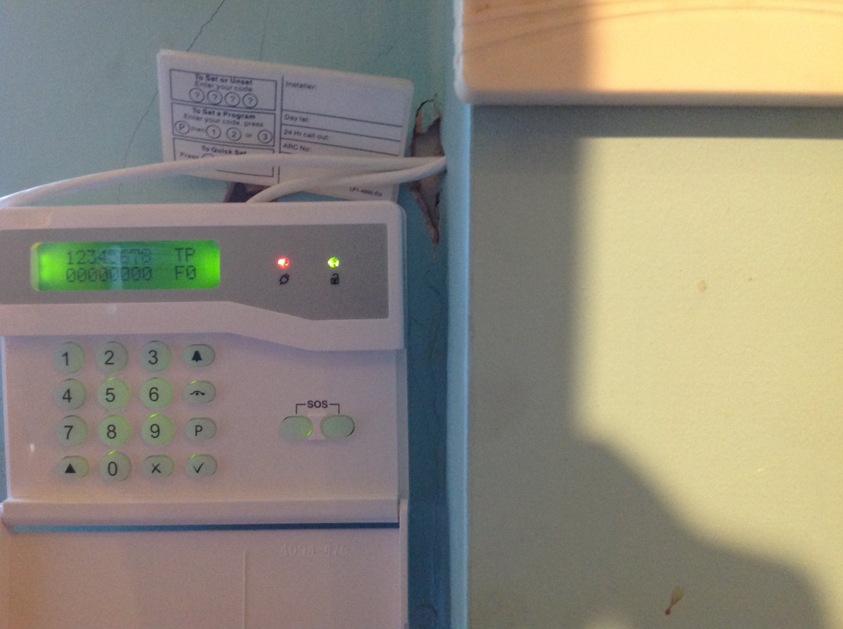

View attachment 117954 I have checked and I can't see where I have wired incorrectly.
I have taken a picture for the rkp
As soon as a pir senses anything in unset mode internal sounder alarm triggers
Any suggestions really appreciated

Could I ask how you cleared the tamper fault marked F0? I have the exact same fault on mine. I tried extending the spring on the RKP but that didn't help.
All zones are testing OK and the walk around but I can't clear the TP - F0 alert? Any tips?
Any help would be appreciated!
