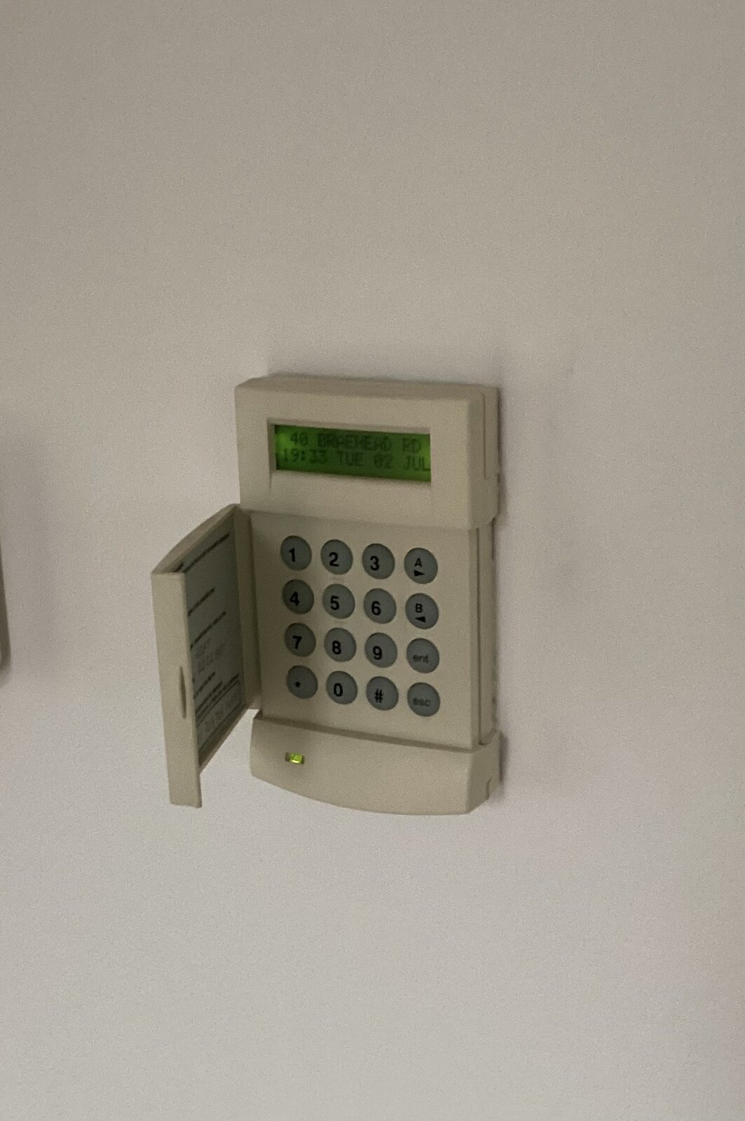

Hopefully someone can help. My house alarm recently activated either due to a fault or spurious alarm. By the time I got back home the alarm had stopped but the outside box was still flashing. I put in my pin to acknowledge the alarm and the system seemed to reset. When i went into one room the PIR sent an alert back to the alarm key pad panel causing it to beep. I cant seem to stop this so have just covered the PIR in the meantime. Im not sure if I need to key something into the panel to clear it or if it’s a fault with the PIR unit. The PIR obviously still works as it picks up my presence when i walk into beam. Any help or ideas appreciated as im not an alarm expert. Cheers Tel
It is a Honeywell. Markings on label are CP038, Grade 3, class ll. A little vertical thing. Cheers
That’s just the keypad there will be a galaxy of some sort on the end of it ….sounds like you have put chime on the device ….at a guess…
I honestly don’t know how that happened. Only started after (false) alarm the other night. I’ll try and find out how to silence it. Thanks.
Code
Enter
Display will show “status unset” before going to a menu with “10 - setting”
Press enter
Press A until option 15 is displayed which will show chime
Press enter
Cycle through the chime zones until you find the relevant one eg 1014 then turn off chine
