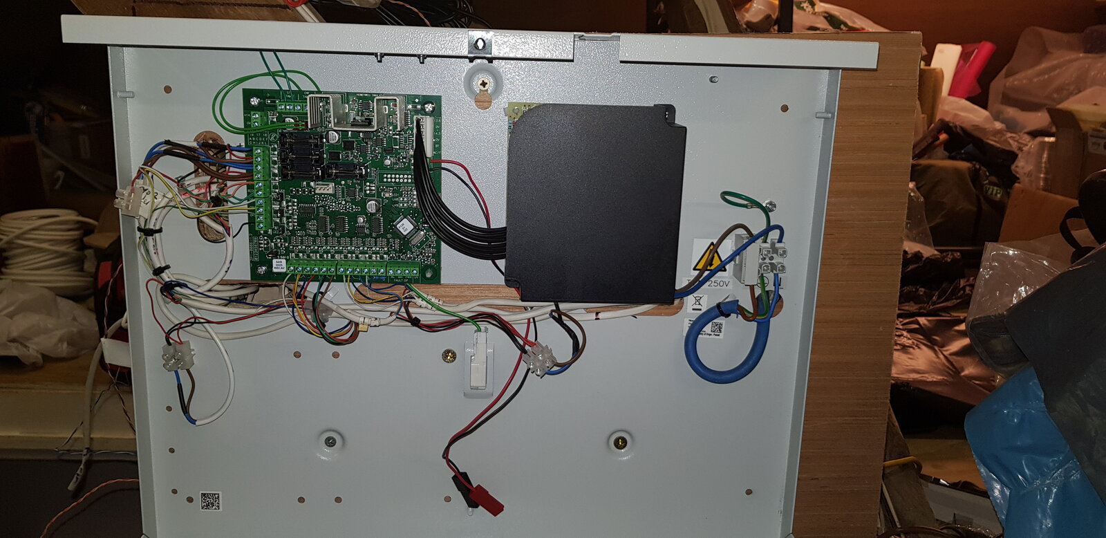

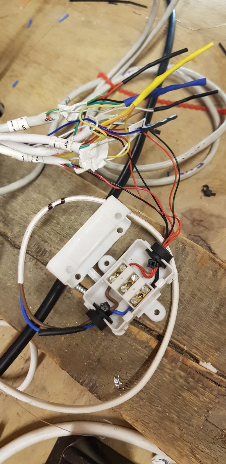

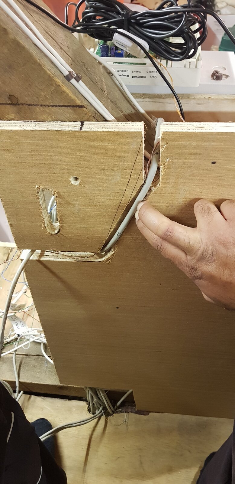

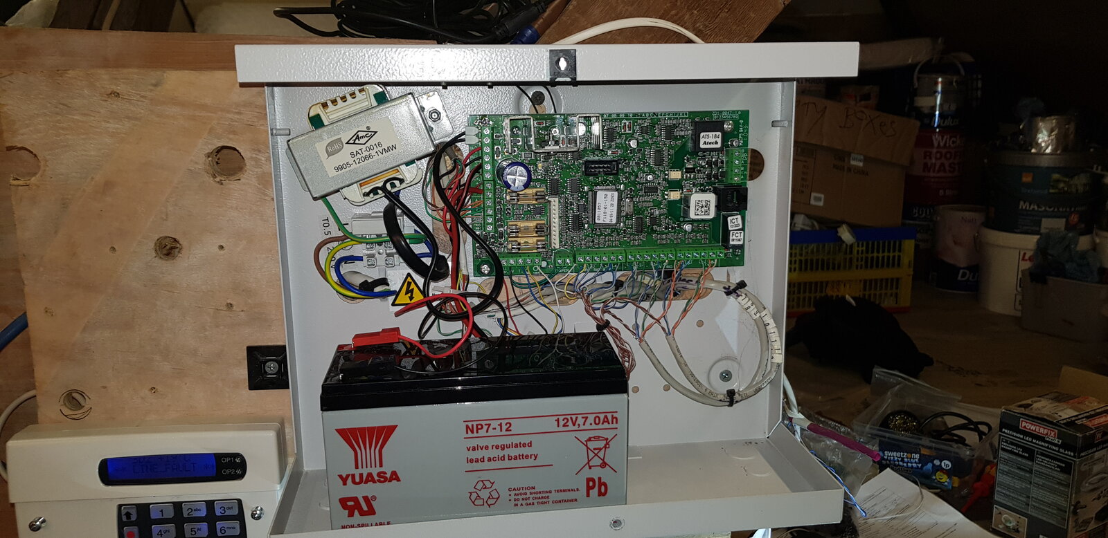

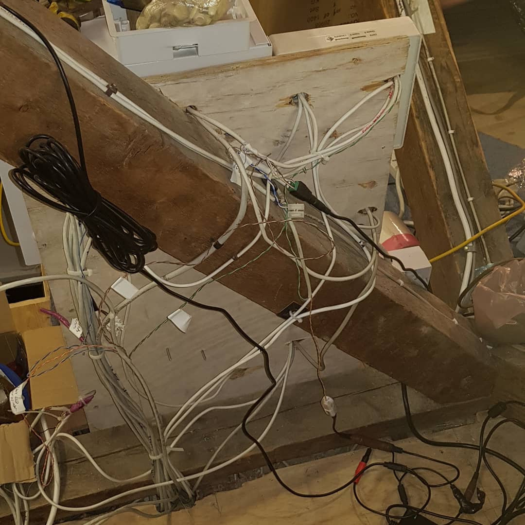

Ok i have finished the wiring as you can see in the picture. Everything works fine. But I am a bit confused why the it show nothing in the menu under RIO yet picks all the zones up and psu is fine as well. Also why is the voltage different from both boxes. G2-20 is 13.7v yet the powered RIO is 14.3v ? the grounds are connected together.

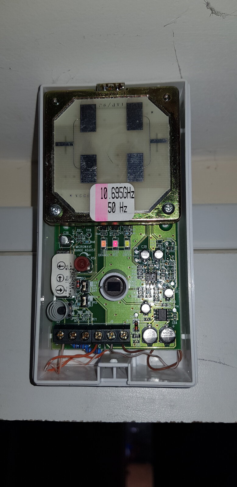

Also i have a Pir which i have shown n picture for a room which is only 2m by 4m and is too sensitive even in the lowest setting. Plus in the morning the sun comes through the window. Which pir would suit it ? As i got a few in the lost but this dual one is no good.
Let me know what you think of the wiring as it took me 2 days when i thought it will only take me 2 hours due to extending half the wires and also remove all them wires you saw in the pics to add this extra panel.
I was disappointed i could not add the 12v 12ah battery on the RIO box but i can in the G2-20 box.

Well that’s an equinox E DT , I’ve got hundreds out in the field ....it doesn’t help that the microwave is on max looking at that picture
It was on max because the min level was so sensitive and thought they got it wrong lol. But on max the level is the same as the min level.
btw the sensor is new and i got more of the them in the lost just. Just wondering its to sensitive as the room is to small maybe
